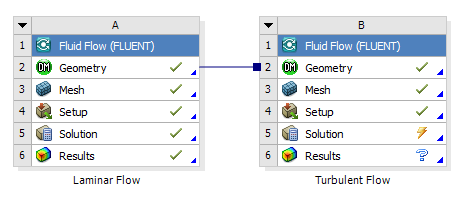

Right click on Mesh . Then click on Duplicate, which will duplicate the mesh from the previous tutorial. Enter "Turbulent Flow" in the highlighted field to rename it. At this point your project schematic window should appear as below:

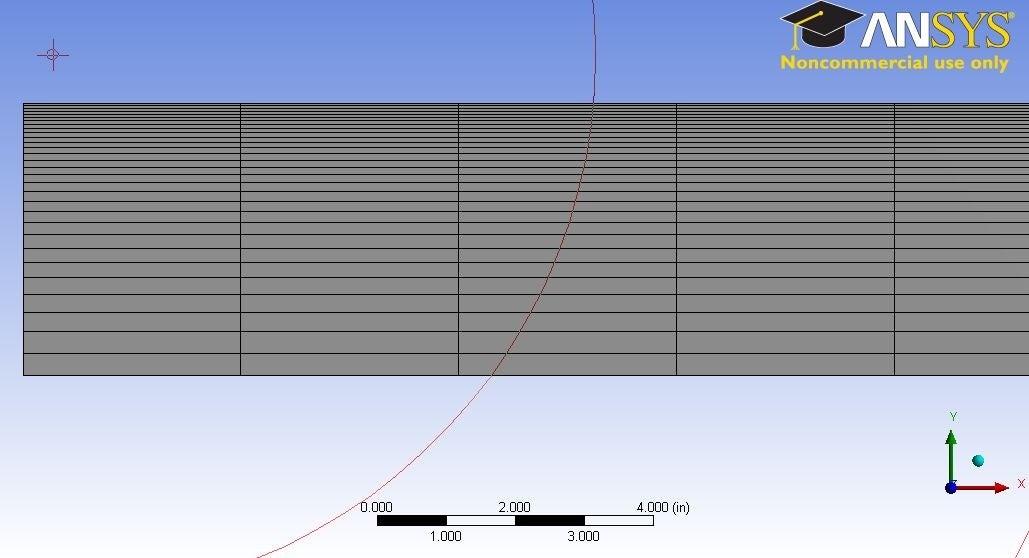

Right click on Mesh and select "Generate Mesh." The bias factor generates a finer mesh near the pipe wall. This is done to compute the small fluctuation in fluid property near the wall.

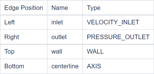

The Workbench file already now has the following boundary types created.
