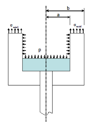

Consider the following pressurized, thick-walled hydraulic cylinder. The following figure shows a section through the mid-plane.
Stress directions in cylindrical coordinates:
σhoop is in the circumferential direction (out of the plane here)
a = inner radius = 1.5 in
b = outer radius = 2 in
Assume the cylinders are 18 inches long and the vessel is pressurized to 1000 psi. Here, we will be interested in finding the hoop, axial, and radial stresses at the mid-length of the cylinders (@ 9 inches), ignoring the local effects of the end caps.
Compare the finite element results obtained from axisymmetric analysis to those calculated with the theoretical formulae for both thin-wall and thick-wall approximations.
