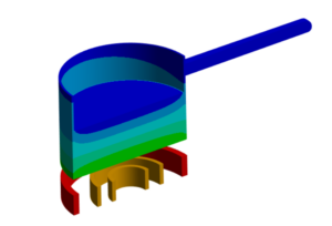

The three modes of heat transfer are conduction, convection and radiation. Here, we provide a simulation example to demonstrate the different modes. A steady-state thermal analysis is performed for the steel pot with hot liquid in it. Follow the steps to learn how the three heat transfer modes are defined in the simulation. Download the zip file and extract the contents. Go through the Readme file. Follow along with the provided How To Video file.
