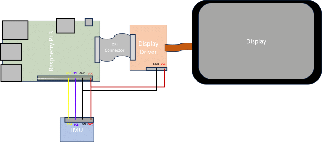

Schematic Diagram
Figure A. Schematic diagram for the Raspberry Pi with the IMU and display screen

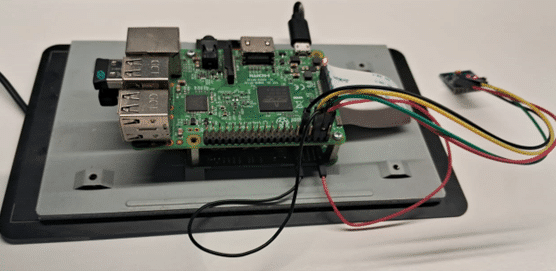

Connection Diagram
Figure B. Connection diagram of the Raspberry Pi, IMU, and display screen assembly
