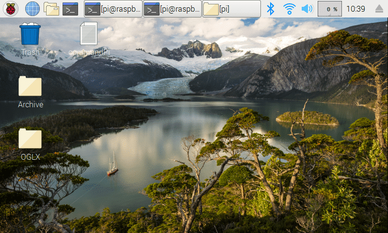

1. B. On Raspberry Pi
  1. Open the desktop to confirm the OGLX folder.
 width=Figure 1b: Location of copied OGLX file on Raspberry Pi

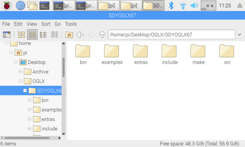

  1. Ensure it has the following folder structure:
 width=Figure 1c: Folder structure of the SDYOGLX67 folder on Raspberry Pi

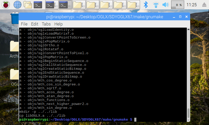

  1. Run the make file to create a libOGLX.a file created in a new lib folder on the Raspberry Pi. Use the following command:
    • make all
This command takes some time to run, and you will see something like the following in the command window after it is completed.
 width=Figure 1d: Successful creation of the libOGLX.a file

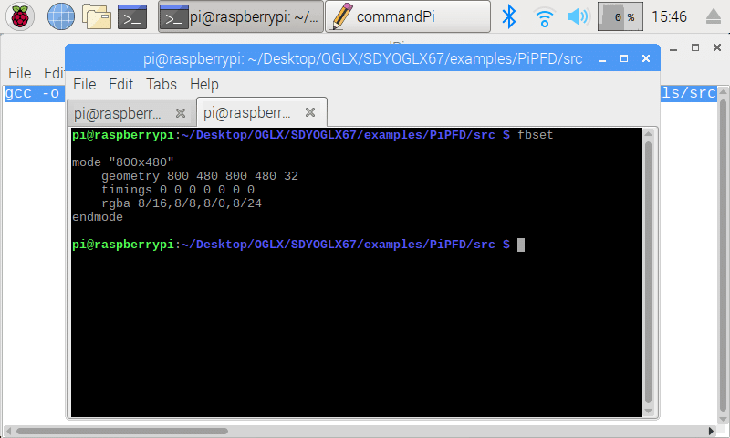

  2. Understand the display resolution for the Raspberry Pi using the following command:
    • fbset
 width=Figure 1e: Snapshot of the screen resolution details connected to Raspberry Pi
Note the resolution. For this hardware, it is 800 x 480.
