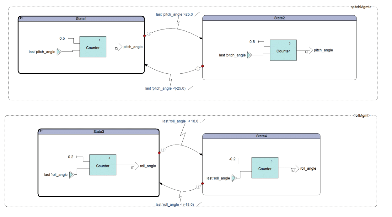

  1. Create a SCADE Suite model (for example, FCS_Pi) with two outputs pitch_angle and roll_angle. This model does not have any inputs. You can find the model in the SS folder under Lesson 3.
  2. Create a counter to increment the value of pitch_angle and roll_angle.
Figure 3b: SCADE Suite Model for creating a counter to change the value of pitch and roll

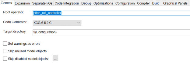

  1. Select "KCG" under settings and click on the Settings button.
  2. Set Root Operator (for example, pitch_roll_counter).
Figure 3d: General configuration settings for pitch_roll_controller

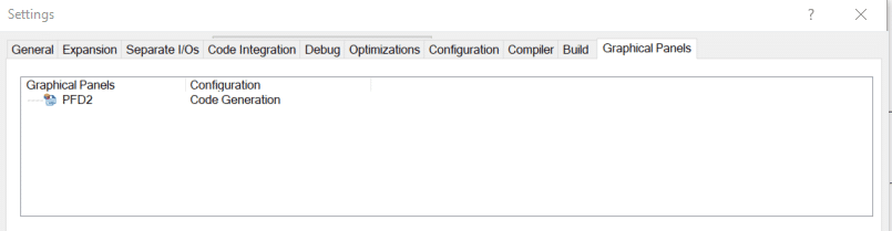

  1. Under the Graphics panels, select PF2 configuration as Code Generation (press F2 to enable the change).
Figure 3f: Graphic panels configuration Settings for PFD2

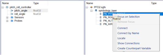

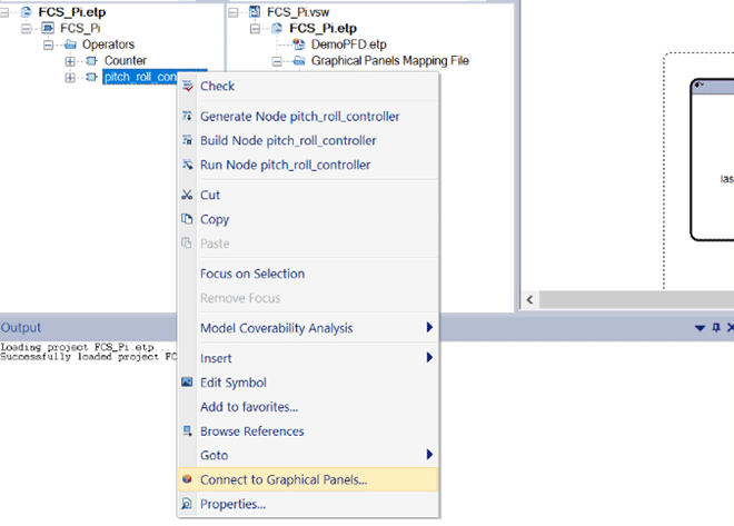

  1. Under SCADE View, right-click on the pitch_roll_controller operator and select "Connect to Graphical Panels."
Figure 3g: Snapshot of selecting the option "Connect to Graphical Panels" for pitch_roll_controller

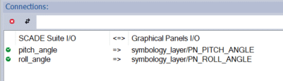

  1. Connect pitch_angle to PN_PITCH_ANGLE and roll­_angle to PN_ROLL_ANGLE in the Graphical Panels.
Figure 3h: Connecting SCADE Suite components to SCADE Display components
  1. Connections will look like the following:
Figure 3i: SCADE Suite components connected to SCADE Display components

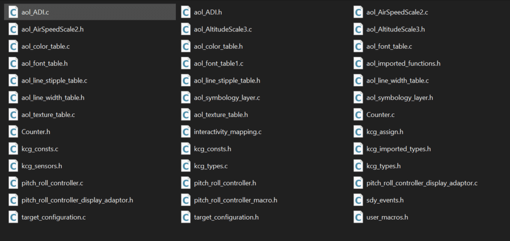

3.C. Prepare Files on the Host to Copy
  1. Copy all the .c and .h files from the generated SCADE Display and SCADE Suite projects into the code folder.
  2. Copy the kcg_assign.h file from the install folder location into the code folder.
Figure 3j: Folder structure of the .h and .c files copied into the code folder

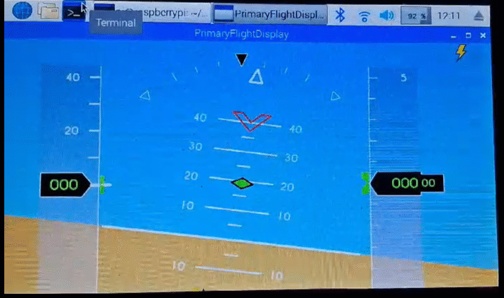

  1. Execute the following command in the Raspberry Pi command Window:
    • gcc -o out main.c specific.c ../code/*.c ../../../extras/utils/src/*.c
      ../../../lib/libOGLX.a -I../code/ -I../src/ -I../../../include/
      -I../../../extras/opengl/ -I../../../extras/utils/include
      -DCOEXECUTION -L/usr/lib -lX11 -lGL -lglut -lm
The only option that changes here from step in Lesson 2 is that we have a -DCOEXECUTION flag.
  1. Run the out file using the command ./out. You will observe the executable runs in co-execution mode as follows:
