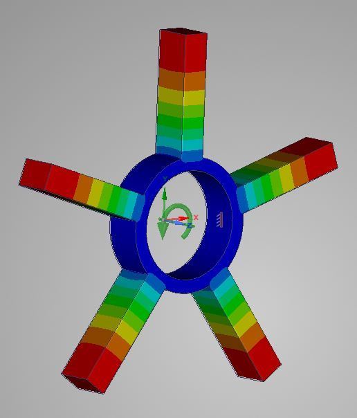

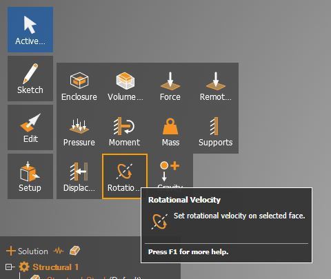

      We can apply centrifugal force using "Rotational Velocity" from the setup of a structural simulation.
      The inputs required are magnitude of angular velocity and the direction. This can easily be defined by specifying components of angular velocity and the origin about which it would be applicable.
      As mass is already known through density of material, defining rotational velocity completes the inputs required to compute centrifugal force.
      I am attaching a sample model for your reference.
