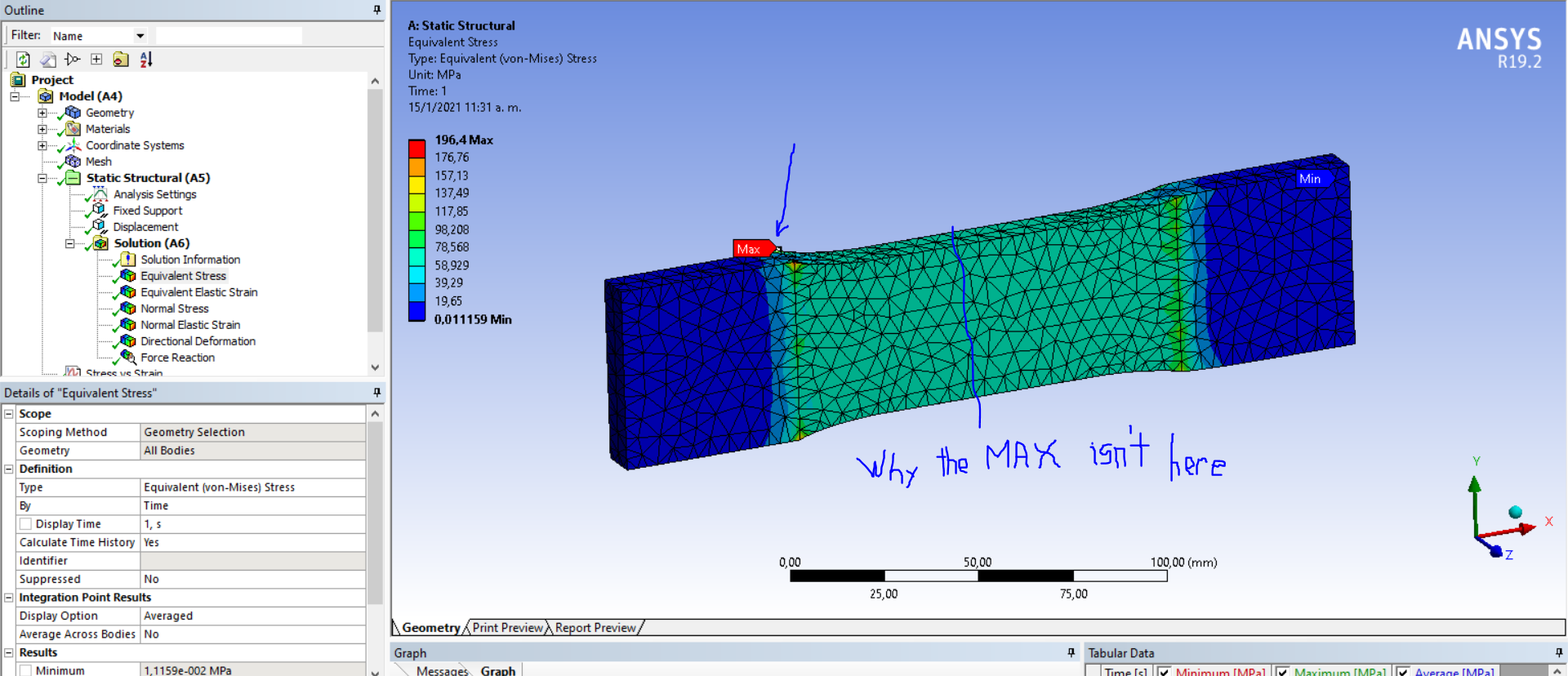

SubscriberHello, I am a mechanical engineer student. The subject of my research is to study the mechanical response of tensile probes with different infill patterns (Hexagonal honeycomb, Triangular honeycomb, Square honeycomb) and then compare the results of the simulations to define the better option for an optimal strength/weight ratio for a 3D printed part.
All specimens will be subjected to a Tensile stress test in Ansys WB using Static Structural, where I defined the same material and boundary conditions. The material is PLA. I leave images to illustrate the boundary conditions used in the simulation for the case of the probe with Hexagonal Honeycomb. The specimen's right end has a displacement of 2 [mm/min], as seen (I used tabular data to apply 2 [mm] displacement divided into 60 steps).
I would like to ask you if these are the correct boundary conditions. Because I had incorrect results with other conditions, and these seem to give acceptable results. For some reason I cannot explain when I was doing a mesh convergence study (reducing the size of my mesh elements), the values of the Stress never converged. For these conditions I used on my model, I did not experience this problem. If someone could explain to me why I had this problem, I would be very grateful. The boundary conditions that gave me such a problem where using Fixed support for the left end and a prescribed displacement or a load on the right end.

nIn the subsequent images where I show the results obtained, I obtain a stress concentration right on the line that separates my fixed constraint from the center of the part, where the smaller section should experience the maximum stress. Also, I get absurdly high values for a 2 [mm] displacement in a PLA (a relatively flexible plastic) specimen.n

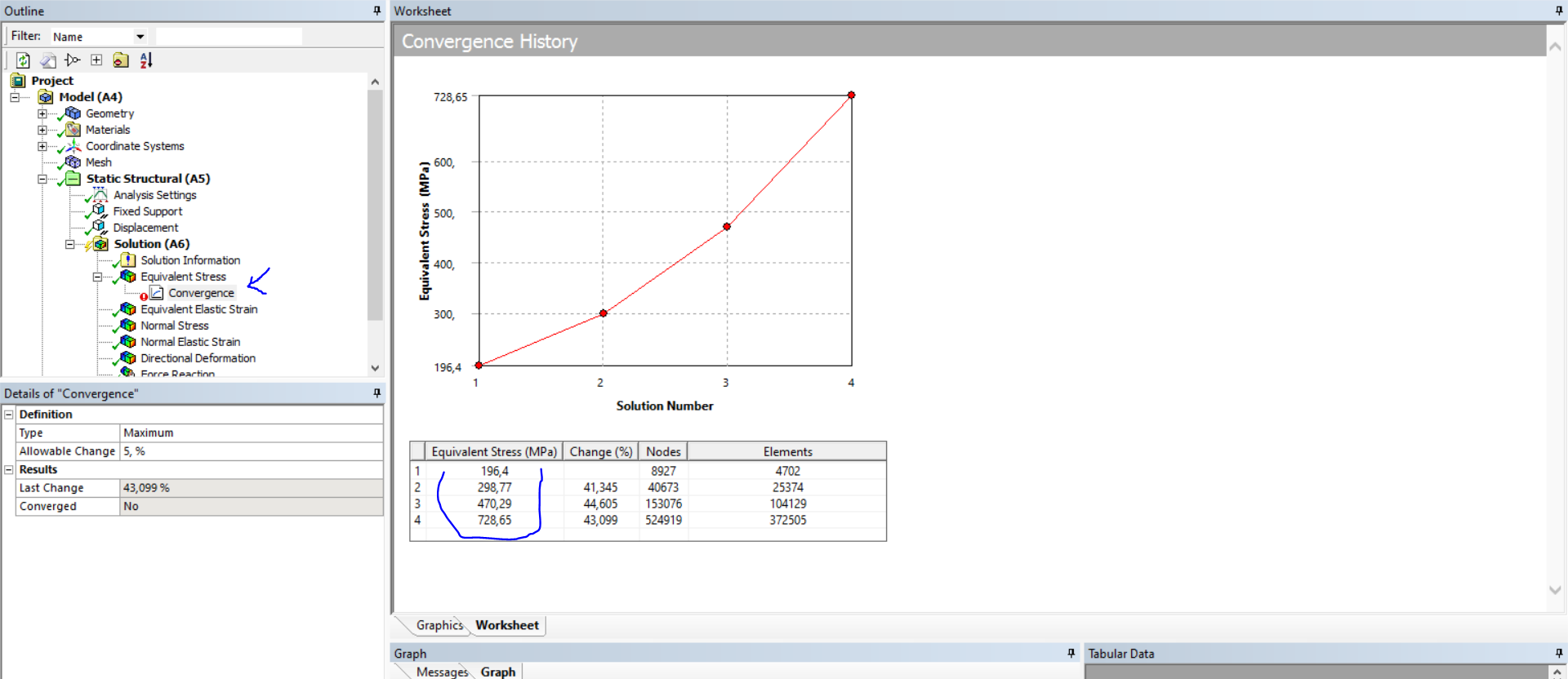

nFurthermore, I did a study of mesh convergence (reducing the size of the mesh elements) and the Equivalent stress values varied a lot in each step. The last image proves it.n
Could you explain to me why I have these results? Thank you very much in advance.

Forum ModeratorAre you using nonlinear material properties? Also, I think what you are seeing at the edge is a singularity, so it will go on increasing as you refine the mesh.nWhat you can do (If your model is symmetric) is slice the model by planes parallel to XY and YZ plane. And apply 2 symmetry conditions and pull one end by half the displacement. This will be equivalent to pulling opposite ends by actual displacement in the full model.n-AniketnHow to access Ansys help linksnGuidelines for Posting on Ansys Learning ForumnJanuary 16, 2021 at 8:52 amJose1702

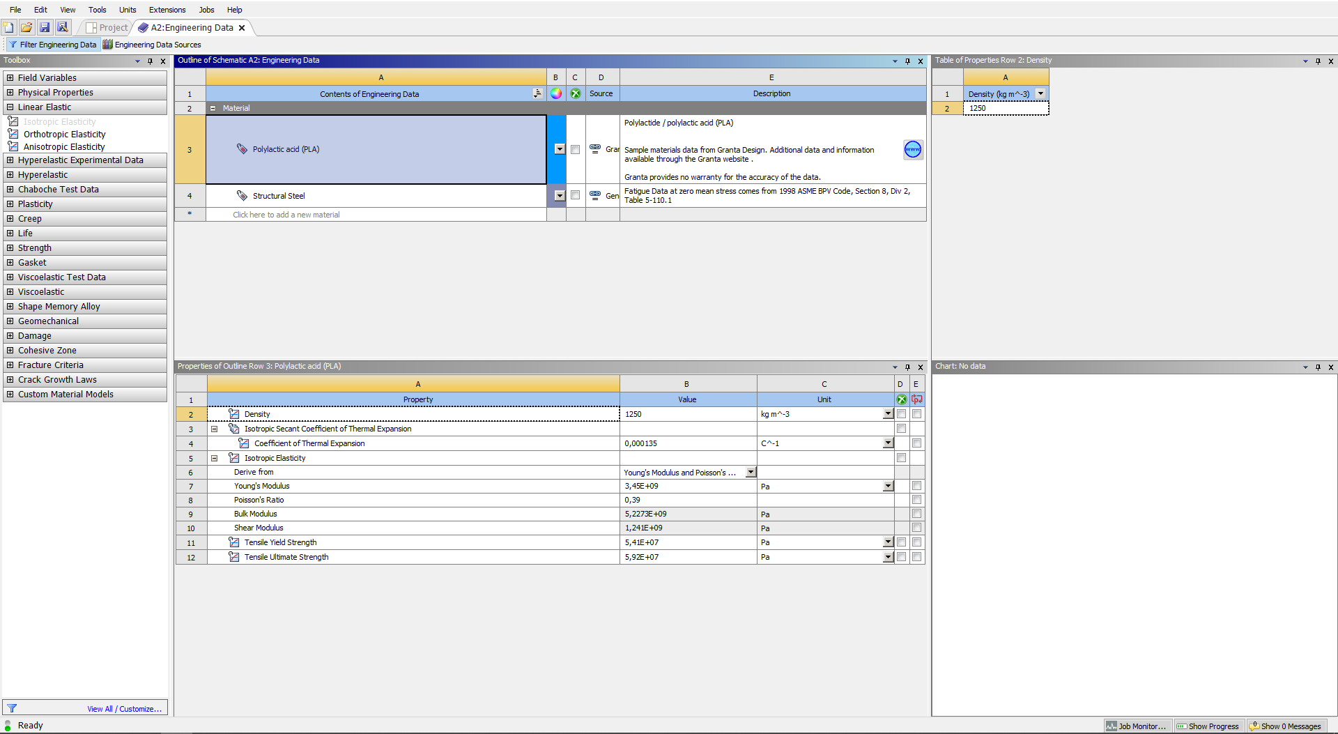

SubscriberHi, I'm not using nonlinear material properties, I'm using Polylactic Acid (PLA) from the Ansys WB material library. n
nI was supposed to study only the elastic range. But the displacement I'm applying even though is small (2[mm]) produces very high Stress values. These values are higher than the Tensile Yield Strenght (54,1 [MPa]). This means I'm not longer on the elastic range and that's why I'm getting this singularity??nWhy I'm getting a singularity?? Are the boundary conditions incorrect??nI'll try to slice the part since indeed is symmetric. Thank you for your help n

Forum ModeratorGenerally, you will see singularities at sharp edges, Google Singularities FEA and check first few links for some more info!n-AniketnHow to access Ansys help linksnGuidelines for Posting on Ansys Learning ForumnViewing 5 reply threads- The topic ‘What are the boundary conditions that I must apply to perform a stress test on my part?’ is closed to new replies.
