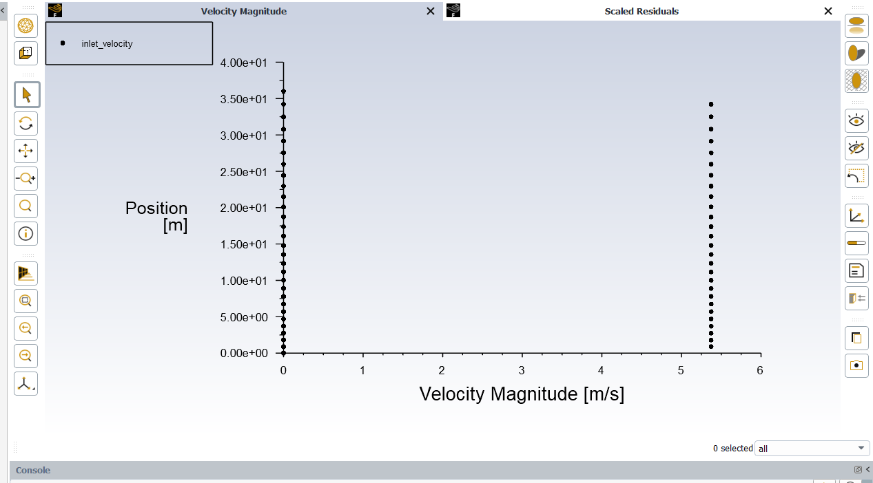

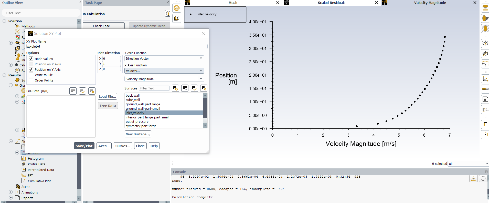

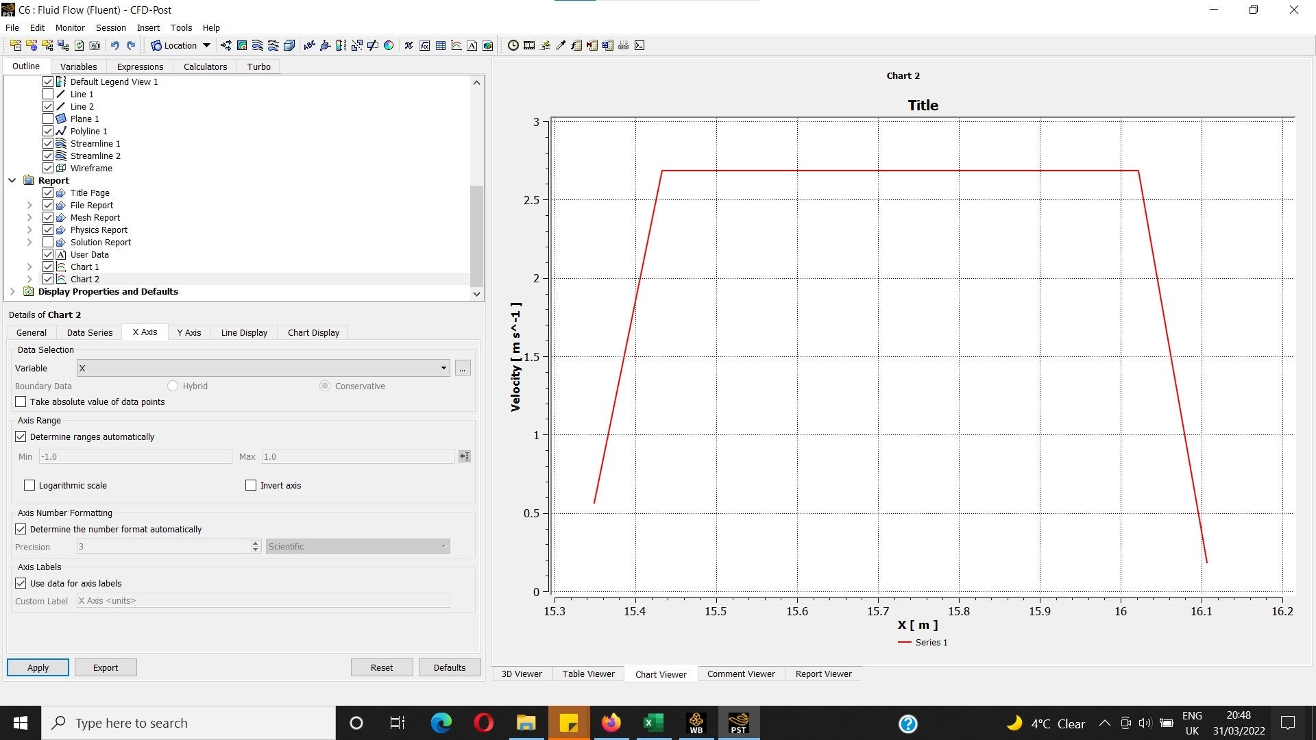

      I have been supplied with an inlet velocity profile. The profile is supposed to be fully developed at the inlet, however, when I enter the velocity profile in my simulation it doesn't consider it as fully developed. Am I supposed to write a UDF for the velocity profile to be fully developed? Thanks in advance.
      The first plot is what I get at the inlet

    • DrAmine
      Magnitude is not really you are looking for: verify in Fluent either as mentioned or by plotting the values at the Inlet using Profile Values. Something is definitely wrong.

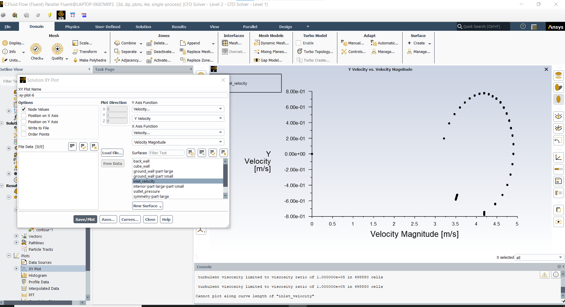

    • Ann
      Hey, that's what I am getting for the velocity at the inlet

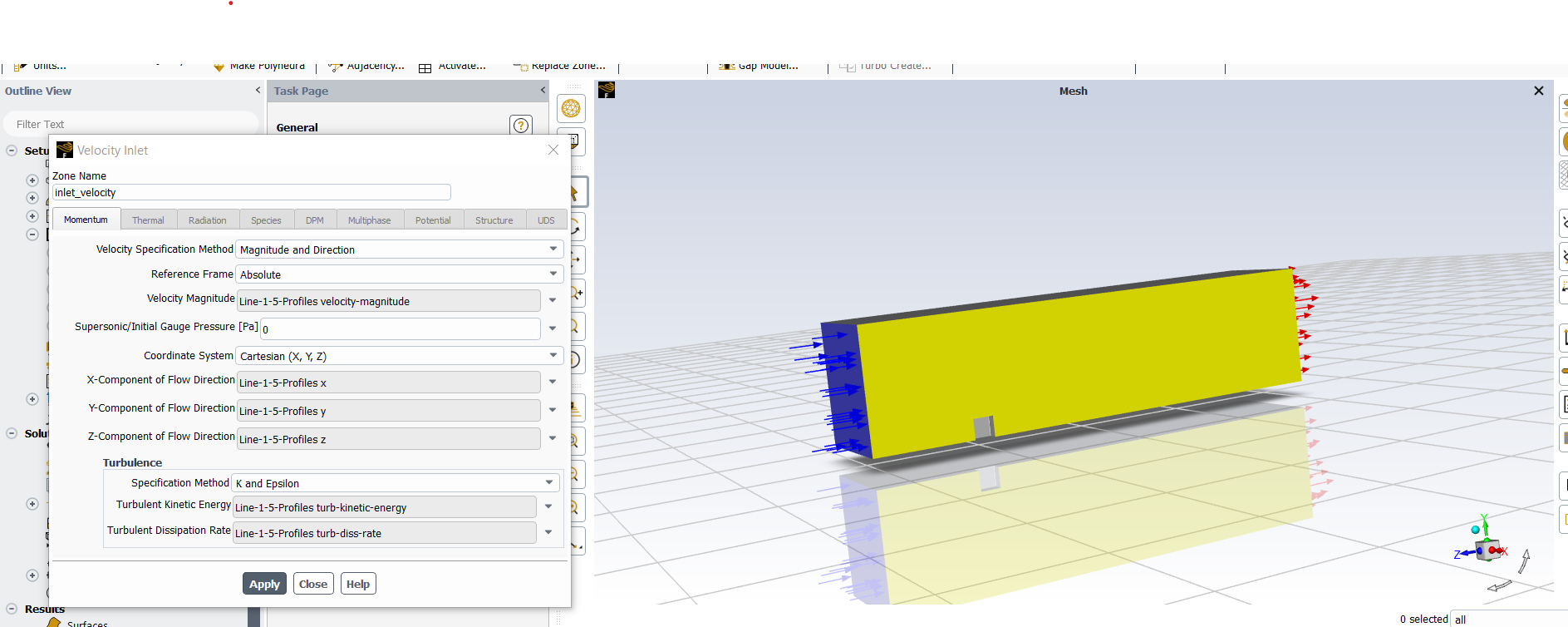

    • DrAmine
      Can you please add the screenshot of the inlet BC?
    • Ann
    • Ann
    • Ann
      H
    • Ann
      My inlet is velocity inlet
      Outlet: pressure
      The yellow side is symmetry
      the other walls are set to be walls.
      And I am trying to study the airflow around the cube
    • DrAmine
      Are the x,y,z really the direction vector of the velocity? I think that is wrong. You should set the direction to be normal.

    • DrAmine
      You change the velocity specification method to "Normal to Boundary".
    • Ann
      Yes, I have tried that before but unfortunately still getting the same results.

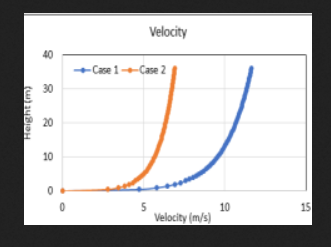

      Sorry to confuse you. So when I enter a velocity inlet profile with a fully developed flow (as shown in the first pic plotted using excel), I am supposed to achieve it at the inlet without writing any expression?
      Also the model that I took from the data in excel, should it be with the same dimensions as the model I am entering the data in?
      Yes, I have made sure that it is csv. I have been trying to achieve the correct results for one month now, but I am not achieving the right results.

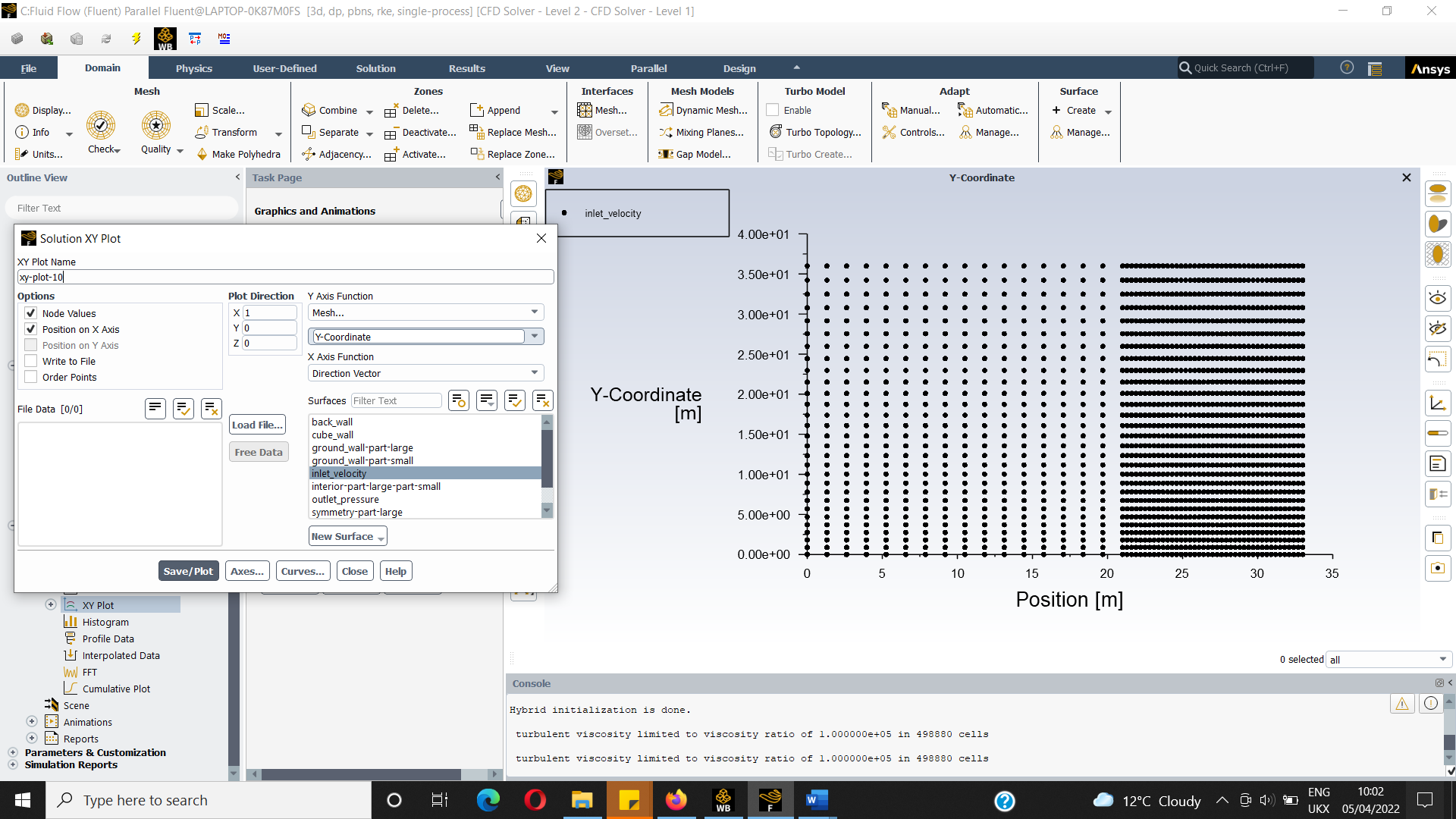

    • DrAmine
      Your height coordinate is which direction? It seems to be in Y-direction. Your Excel-Sheet used negative Y values: now check the Y-values at your inlet.
      One month on this issue is long time.

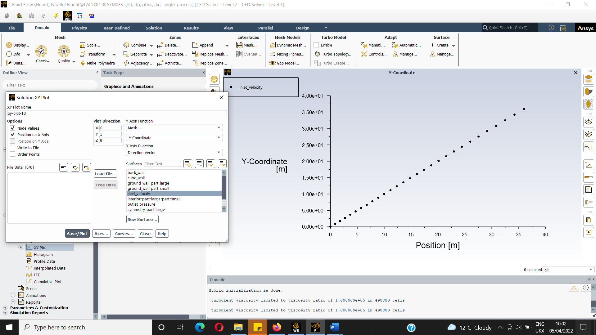

    • Ann
      Now I got the velocity plot, however, the contouring and velocity vectors got missed up with changing the Y.
    • DrAmine
      In the xy plot select Y for Y Axis.
    • Ann
      Does that what you mean?
    • DrAmine
      No.
    • DrAmine
      Y axis select mesh then Y coordinate
    • Ann
    • Ann
      Here is what I got

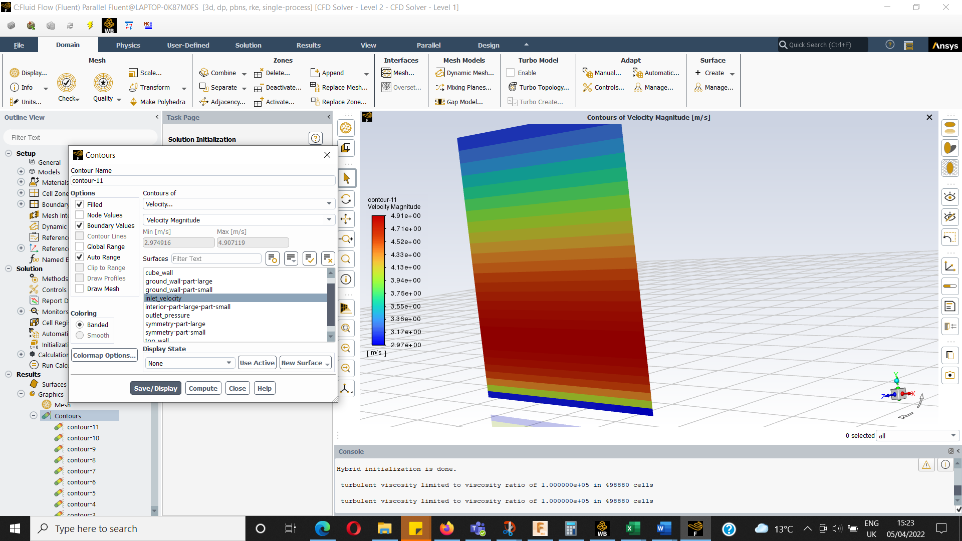

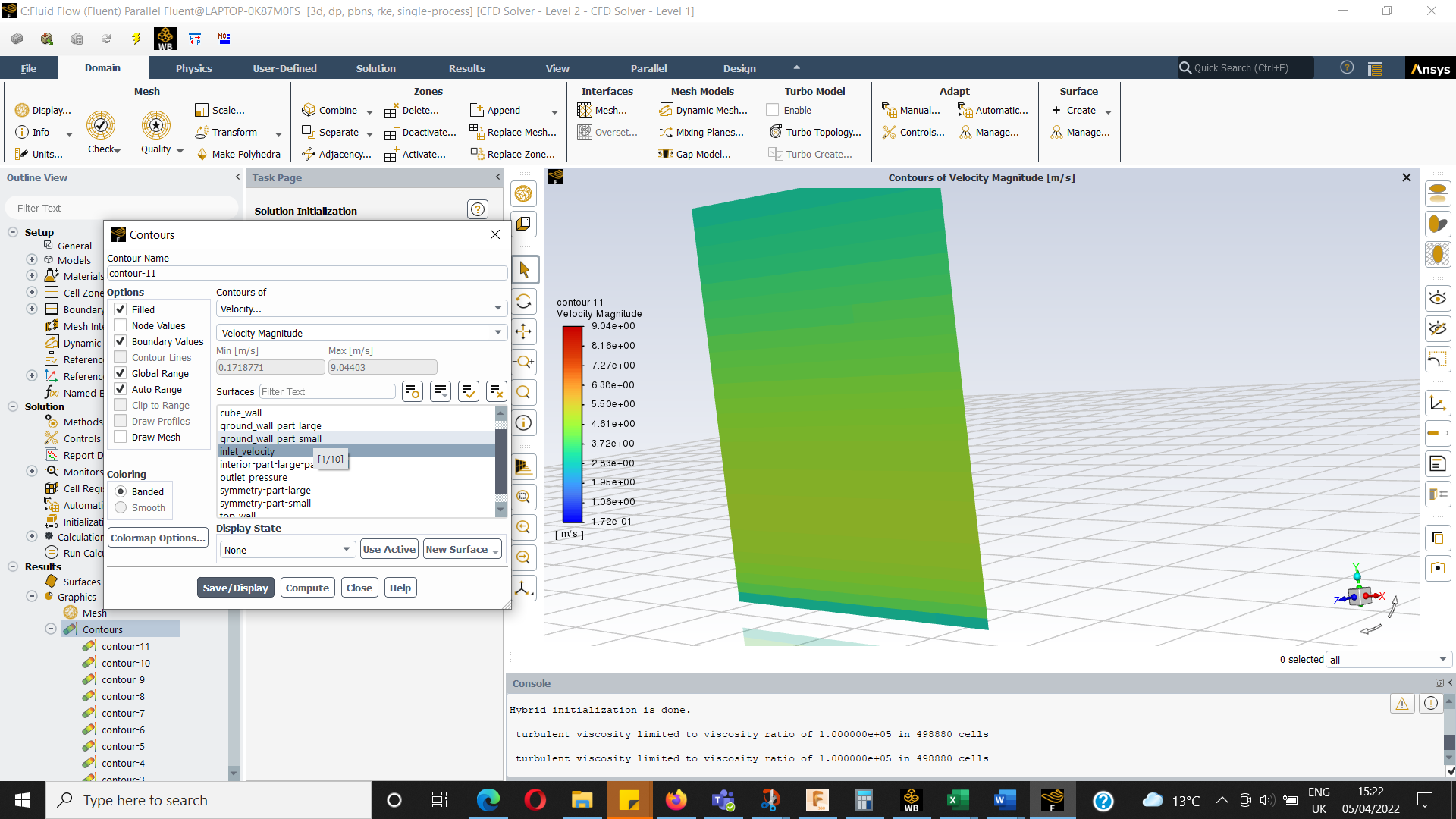

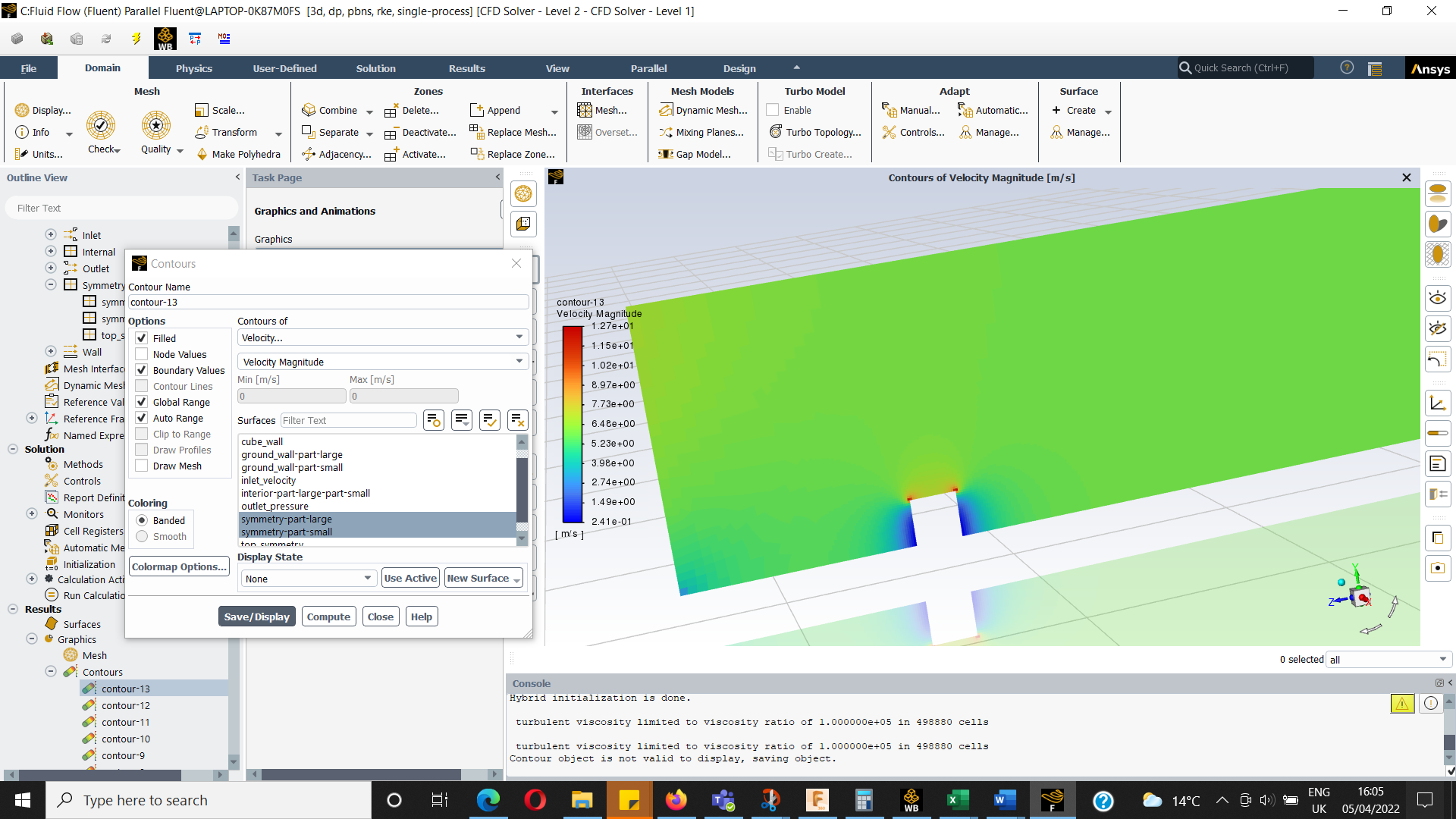

      Please show the velocity contour on the inlet, local range and node values off.
    • Ann
      Hey Rob I have attached a pic

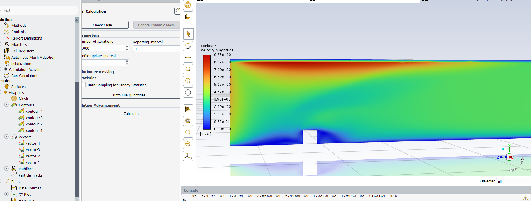

      You are going to see an acceleration over the blockage, and it's quite close to the inlet given the blockage factor. If you plot the last image of the previous page in the same way how does it look?
      The profile looks like what I'd expect in an environmental flow (atmospheric boundary layer), if so, what did you set the sky as?
    • Ann
      I have tried to set the top boundary to be wall and symmetry in both cases I am not getting the right results.
    • DrAmine
      I have a feeling the profile is wrong as it does match to negative y values which you do not have in your inlet. So correct your profile.
    • Ann
      Thank you so much . I finally managed to get the results right. I appreciate your help!
