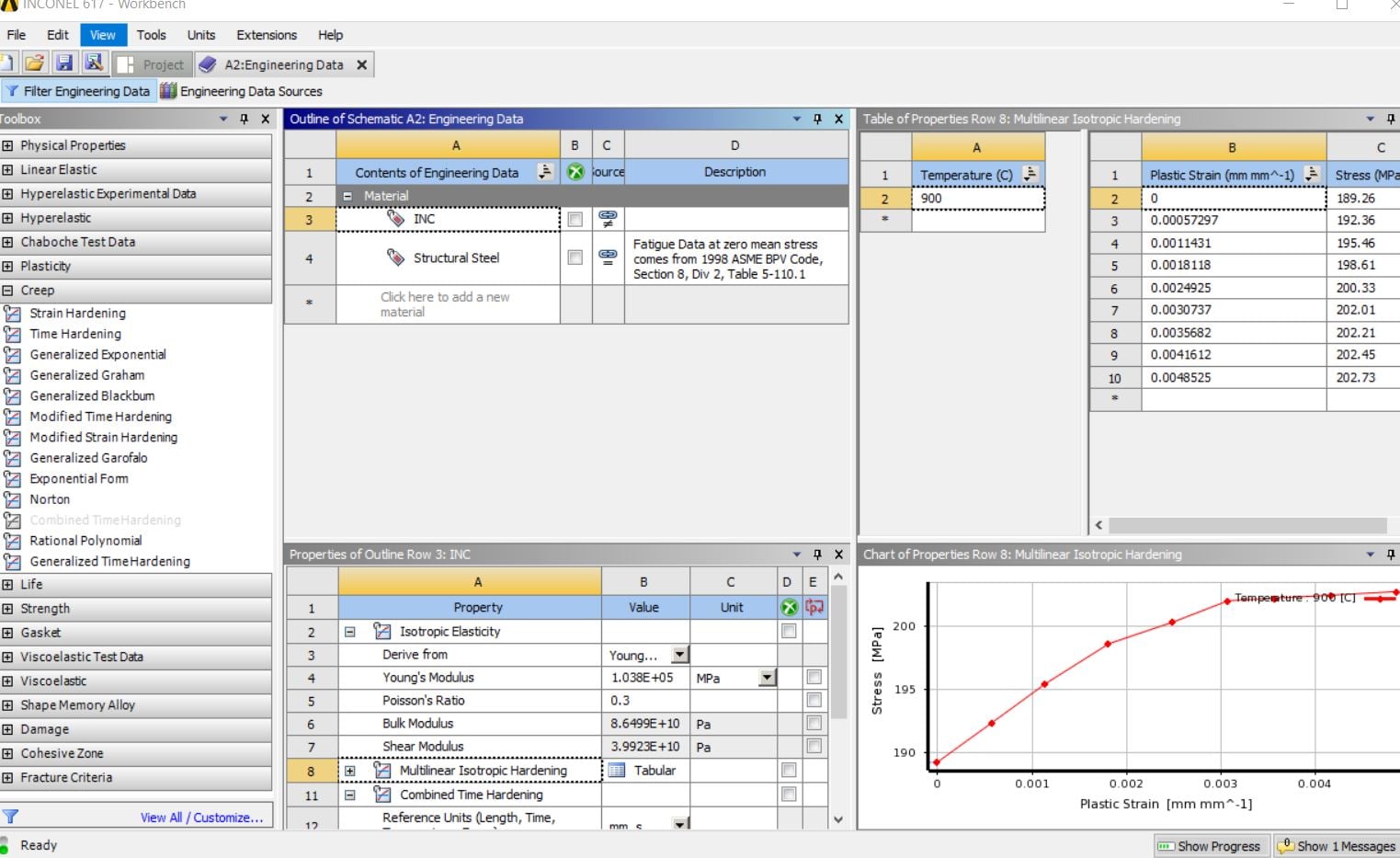

      i need to simulate a round bar for creep in which one end is fixed and other is applied by a tensile load. the problem is my simulation is not converging. i have tried changing substeps, applied fine mesh, rechecked creep constants and units still problem exists. please help me to sort out this problem.

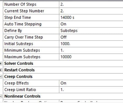

      Does it fail to converge at the beginning or does it start and fail to converge at the end?
      What happens if you set the Initial Substeps to 1000?

      sir , is negative creep constant can be a problem for convergence??
      I went to the ANSYS Help system, and found the equation for Norton so that I understood the creep model in another discussion.
      ANSYS Help > Home > Mechancial APDL > Material Reference > Nonlinear Material Properties > Rate Dependent Plasticity > Creep
      The Combined Time Hardening entry says only C1 > 0 and C5 > 0.
      Where did you obtain the creep constants?  What units of stress are required to use those constants?
      It seems your solution begins, so you have some results.
      Please reply with a snapshot of the graph of maximum displacement vs. time.

      Sir, i took the values for strain and time from strain vs time plot and transferred those values to APDL. Then using curve fitting in APDL i solved and got the values. My stress value is 18 Mpa and temperature is 900 degree celsius  for a time of 14000 hours

      Try setting Minimum Substeps to 1000 since the solution converges a few initial steps.
    • gopikrishna
      sir, still not converging. Any other solution??.

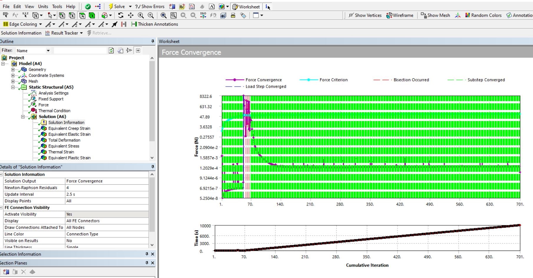

      What is the error description on the Solution Output?

      How did you get the Combined time hardening coefficients? Via APDL Material models? You have fixed C4=0, so I assume you don't have temperature dependant model.
      Try to fix C2=1, C4=0, C6=1 and C7=0 (fixed stress and no temperature dependancy) in the Curve fitting tool and try to run the simualtion again. The creep behaviur curve should be nearly the same (you can compare to the current one that you have). Put fixed values in the Coeff Value, Fix them and click Solve to get new values for the creep simulation.

      force convergence plot
    • lroblek
      Can you try a constant Creep strain model, such as Norton and put Auto Time Stepping to Program controlled.

      When a nonlinear static structural model fails to converge, that can be the expected outcome of the simulation. For example, if the material is Bilinear Isotopic Hardening, with 0 Tangent Modulus, it is perfectly plastic above the yield strength. If a force is the applied load, once the force is high enough to turn the entire section plastic, there is no static equilibrium above the force increment that just converged, every force above that will fail to converge. There is no mistake in the model, that is the natural end of the simulation for a problem where the ultimate load was unknown.
      Your model converges for many time steps, then stops converging. Look at the results. Plot the force vs time curve. What does it look like?

      Sir, what is the significance of creep limit ratio. what if i put creep limit ratio as zero, because if im assigning creep limit ratio as zero solution is converging!

      Plot the force vs time curve. I want to see that before I say anything more.
    • gopikrishna
      thank you Sir, problem is solved. Actually i had some problem with my constants, i was able to find the constants from another experimental data..
