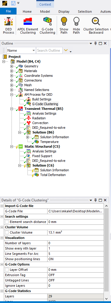

      Question 2: I am having trouble with element clusttering. How do I know that how much clustter volume do I need to set? I was trying different value and ANSYS grabs volume very randomly when I set to specific value. I mean Is there any way that I can create cluster in certain nodes from certain section?how can I do that? I already got the G-Code.

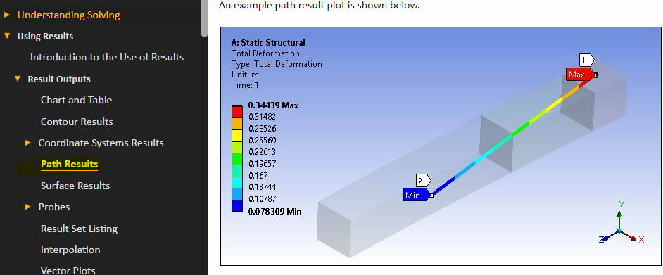

      question3: I want to get a nice graph that could show me the top to bottom temperature profile which I can compare with Experimental data. (simulation and Experimental comparison) how can create that line to obtain a graph?

      Q2.  Smaller cluster size should improve accuracy at the expense of run time.
      Q3. Not sure if this will give you what you are looking for, but could you use a path plot? You would have to create this after all the elements are activated at the end of the build.

      I was successfully able to create a path and got the data to compare with my experimental value.

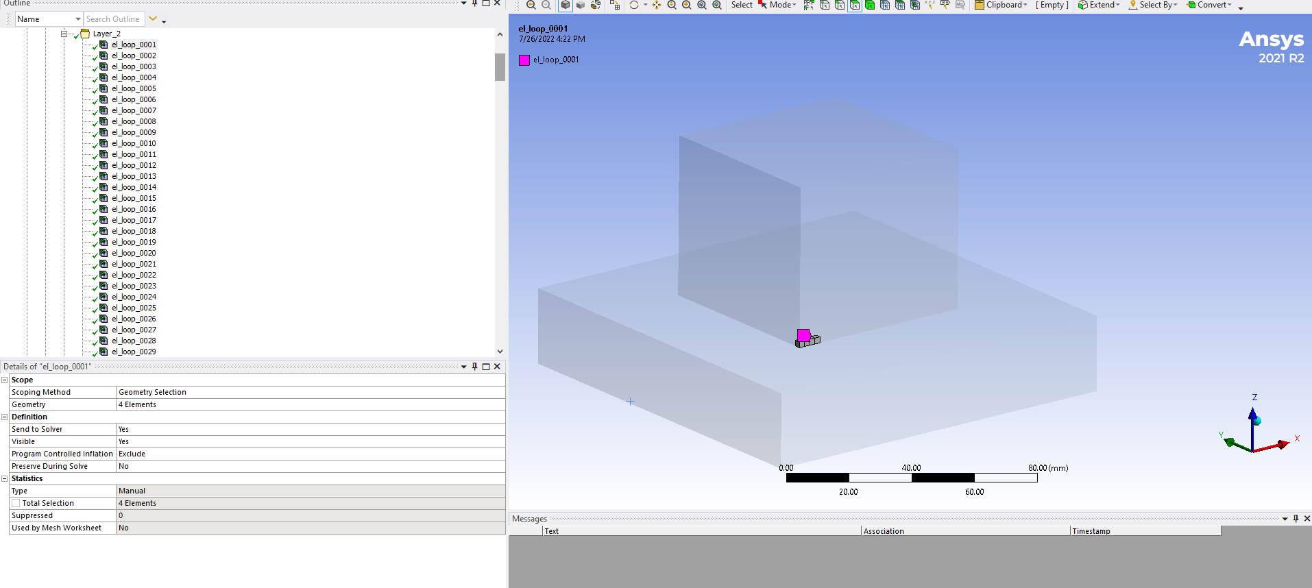

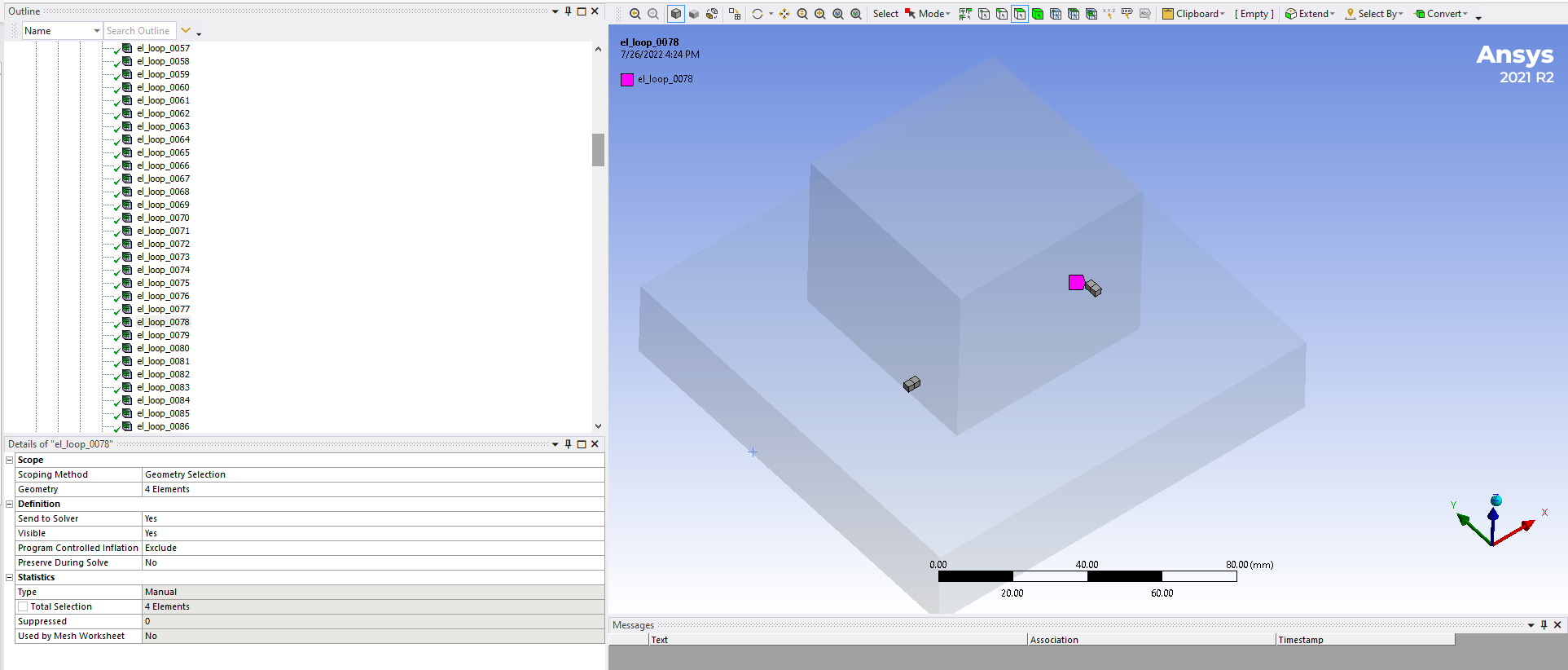

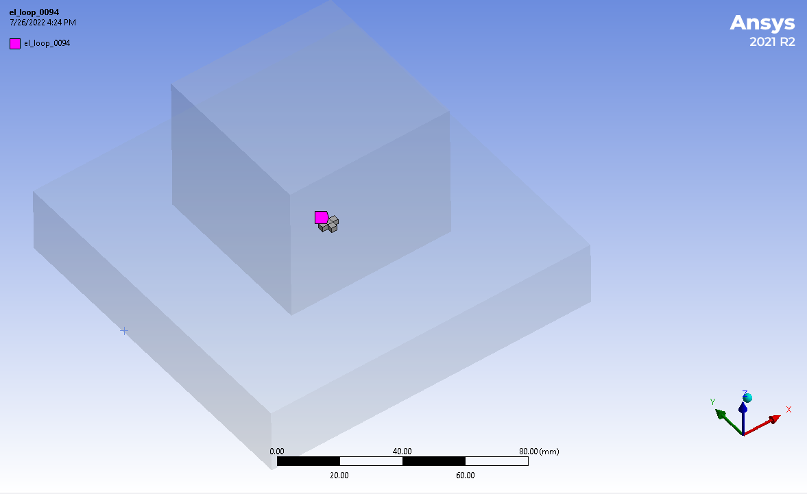

      But now the big problem is when I did the element clustering, I set it to the very small size and I see the tool path/printing path from my G-code. I noticed the very weird thing.
      1. I was planning to grab the cluster of cube of around 6-8 element and make it symmetric to all the layer. But  when I check the cluster volume by generating the G-code clustering, Its not even so symmetric even in the first layer. I wish I could share the video of my problem and may be that the good way to explain my problem. I double checkmy G_Code and all I am changing is the co-ordinate of the Z-axis( hight of z axis). It should be same cluster volume to every different layer through z-axis as I am not changing anything (co-ordinates) x and y on my Gcode. How can I make a symmetric cluster volume or symmetic path to every different layer.
      2. I have 28 layer but Element clusttering different in 1st layer and different in 28th layer. When I animate the result. It grabbing the element while printing simulation so randomly which doesnot even make sense. but the first layer seems okay. The Gcode of the first and 28th layer is 100% same in x and y co-ordinates all I am chaning is the z axix which is a height.

      4. I am taking some screen shot of the clusttering that I have been facing , Hopefully it will make easier to understand my problem.
      5. I have tried to do a screen caputre of the element clustering volume pathand upload to a dropbox i guess that  will help to understand. please focus on the last 15second on the video.
      6. here is the link: I have uploaded a link as an attachment as well;https://www.dropbox.com/s/cidsis0hq56rt4p/Gcode%20problem.mp4?dl=0

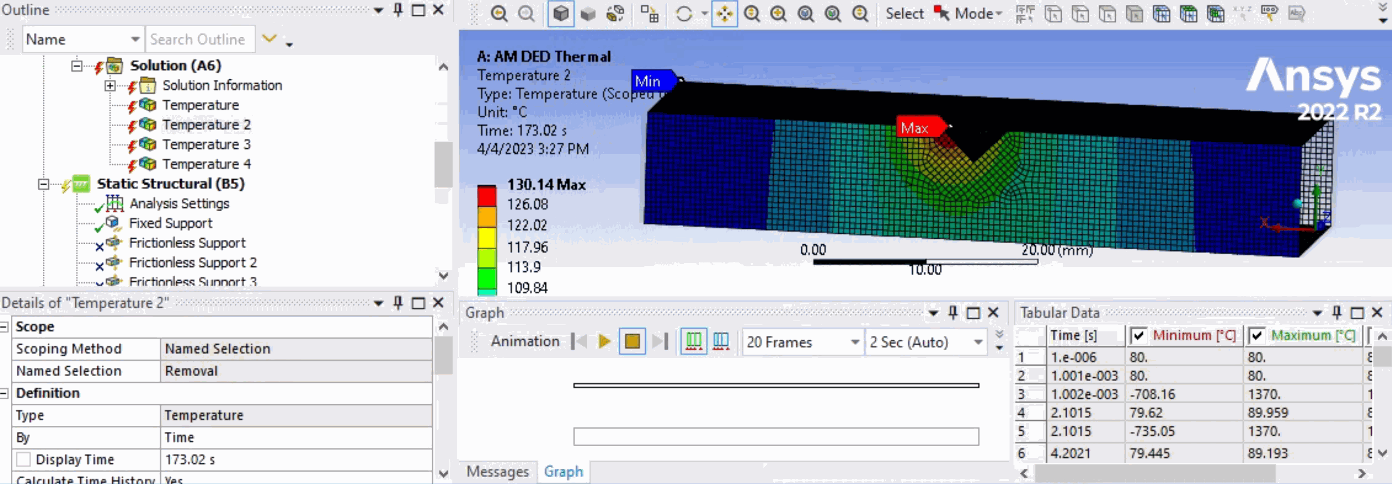

      I have been undergoing a simulation on Mechanical DED Wizard involving Directed Energy Deposition, I am trying to simulate the process and find the residual stresses. I have came to a problem regarding the temperature histories which directly impact the static structural results. The temperature fluctuations are far too high and i cannot seem to fix this, the process involves using the DED wizard with a print and base part using material Inconel 718. Any support would be appreciated.
