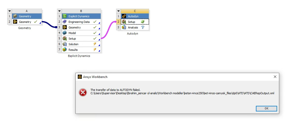

‘the transfer of data to autodyn failed.’ error when the transfer setup
    • İbrahim Sencar
      I am facing 'the transfer of data to autodyn failed.' error when I transfed explicit dynamic setup files to AUTODYN. What can I do could you help me.
    • George Karnos
      One recommendation would be to remove the special characters in the path seen in the error.
      There are multiple "+" in the path

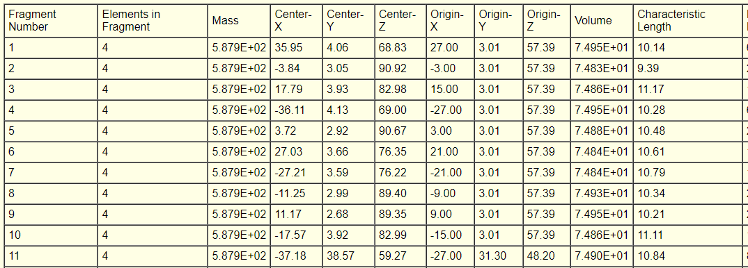

      Can anyone help me to get pressure-time graph or pressure-distance graph in autodyn, I've performed simulation in which fragments moves away. i want to know the distance travelled by the fragments and internal energy of the fragments. And what does characteristic length means in below image?
    • George Karnos
      Syed,
      Please create a new post for this.
      Thank You,
      George
