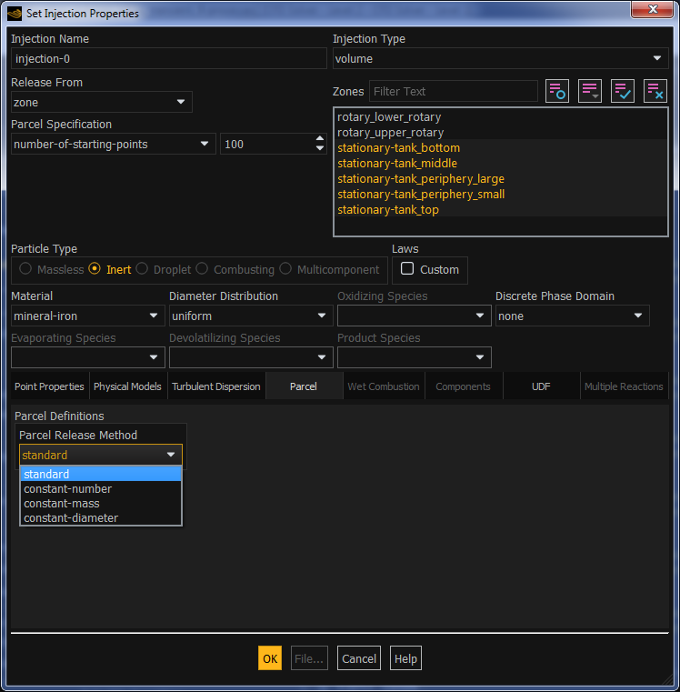

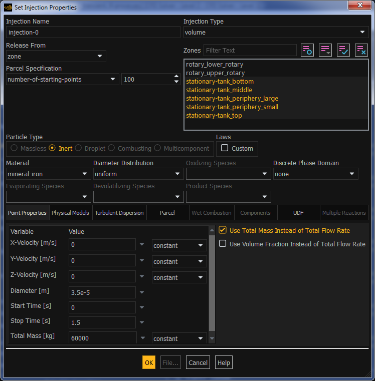

      DrAmine, I am talking about Models > Discrete Phase > Injections. Once you define an injection, inside the injection window there is this short drop-down list titled "Discrete Phase Model".
      In the Image below, none is always there; powder is the name of the discrete phase I have already defined as an Eulerian model.
      Rob, I have no doubt that I should be using DDPM as my volume fraction is 20%; So I wouldn't double check my general setup for the simulation.

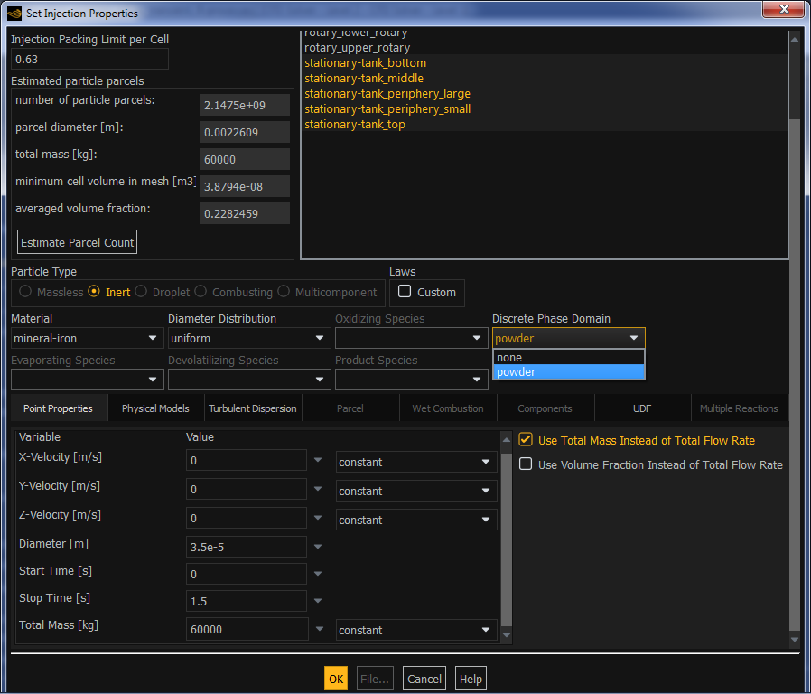

      My problem is:
      Setting the "Discrete Phase Domain" to "powder" (i.e. the name of my discrete phase) instead of "none", results in Fluent crashing sometimes or otherwise, very slow iterations Why? Because, as User/theory Guide says, choosing discrete phase domain other than none (i.e. powder in my case), fits five parcels into the smallest cell in the mesh. creating very high overall number of parcels, (2e+9 in my case).
      So why do I not choosenone? Because it does not inject particles with volume!! It only keeps their mass in calculations. This is not suitable either, because I am using DDPM (20% volume fraction), thus neglecting the volume of my discrete phase is underestimating their effect.
      If my English is not too rusty yet, I guess my problem is clear. I can not inject effectively! :|

      If you relating the volume injection to a DDPM phase the parcel method choice should become inactive and does not support any user change. The method is set to constant. The diameter will be calculated by Fluent. Fluent will inject certain number of parcels trying to fulfil the requested mass or volume fraction without going over the packing limit in each cell. It will pick up the minimum cell volume in the region you select and based on that volume it will allow for 5 parcels.
    • sardar.svn
      Thanks DrAmine.
      Just a tiny correction: the injection will set diameters based on the smallest cell in the whole domain, and not in the (sub-)domains you have selected for volume injection.
