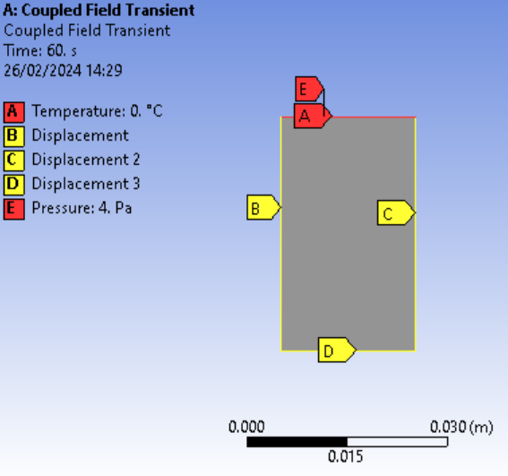

I am doing 1d thermoelastic analysis using WB coupled field transient analysis. The geometry is a 0.035m bar fixed at the bottom boundary. The bar is under 4Pa mechanical loading and zero temperature on top boundary. The initial temperature is zero in the domain.
 I used the following properties:
linear thermal expansion=0.0551 1/C
specific heat= 1000 J/(Kg C)
heat conductivity=2.69e-7 W/(mC)
density=1000 kg/m^3
Elastic module=18.15 Pa
Poisson ratio=0
I would like to see a change of temperature due to mechanical loading. My expected result was that the applied pressure should increase temperature to 4 degrees initially, which will cool down over the time. However I see that the temperature did not change after simulation. Can you let me know how I can see the change of temperature due to loading here? I cannot find a way to change Toff = offset temperature in WB. Will this affect my simulation?

Ansys EmployeeYou can check the ds.dat (or output) to confirm that Toff has been set to 273 by default. If not, then you could input it with a commands object, TOFF,273. Could you share your hand calculation of the expected deltaT? A 4 degree temperature change seems like a lot for a 4 Pa pressure (even for a material with a very high coefficient of expansion and low modulus.) The temperature should change a small amount though.
