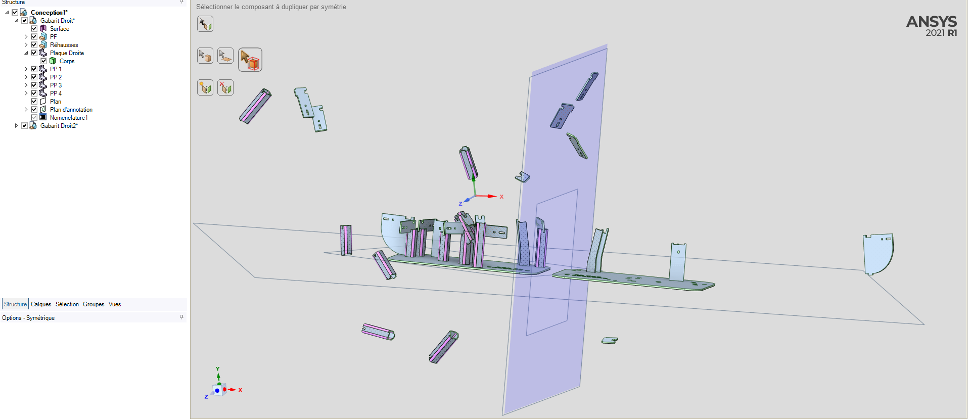

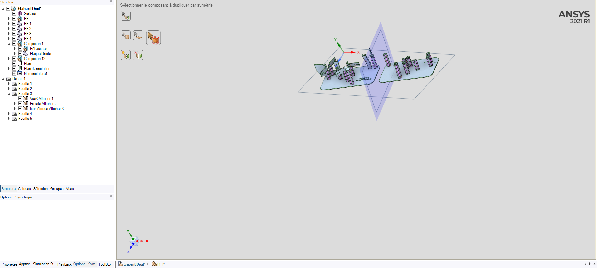

      I don't understand the behavior of the symmetry function in Spaceclaim:
      1/ When I try to do the symetry of a set via "assembly -> file", the set explodes!
      1bis/ The external set symmetry explodes!
      2/ when I make the symmetry of a component and I modify afterwards the volume the symmetry does not follow
      3/ If I make the symmetry of a body it works on the other hand it is not practical to make a BOM so if I create the component of this new body, I lose the link of symmetry...
      4/ You can't make a symmetry of a set composed of internal AND external elements
      Is this the expected behavior? Are there any plans to improve this function?

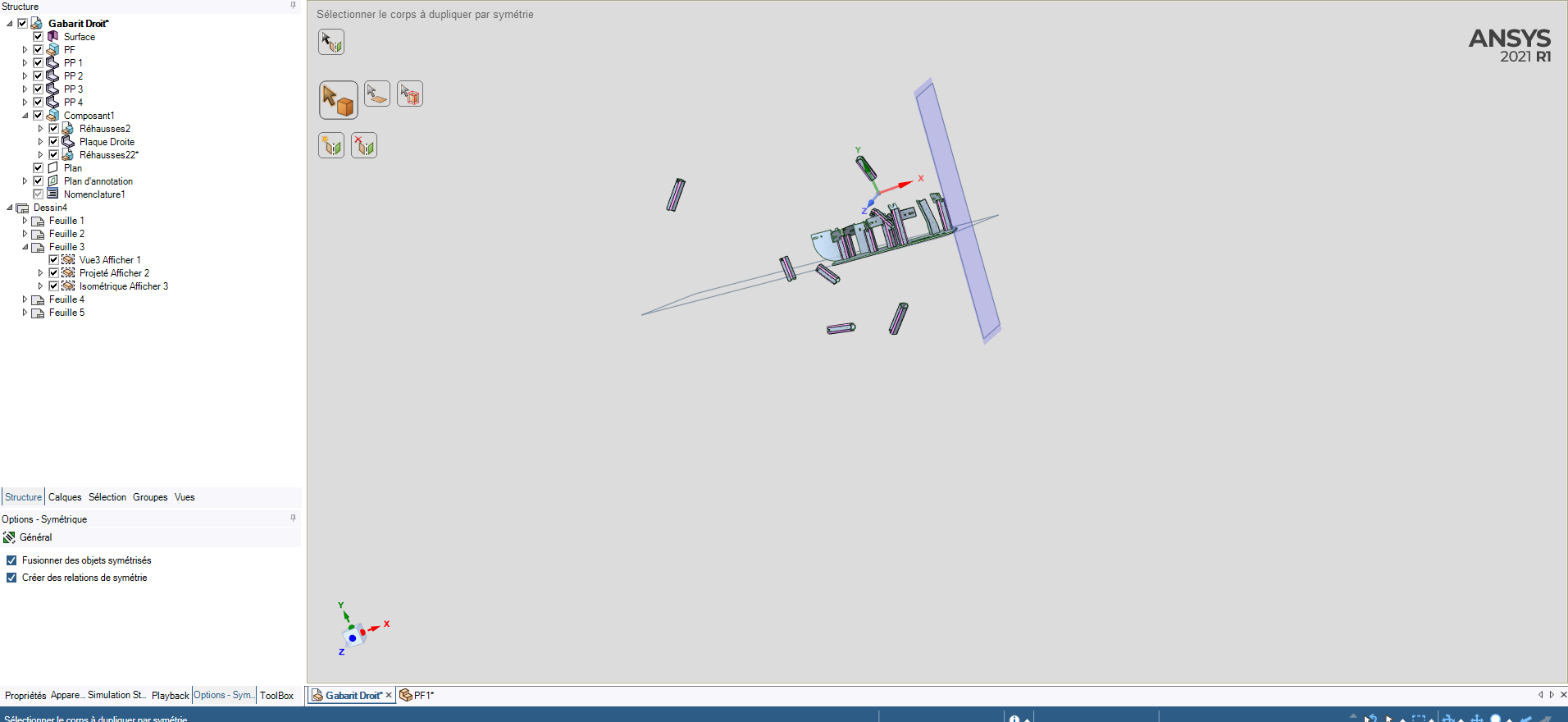

      Hello charlie
      charlie said:
      1/ When I try to do the symetry of a set via "assembly -> file", the set explodes! 1bis/ The external set symmetry explodes!
      I am not sure if this is expected behavior or not, but if you internalize the external components, the assembly doesn't explode
      charlie said:
      2/ when I make the symmetry of a component and I modify afterwards the volume the symmetry does not follow 3/ If I make the symmetry of a body it works on the other hand it is not practical to make a BOM so if I create the component of this new body, I lose the link of symmetry...
      The mirror tool behavior was changed a few versions back.
      If you mirror a component, the resulting mirror will be independent of the original, and therefore changes to one will not affect the other.
      However, if you mirror a solid, changes to one will apply to the other.
      Therefore, if you want to mirror components, wait until you've made all your edits to the geometry of the original before mirroring.

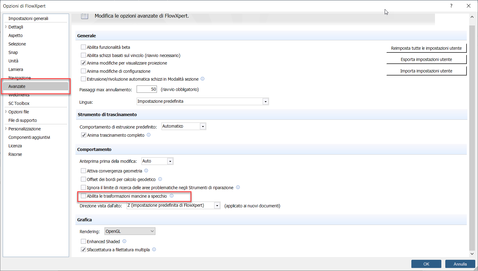

    • Roberto
      Hello Naresh Patre charlie
      Activate the following check, in this way the assime does not explode
      Best Regards
