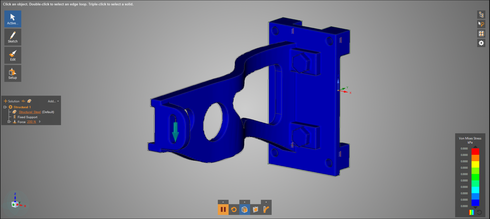

      I'm doing the structural analysis tutorial and followed it exactly (I did it twice to make sure) but when I apply the force it just pulls up the Von Mises stress and has 0.0000 from min to max as shown in the screenshot I attached. The force is 200 N, and I've tried turning it up to 2000 and higher but it's not showing anything still. Anyone have a solution?

      My PC using GPU M2000M occurred  same behavior. Probably your using low spec GPU.  This problem cause seems graphics driver version.  If you can update to new version 2019R2 of Discovery Live, I think you can solve this case.

        Thanks for the tip, updating to R2 solved the problem. Works great now!
