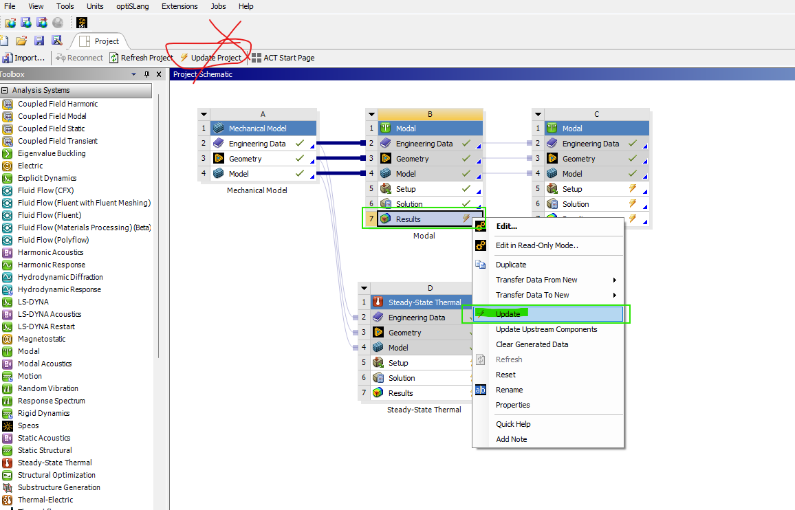

      I would like to update and solve a selection of modules within workbench, without solving all the modules.
      I know that if I hit update it will solve them all, but sometimes this is not preferable, nor is saving a new workbench file and deleting the items not to be updated.
      Is there a solution for this?

      Select the specific cell which you wise to solve and Right click > "update" option; instead of update project.

      Thank you for your response, does this work for selecting multiple modules? can you select B & D in your example and solve them but not C?
    • Deepak
      Only one module can be solved.
    • joe.lindley
      but can i ask ansys to solve B, and then D, but not solve C. The solves would happen sequentially, not simultaneously.
      • ErKo
        Not directly perhaps, but as one possible workaround with workbench (wb) scripting we can solve different systems .
