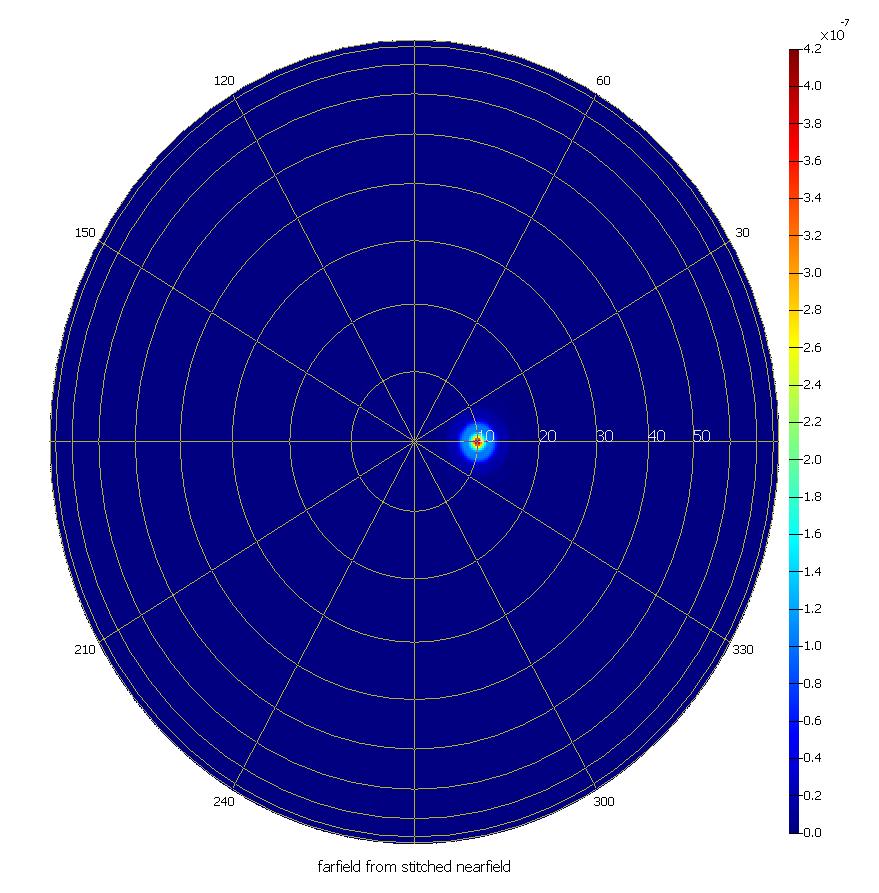

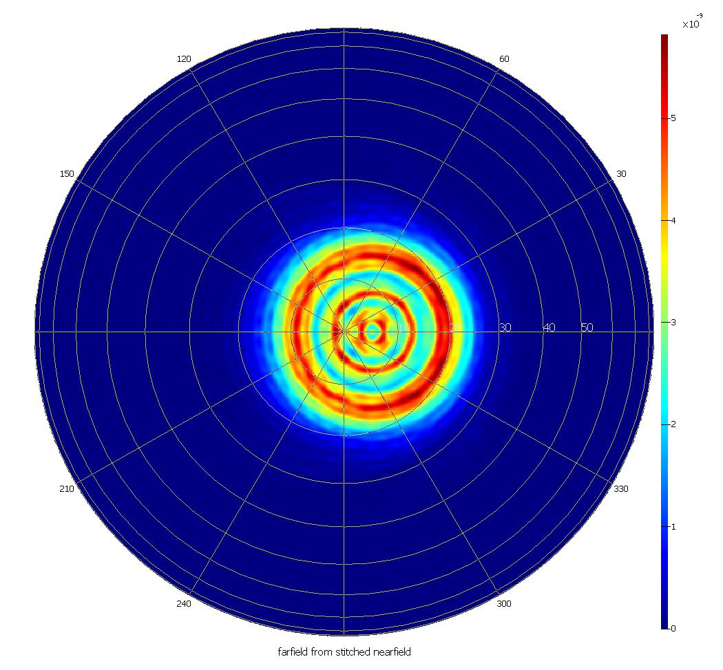

       I am trying to use small scale metalens example of lumerical. When I construct full metalens, in farfield propagation plot in polar coordinates, there is diffraction pattern in small focal lengths like 50um. When I increase the focal length to 300um interference disappears. Do you have any suggestion how to solve this? You may see related images attached.
      Br, Asli
    • Niki Papachristou
      Hi Asli,
      Thank you for reaching out to us. This is very interesting case and I haven't face the exact one before. My first intuition would be that the diffraction pattern is caused due to monitor's dimensions. I would suggest to increase them and reobserve your results.
