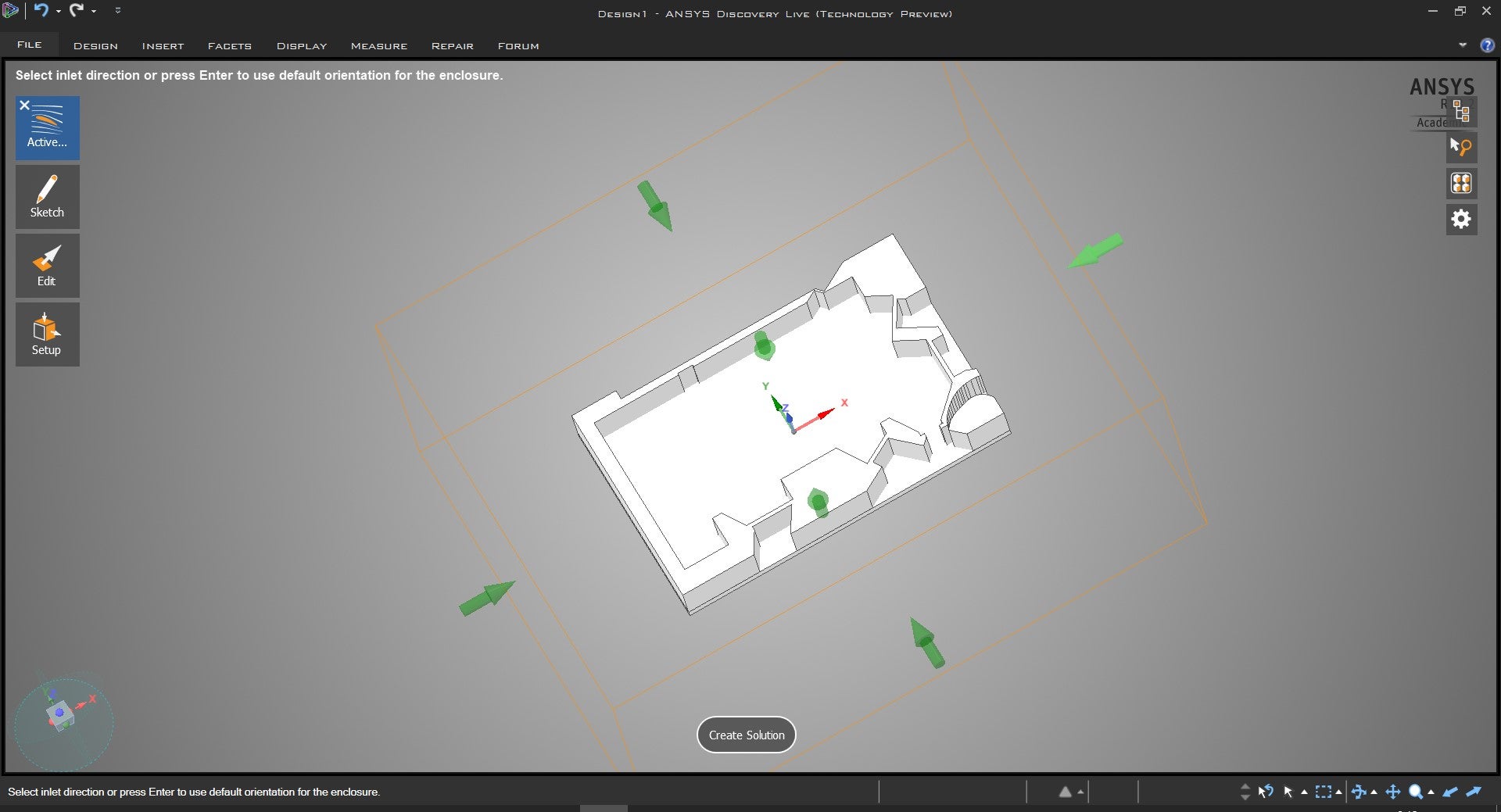

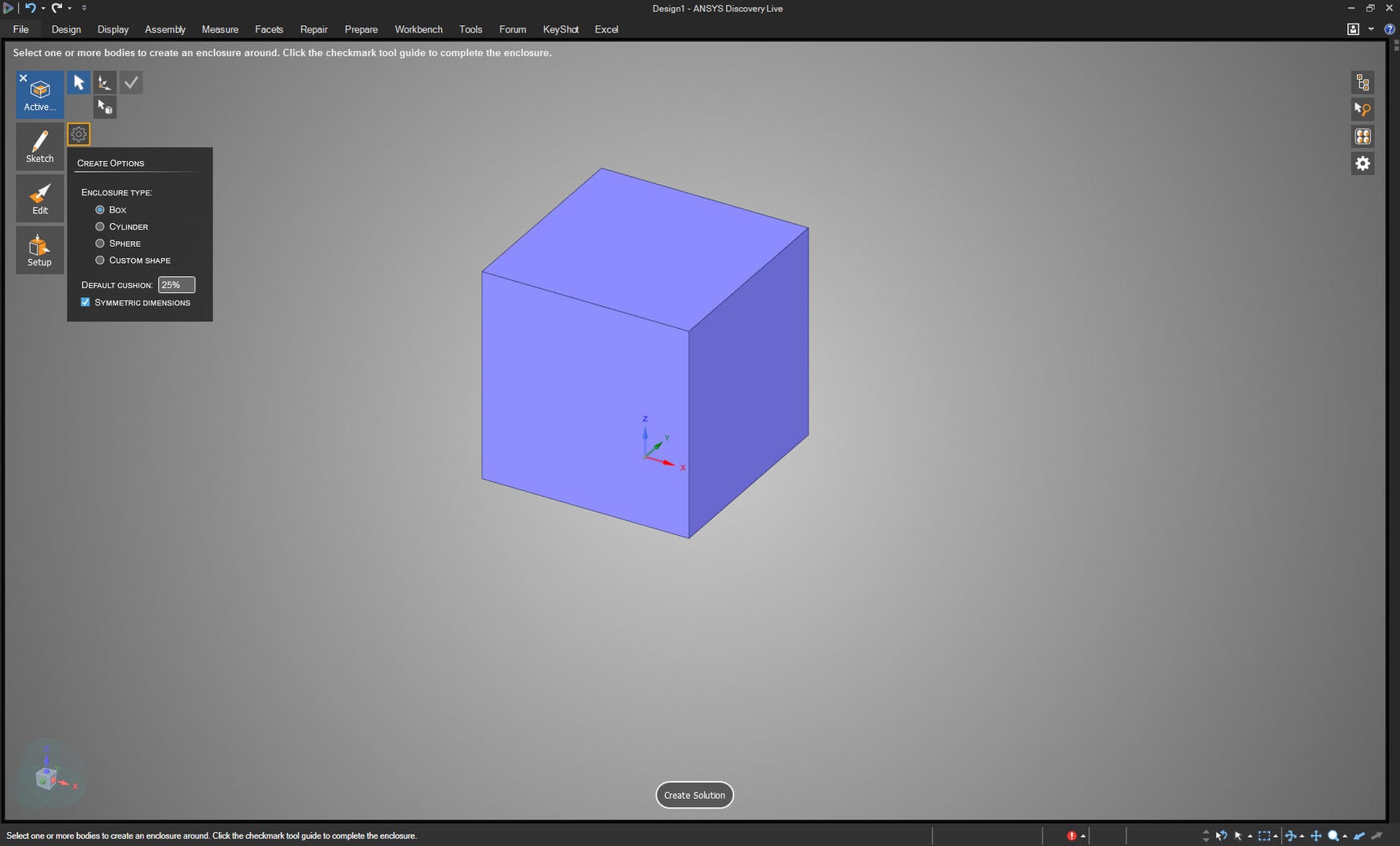

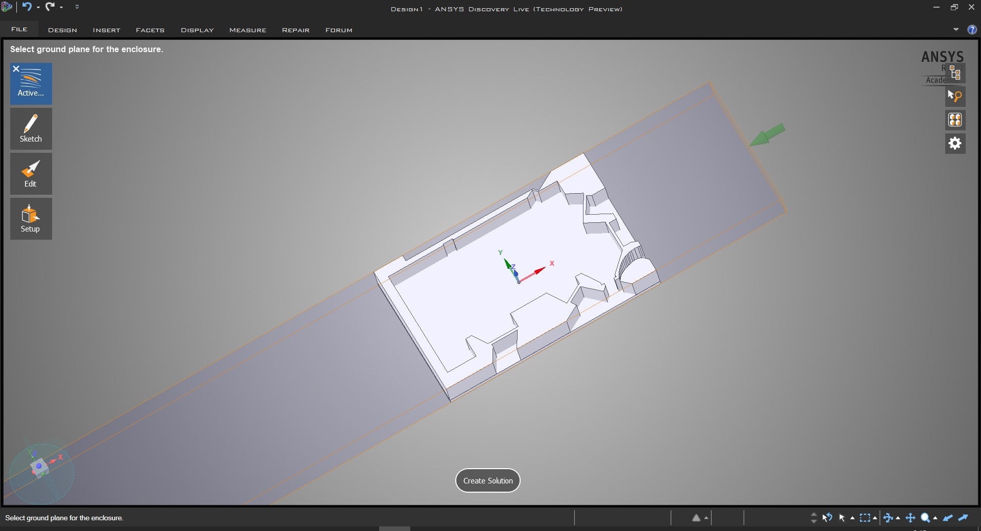

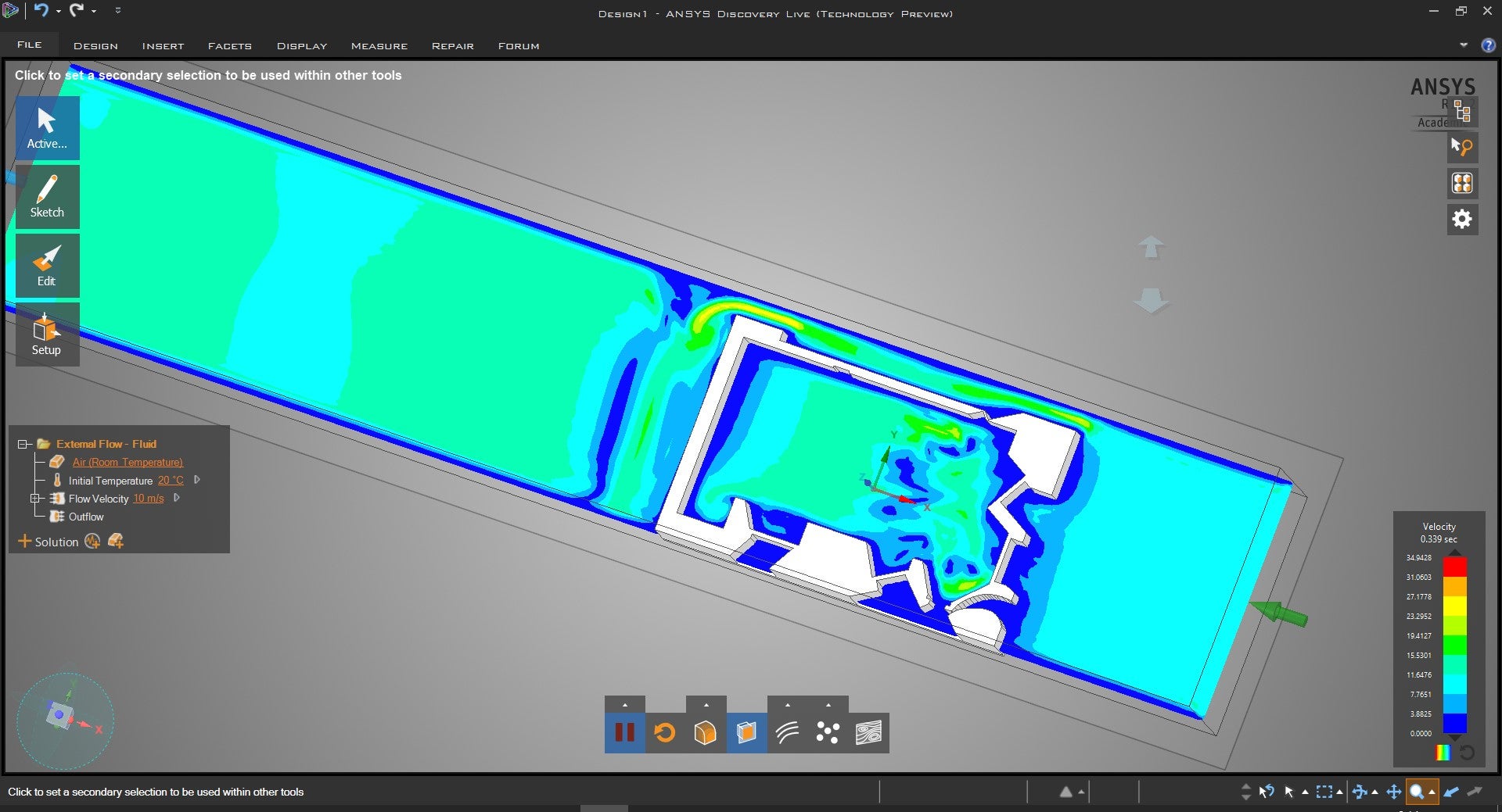

      When clicking to create a new solution, a bounding box is being formed around the model (image 01). But, when clicking on the arrows in order to define the flow's direction, this encolsure is being chnaged into another one, whom dimensions are totallay different and not as the desired (image 02). The solution is being run following the second one (image 03). How can I solve it, so that the enclosure does not change??

      So-Ine  You can create your enclosure before starting the simulation creation process by using the "enclosure" tool in the setup tool bar.  Be sure to check out the extra options for enclosure creation in the options panel.

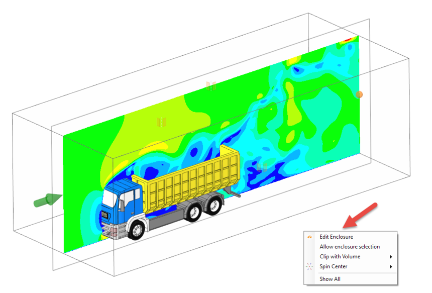

      Also keep in mind that once you create the automatic enclosure you can easily resize it to your liking. To do so, right click anywhere in the scene and select "Edit Enclosure". This will allow you to click and drag on the sides of the enclosure to resize them. You can even change the shape of the enclosure....
