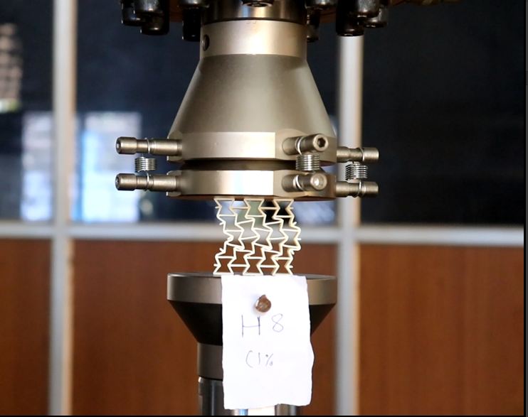

I have performed a compression test and I have all the data. Now I want to validate the experimental data using simulation results. Three specimen were tested with displacement rate of 0.25 mm/s, 0.5 mm/s and 0.75 mm/s individually.
Should I use Explicit Dynamics or static structural analysis?
Material used is ASA (thermoplastic), which is not listed in ANSYS materials data. I want the stress strain curve upto 50% strain, which is in the plastic region (from experimental data).
Hence my question is should I use only isotropic data?
Please reply.

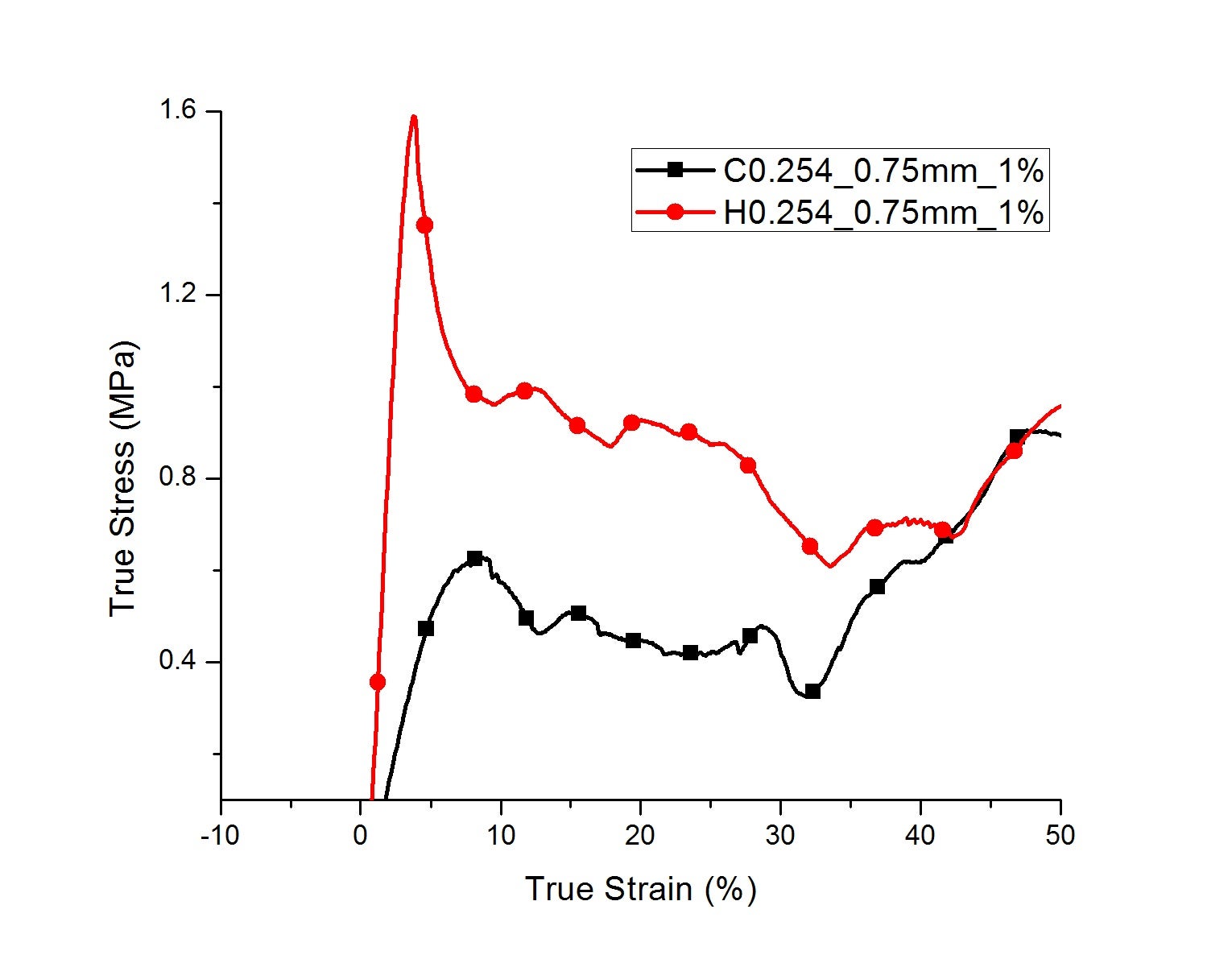

SubscriberThank you Ram for your reply. In experiment
this is the True Stress-True Strain plot. So if I use only isotropic properties, then I am getting curve upto elastic region.

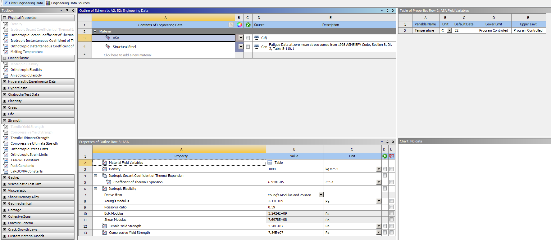

I have gone through this paper for material properties. Also I have the material properties data provided by manufacturer of ASA material, hence I used that data only.
Please find the below image showing the material added using the material properties provided by manufacturer of ASA material.
Please suggest some additional properties needs to be added to get the approx curve. Thank you.

SubscriberThank you @peteroznewman for your reply.
Material (ASA) used for fabrication is not listed in Ansys Engineering Data Sources. Hence can you please suggest some additional properties needs to be added except this.

Ansys Employeeits suprising that the trends of the cure is same with some offset, Have you tried mesh convergence studies, what is the strain rate of your experiment, perhaps the following paper might help you on tuning the material properties
Finite element analysis of 3D-Printed Acrylonitrile Styrene Acrylate (ASA) with Ultrasonic material characterization by Yee Ling YapÔêù, William TohÔÇá, Rahul Koneru and Zhong Yang Chua
cheers, Ram
