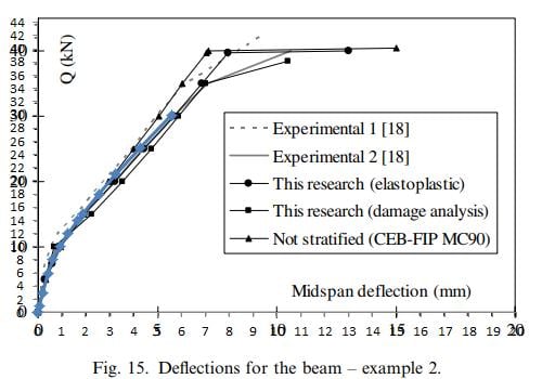

      So the change in slope on the curves, at 10-15 kN, is that due to first cracking you think or, reo. yielding (if it was steel yield, I would assume much flatter/softer curve)? Think it is first cracking (yield seems to be happening at the top of the curve)? Then you seem to have a bit less of it in FEA?

      Yep, this first change in the slope is due to the beggining of the cracking fase (lots of small crack along de mid spam). Yelding of steel should happend only at the end of load capacity of the beam, because the beam was designed to fail with the steel yealding. This gives ductility to the element, and "warns" that it is failing by showning a great deal of displacement and cracking.
      My model was able to replicate the yealding phase, but again, I belive I could do better if the supports were correct.

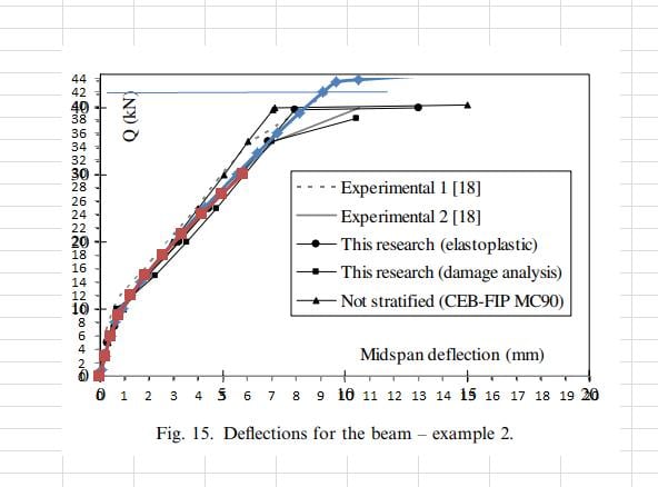

      I have done this in Strand7 with the details we have discussed, and as per this paper:
      A layered finite element for reinforced concrete beams with bond–slip effects
      (Oliveira et al.)
      , and it looks pretty good.
      Blue curve are the Strand7 results.
      (I am not an expert in the ansys microplane model, but the value of 0.75=ko (ko=(k-1)/(2*k(1-2v)), is for a fct of ~ 2.55 MPa, which is higher than the paper and the experiments, of 2.044 MPa. This would explain why the curve is stiffer than the experiments)

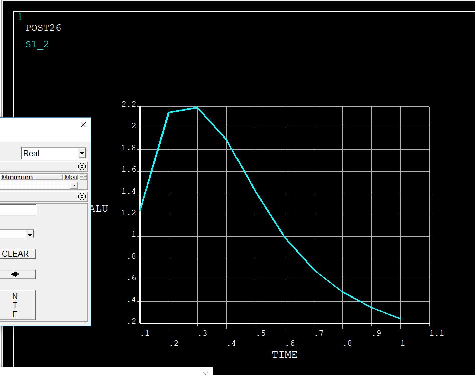

      In any case the 1st principal stress should not be above 2.044, and then it should go down after cracking.
      I have tried the DP Plast.-Microplane and it works quite well. Just one parameter which I do not know and influences the response (tension damage evo. par., beta_t in the help manual). I have reduced that slightly (0.15E4) since I do not know how it is obtained (cyclic tests, which I do not have) from the values given in the apdl script from my previous post.
      The results are spot on (red curve, of course I have tweaked beta_t but one can get it from the paper Bt, if one knows the relation between the Mazars model and this one) and I can see the cracking at ~2.1 MPa max principal stress, and then softening due to cracking.

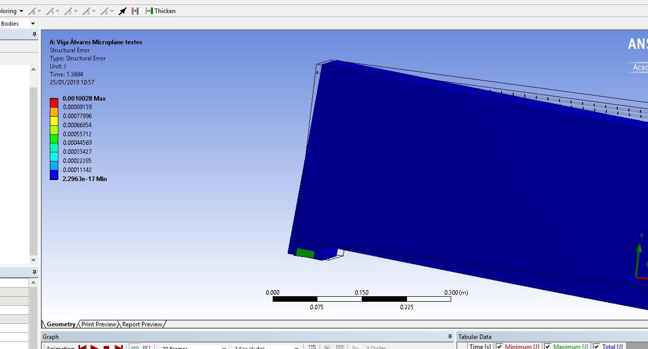

      So I tried the Elastic Microplane Model (Solid185) on another beam, and the Maximum Principal Stress finally hit close to 2.04MPa, as it should be
      The beginning of the softening
      Maybe there is something wrong with my model for the beam we were discussing. Just wanted to share to results! Thank you once again
