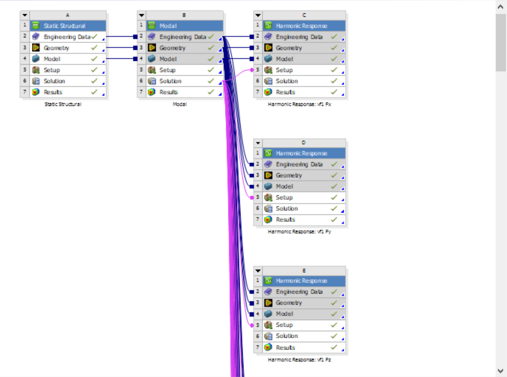

      I'm working on a Harmonic Response analysis.
      My calculations are set up in a way that I have multiple analysis systems, like in the picture below:

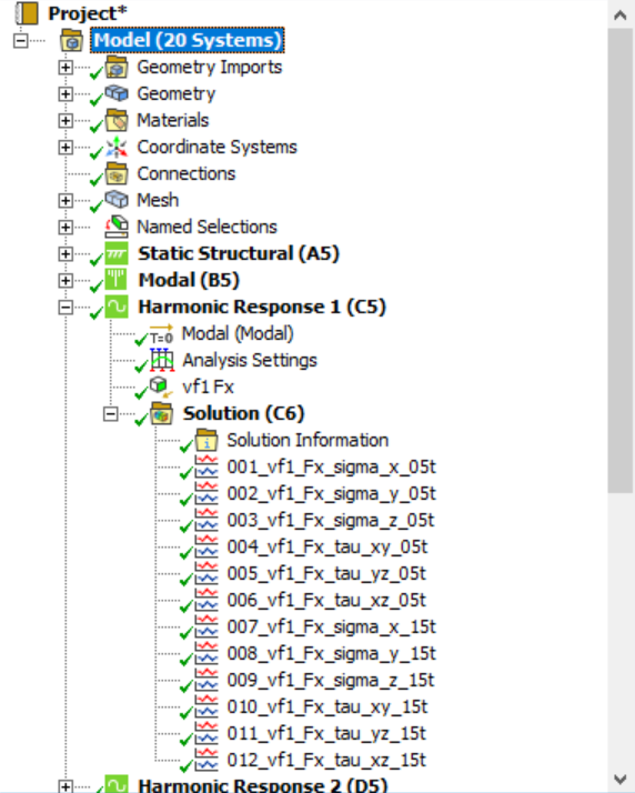

      Results I'm interested in are the frequency responses for the stresses at the specific nodes:
      In total I have 216 results which I would like to export to separate .txt files.

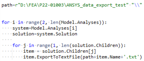

      The simple script I made looks like this:
      When I run the script I get the following error message:
      Is there any other way of exporting the frequency and amplitude data for the selected results?
    • Aniket Chavan
      There does not seem a direct way to do this now, but in the InternalObject of the item there should be a call for it you can use as CreateTabbedFile(r”) to export the string which can be written to a file using python commands.
      -Aniket

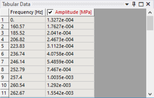

        My script goes through all results from the selected analysis systems
        and exports defined columns (in this case #2 and #3) from the Tabular Data panel to separate .csv files.
        Name of each file is the name of the given result (e.g., 001_vf1_Fx_sigma_x_05t, as shown in the 2nd picture in my original post above).
