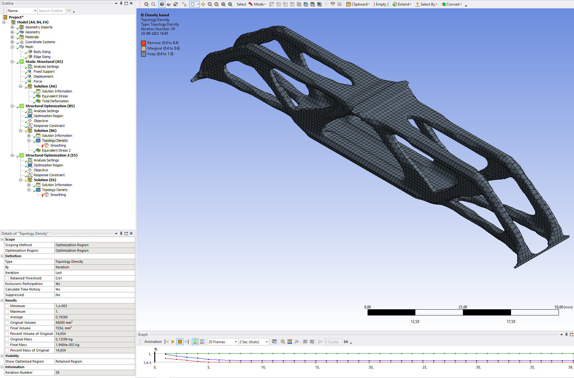

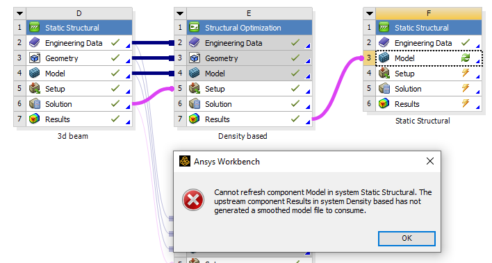

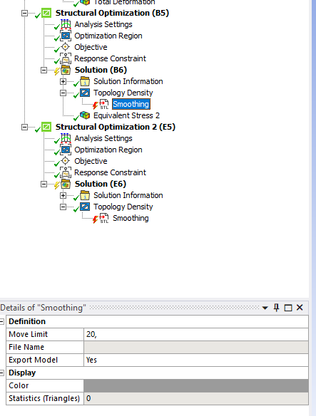

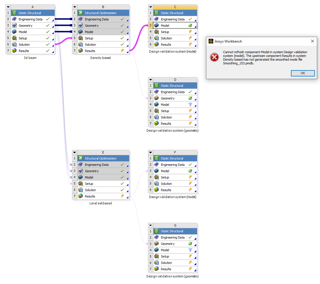

      Im using the Ansys Structural Optimization tools to redesign some parts with topology optimization, and im having a lot of trouble transferring and validating the resulting structure using the Design Validation System. The smoothing operation throws an error ("STL file is corrupted") when exporting the model. However, when the smoothed STL file is manually exported it works fine. Without the exported model for the smoothing operation, the Design Validation system does not receive a model (i think?) and also gives an error.

      I've tried with different move limits in the smoothing  (1-40) but that doesn't seem to make a difference. This issue is across all my projects and two different computers, even on relatively simple studies such as the one in the screenshots attached.
      I'm relatively new to Topology Optimization in ANSYS so i might have missed something obvious.

      Im using ANSYS 2022 R1 with a student license on a Windows 10 x64 machine. Below are some pictures of my problems.

      I see you have the Windows decimal separator set to comma ",". Please set Windows decimal separator to dot "." and try the export again.
      Or,
      In the Details of Smooting, try setting Export Model to "No".

      1. Changing decimal separator did not change anything.
      2. Smoothing does indeed work fine when Export Model is set to "no". However, i then have another issue when attempting to validate the TO geometry using the Design Validation System function:

      Try adjusting the input mesh...Possibly mesh sizing, or force all Tetrahedrons.
