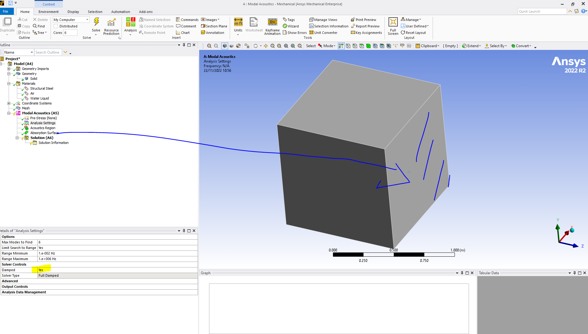

That should work only on a single non shared face belonging to an acoustic region made of a 3D part/body.

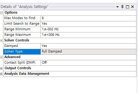

Also one needs to activate a damped solver since this adds damping – done under analysis settings.
One can see this error when trying to solve your system as it is – it will prompt the user to use the damped solver.

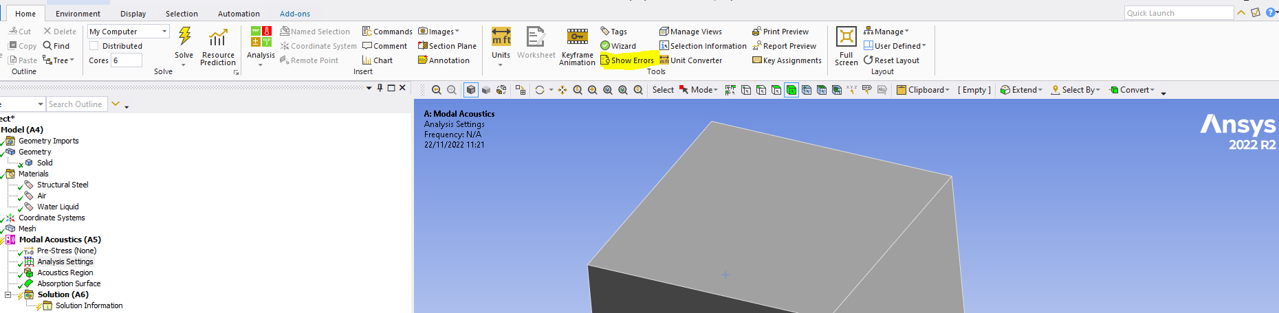

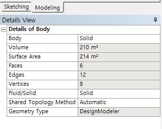

I meant face – so it can be scoped to a face belonging to a part/body. So for sure there is something going on with the geometry – can you show it please and the list of all parts involved (also it can not be an interior face).
So do a simple example - do a cube - and scope the absorption surface to one side/face - that should work.

I scoped by the using both geometry selection and the named selection. I selected from the outside as well. But question mark still remains.

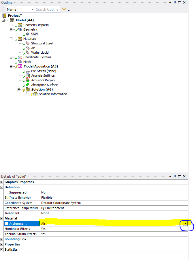

SubscriberHow can I lift the question mark from the acoustic region without material assignment? Sorry for bothering. I am real beginner.

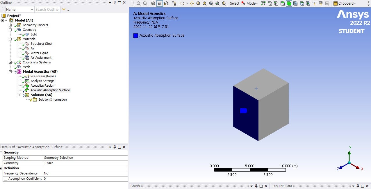

SubscriberI have assigned the air for the solid body from the body detail page. The question mark next to absorption surface turned to check. For those who encounter a problem about adding absorption surface make sure that your solid body material is air.
November 22, 2022 at 11:55 am
ErKo
Ansys EmployeeThank you - yes, we need to have acoustic properties/material for acoustic regions - so we need at least speed of sound and density for the material properties for acoustic regions.
