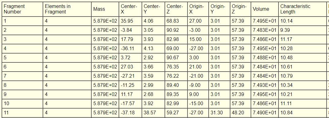

      Can anyone help me to get pressure-time graph or pressure-distance graph in autodyn, I've performed simulation in which fragments moves away. i want to know the distance travelled by the fragments and internal energy of the fragments. And also tell me what is the characteristic length in below image?

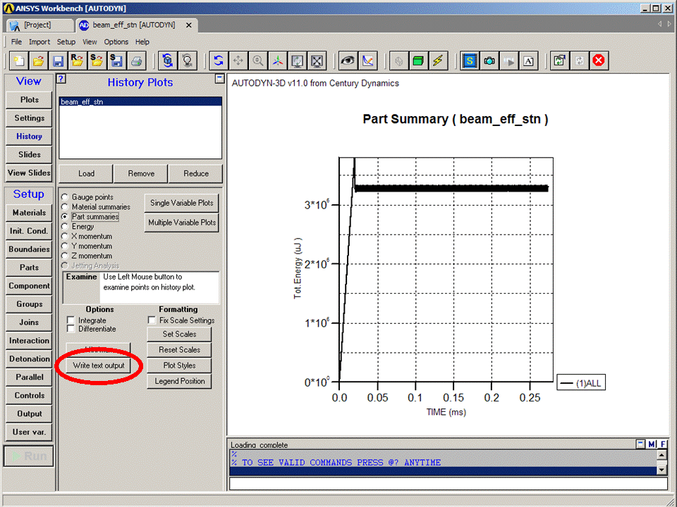

      You can output the time history of variables at gauge points, or part summary, or material summary to a text file as instructed in the following picture. Then open the text output in a spreadsheet such as MS EXCEL. You can then use EXCEL to further post-process the time history results.
      Characteristic Length indicated the geometric dimension of fragments.
