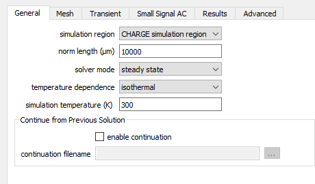

      Hi Thanks for reaching out. When including the heat effects in your CHARGE simulation, what temperature dependence mode are you using (in the solver settings)? Please note that the coupled mode can not be used here since fluids (here air) can not be simulated in coupled CHARGE simulation. Here to include the thermals you can use the non-isothermal mode. I tested this mode as instructed in the article and the project seems to work.

      In my simulation when I change to isothermal to non-isothermal and run then I always get the same error. Its only works in isothermal mode.

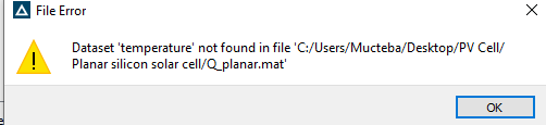

    • Mucteba13
      When I click the HEAT data its says ;

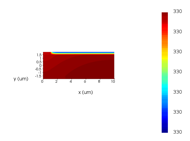

      And Run the simulation as isothermal mode my heat visualize is ;
      here the right side has exactly the same values.

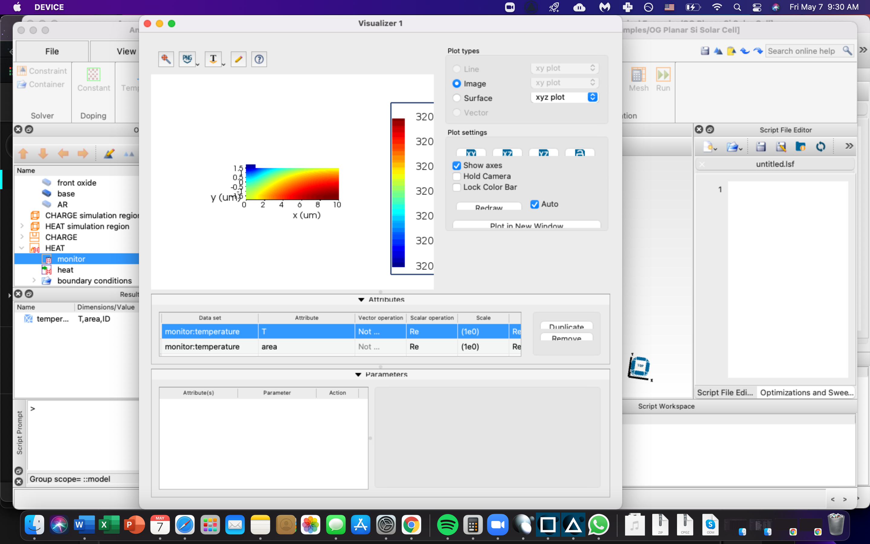

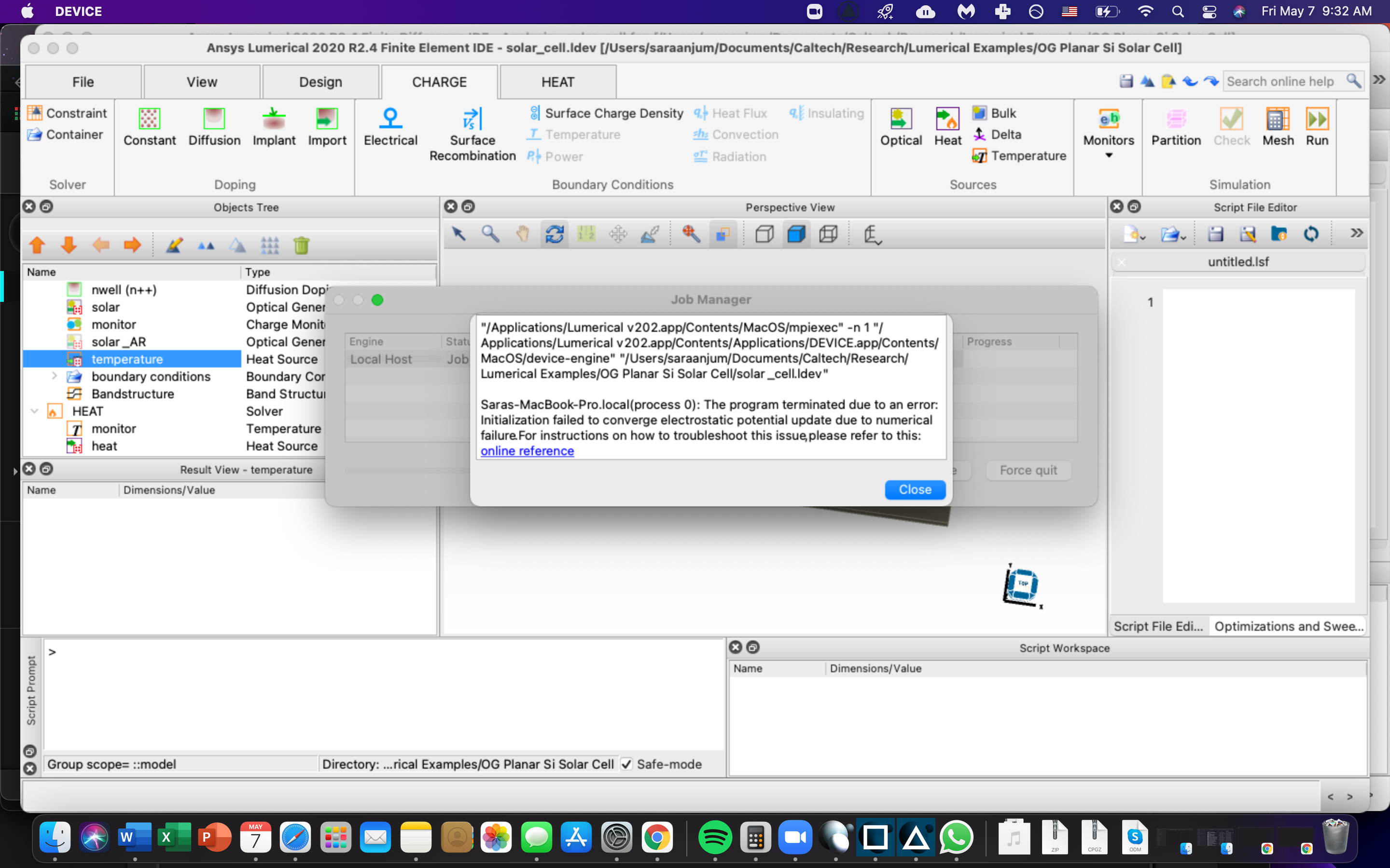

    • sanjum
      Yeah, for me it only worked in isothermal mode, not non-isothermal. I have attached screenshots showing that I get the correct HEAT results but that my CHARGE simulation does not converge:

    • kghaffari
      Thanks for further explaining this. The attached results match what is expected and published in the article.
      Like you mentioned the issue is the non-isothermal mode not working for you. This is unexpected; I tested the example on different versions of the software and the non-isothermal mode works for this project. I will follow up on this with you shortly.
