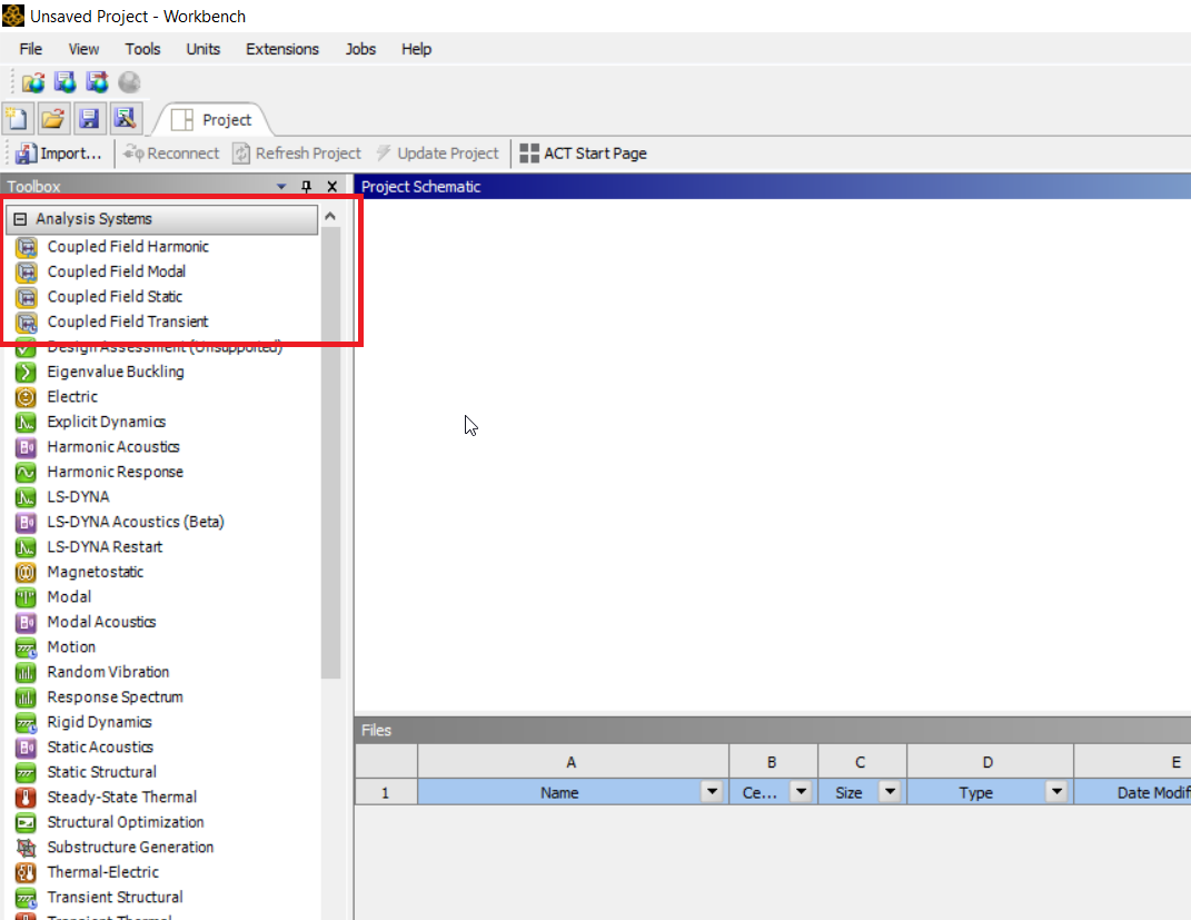

      I'm just about to finish my simulations of a piezoelectric flag in a wind tunnel and fr harmonic response I need to import the piezoelectric body function but I can't seem to gain access to or find PiezoAndMEMS under the act extensions on Ansys2023R1. Thanks in advance
    • Rahul Kumbhar
      For 2023R1, one does not need ACT extension. These are available as native applications in Workbench.
