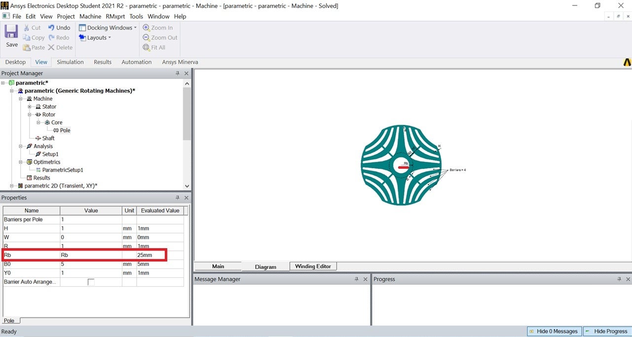

      Is it possible do to parametric simulation in order to change one of the design parameters of motor that are needed in RMXprt but in Maxwell 2D desing. I know that parametric simulation can be done in RMXprt but when I convert model in Maxwell 2D and run parametric simulation there, geometry of motor isn't changing at all. Does anyone of you know on what I should look out when doing this?

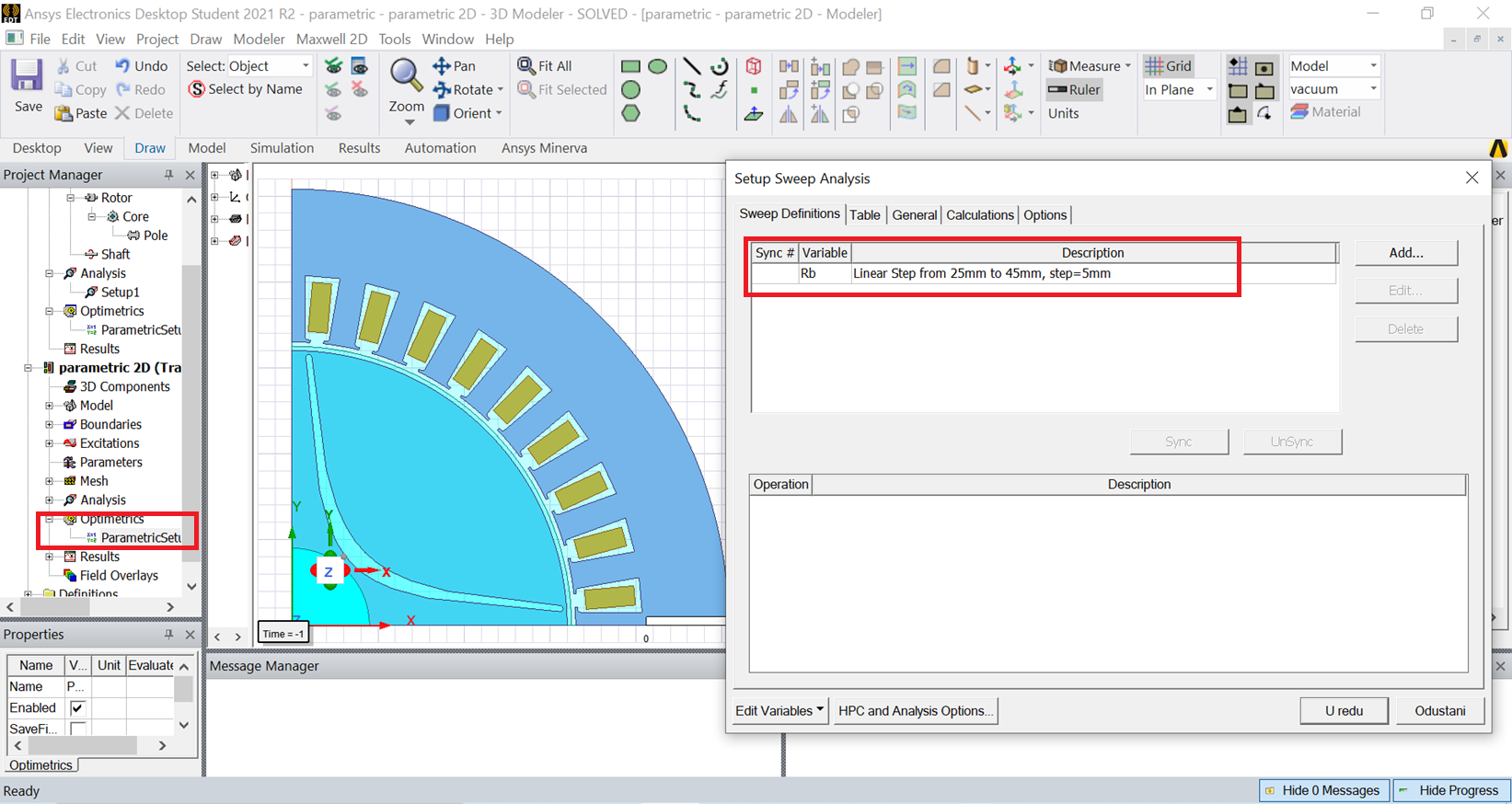

      Down below are screenshots in which you can see that I can make parametric solution in RMXprtand setup sweep analasys in Maxwell 2D but I think you are right when you say that I cant get every variable of motor. But its weird that I can do that setup sweep analasys but in reality its does nothing since I can check results of every iteration and they are same so geometry must be same then.
