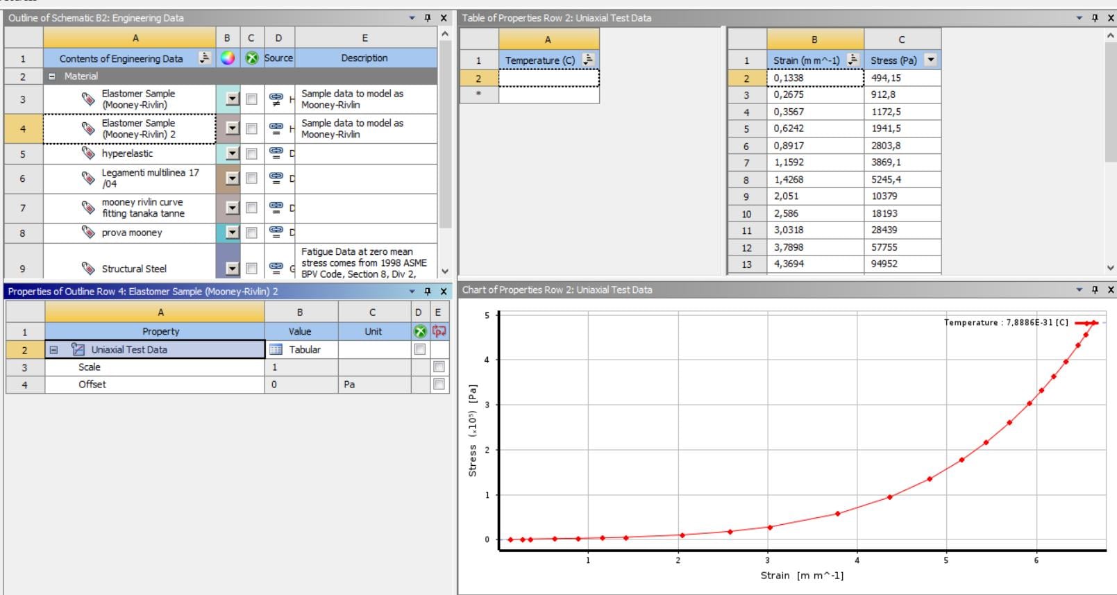

I just have a curiosity. I have to define a hyperlastic material in engineering data, but I have the values of 2 parameters regarding Mooney Rivlin model, thus I'm wondering if it is sufficient to insert the values of c10 and c01 or if I have to use experimental data to perform a curve fitting in order to get the values for the paramters.
Thank you

Beside this, I'd like to ask you if it is right the following assumption: since I have to model the behaviour of a hyperelastic material, before finding in literature the values of the material I am interested in, I tried a general approach suggested by a video in which an elastomer sample (Mooney-Rivlin) was taken from the engineering data sources (see the image)

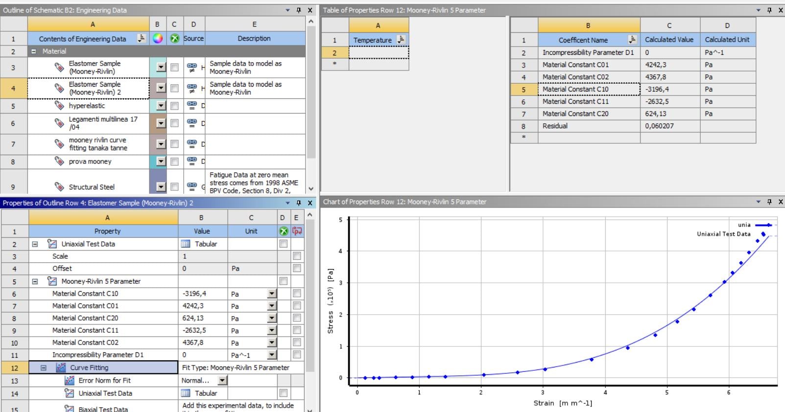

and a 5 parameters Mooney Rivlin model was used for the curve fitting in order to get the values for all the parameters, even if the test was uniaxial by defalut.Â
Thus, if the test is uniaxial the parameters c20, c11, c02 are correct? Can I use this model for a hyperelastic material which has a great deformation?
