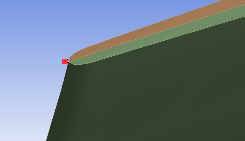

      as part of a project, I have built a blade from fiber composite with Ansys-ACP. To perform an evaluation of the model results I need to calculate the deformation of the points at the leading edge and trailing edge at the blade tip (see picture). By creating a named selection and assigning the desired point using geometry selection, the picture in the appendix is obtained. So far so good.
      By doing a parametric study and varying the orientation of the laminates of the composite blade, I would like to investigate the effect on the deformation at the two points at different laminate orientations. However, a change of the orientation of a laminate in ACP leads to the fact that in ANSYS-Mechanical the Named Selection of the point is no longer recognized and consequently automatically suppressed.

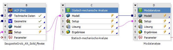

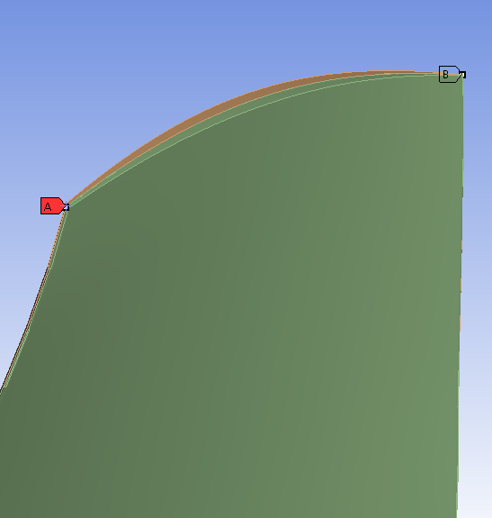

      I want to do a parametric study on a fiber composite blade. In the parametric study the orientation of the laminates is changed. The objective is to study the influence of the orientation of different laminates on the torsional part of the first vibration mode of the blade. Thus, after ACP-Pre, a Stractrural-Analysis and a Modal Analysis follow (see picture bellow).
      To calculate the torsional part I need the deformation of the blade tip once at the leading edge (A) and once at the trailing edge (B) (see picture bellow).With a defined layup I can define a named selection in Ansys-Mechanical at the two desired points. However, this is not possible for a parametric study. The named selection is suppressed when the orientation of the layup is changed.Consequently, I do not get the torsion part as output for different laminates in the parametric study.

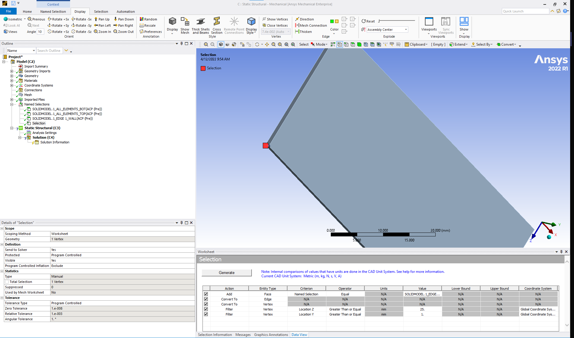

      When you define the named selection for the point, you are using vertex, not node, right? Now if that is the case, maybe you are using solid composite and not shell? When solid composites are passed, the geometry is synthesized and we need to take additional steps to get name selections to persist. Can you confirm if it is a solid composite?
      Thank you!

      like suspected I am using a vertex for the point and I can confirm it is a solid composite. What are the additional steps to get a name selection to persist?
      I have found a possible solution: You can define in ACP-Setup two nodes at the leading edge and trailing edge of the blade tip as edge sets. This is transferred to ANSYS-Mechanical as a Named Selection that persist (if you don t change the mesh), but only as a surface. By the deformation of the generated surfaces the result can be approximated. Is there another way?

      So here is what you do. You create an edge name selection in the base mechanical system. Then this will go to ACP as normal, when the solid is created, that edge turns into a face in the extrusion process. This you already know. The key is then insert another named selection, but change the scoping method to worksheet. You can then add rows to the worksheet to convert the face to edges, then to vertrices, then filter based on spatial location. You can hopefully see in the screen shot the details of the worksheet. In the end I have 1 vertex that will persist.
      Please try and let us know. If the screenshot is not clear enough, please also let us know.
      Regards Sean
    • jp_jason
      I tried your method and it s working perfectly. Thanks a lot for the help!
