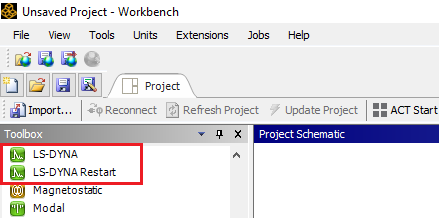

      Hi Camilla,
      You can exploit “restart” capabilities of LS-DYNA that are available in Workbench LS-DYNA as well (see the image below)
