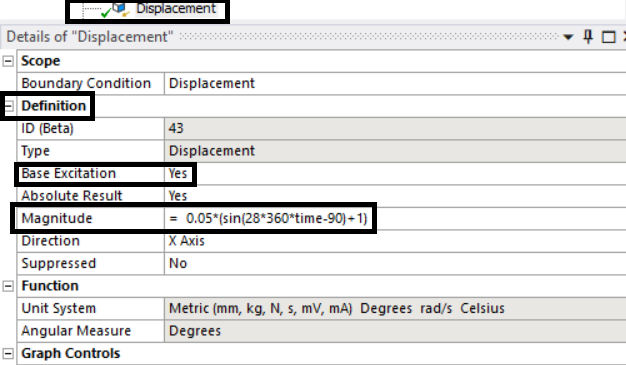

I would like to model the model below but I don't know how to define the periodic boundary condition in Ansys workbench . I ask for your help to solve this problem
Thank you in advance.
May 4, 2022 at 2:07 pmSaumadeep Choudhury

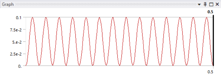

I'm assuming this is a base excitation case and for that, you can use the "Displacement" boundary condition and in that turn on base excitation and provide a periodic excitation as shown in the images attached.
Thanks, Saumadeep
Ansys Help

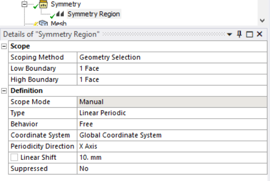

May 4, 2022 at 4:52 pmcpgeagadir
SubscriberThank you for your reply. The base is a periodic foundation and I wanted to model the periodic boundaries of this structure
May 5, 2022 at 12:42 pmAshish Khemka
Please insert periodic symmetry. For your structure, I think you can insert a linear periodic condition.
Symmetry Region (ansys.com)
