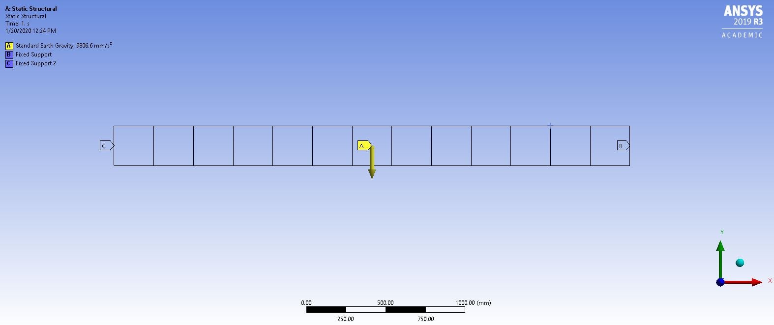

      I am facing a problem in workbench modal analysis results. I had models a simple steel beam of length 1.044 m and cross sectional dimension 0.023 x 0.005 m. E = 2.05E+11 N/m^2 and poisons ratio = 0.3. Density = 7830 kg/m^3.
      Theoretically i have calculated its first three bending modes and their frequencies are f1=10.65, f2=42.58 & f3=95.81 Hz respectively.
      In FE Model, beam length is along the x-axis while its width (0.023m) is along z-axis and depth (0.005m) along y-axis. I had applied boundary conditions at both extreme ends as follows to let the beam behave as simply-supported:
      UX=UY=UZ= 0 & RX=RY=0 , RZ= Free
      With all these conditions i am getting first three modes as:
      f1=16.283, f2=44.887 & f3=98.13 Hz
      Why the Theoretical and Numerical values are not equal or at least there should be very less difference between them?
      Is there any problem with the boundary conditions or something else?
      Looking for the solution.
      Thanks

      I would start by freeing the RY degree of freedom and seeing what effect that has.
      Have you modelled your beam as a beam element, shells or as solids? Your beam is extremely slender based on the dimensions you have given.

    • smehboob
      As far as the problem of modeling simply support condition for a beam is concerned, is resolved using the following guide line and validated using the analytical value of maximum deflection for simply support condition.
      First, both extreme faces of beam were signed a reference line (shown in figure below) which will be later on selected for applying support conditions. Using set of options: Plane>Sketch>Face split.
      Support Condition Closeup View
      Similar, BCs are assigned at both ends as shown below:
      BCs at both ends
      Now, general static analysis under standard gravitational load is performed and the numerical results are:
      Deflection of beam
      Theoretical Deflection at mid span of beam should be 0.107 mm which is almost equal to numerical value i.e., 0.11 mm
      So now BCs is properly applied.
