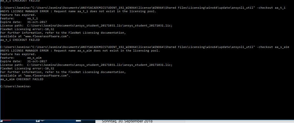

Let's test if the new license works using the command line.
Open CMD Prompt, then issue the entire following two commands (change your installation path accordingly)
"C:Program FilesANSYS IncANSYS StudentShared FilesLicensingwinx64ansysli_util" -checkout aa_t_i
"C:Program FilesANSYS IncANSYS StudentShared FilesLicensingwinx64ansysli_util" -checkout aa_s_aim
Then post the screenshots of the output message from these two commands here.

October 2, 2018 at 12:05 pm
Jasmina92
Subscriber -

Ansys EmployeeHi Jasmina92 ,
I think you misunderstood my instructions earlier and you are doing it in opposite. I'm talking about this part
"Once you have the package, unzip it, and go to 'student' folder. You will see 'WINX64.7z' in here. Un-compress this file and go inside Shared FilesLicensing folder. Here, there is a 'student.lic' file. Take this file and replace the one in your current installation (default is C:Program FilesANSYS IncANSYS StudentShared FilesLicensingstudent.lic)"
Once you extract the WINX64.7z , you would have a student.lic file under C:UsersJasminaDocumentsANSYSACADEMICSTUDENT_192_WINX64Shared FilesLicensing.
What you should do here is to move this student.lic file to replace the one inside your current installation directory (default location) C:Program FilesANSYS IncANSYS StudentShared FilesLicensing
That should update the license for your currently installed v18.2.

October 4, 2018 at 4:00 pm
tsiriaks
Thanks for the info. Those screenshots help a lot.
However, those are 'installation package' directories. I don't think your ANSYS Student v18.2 is installed under these directories.
You can check your currently installed ANSYS v18.2 directory by open CMD Prompt, then type 'set AWP_ROOT182' without the quotation ' ' , this will show you the path.
Then, what I meant on my first post is to replace the 'student.lic' file inside this path
For example, your AWP_ROOT182 is C:Program FilesANSYS IncANSYS Studentv182
then your student.lic would be under C:Program FilesANSYS IncANSYS StudentShared FilesLicensing
Also, once you replace it, the commands that I asked you to run earlier, should also be run under this directory, e.g.,
Hope this helps.

October 5, 2018 at 12:04 pm
Jasmina92
SubscriberWin, thank you a lot!
Of course, I was looking in the 'installation package' all the time.. thank you very much, now I replaced the license correctly and everything works!
