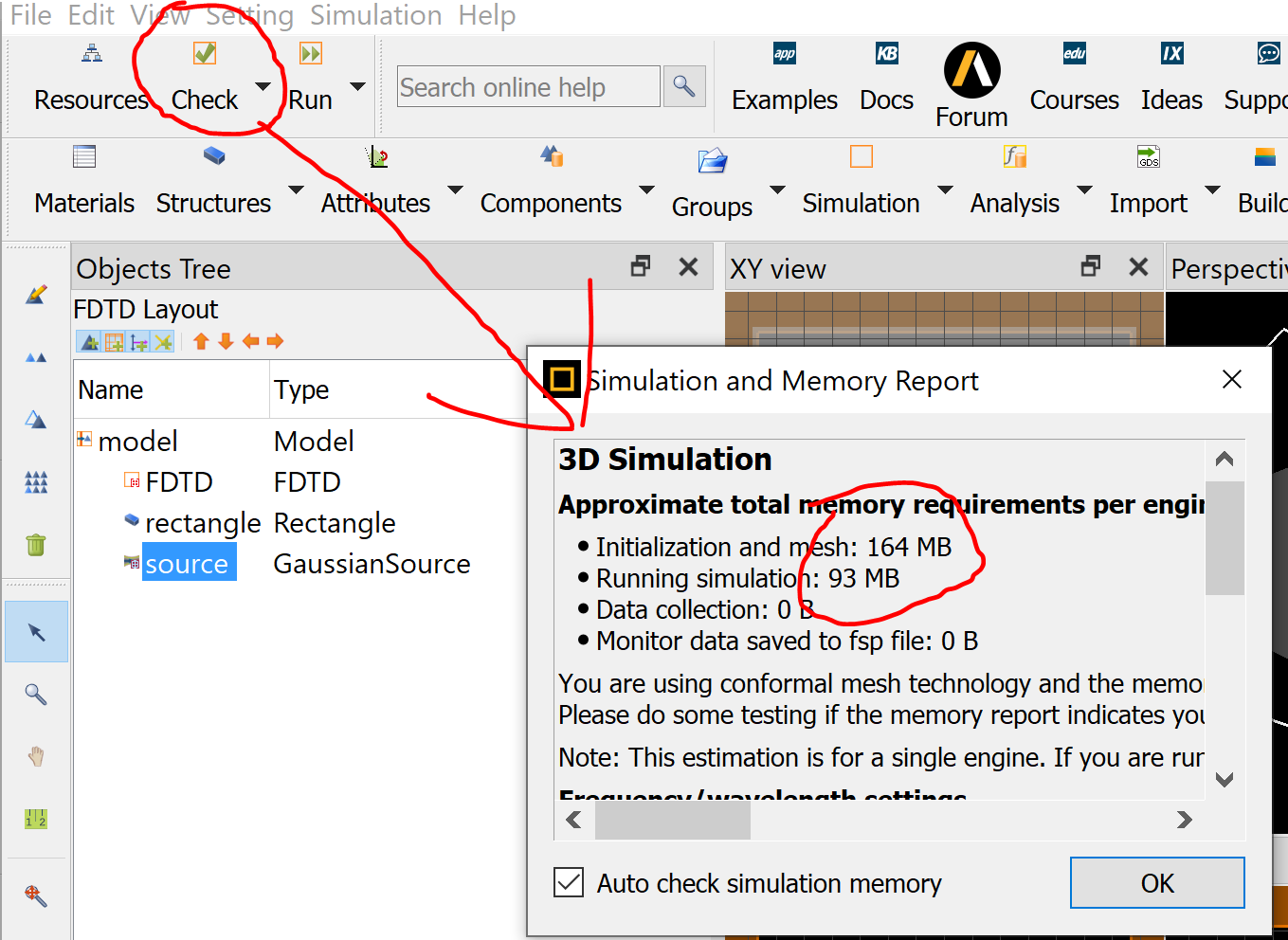

Ansys EmployeeWe have examples for SHG and crystals. However, FDTD works best for device in wavelength scales, eg from 10^-2 to 10^2 order of wavelength. Too large the device compared to wavelength creates serious challenges on memory, speed and accuracy. I would suggest that you try the software: https://www.lumerical.com/evaluate-for-free/
just set the device with the specified source, check the "Resources" and see if your computer can handle the memory requirement:
Nonlinear material models: Standard optical permittivity material models in FDTD and MODE
Nonlinear examples are here, https://support.lumerical.com/hc/en-us/sections/360007004493-Nonlinear
in particular:
Harmonic generation with a chi2 material
Four wave mixing with Kerr nonlinear material
