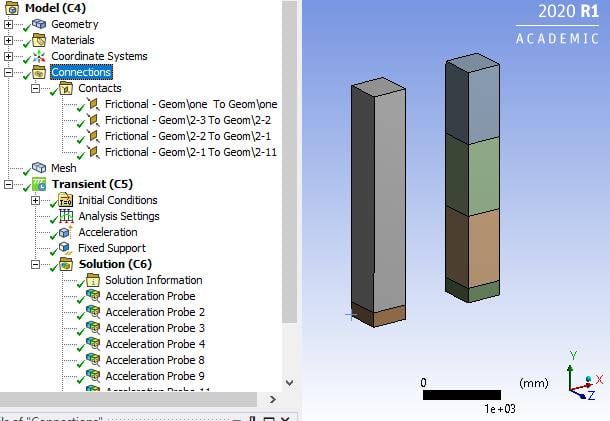

      Firstly I checked the simplified model.
      I input the acceleration and checked the acceleration probe (at each floor)
      I don’t understand why each floor has the same acceleration and the acceleration at base is so low, compared with upper floors.
      I think that th fixed support is not reasonable boundary condition or I missed something
      Could you help me to check my model? Thank you so much!
      https://www.dropbox.com/s/xc4vm6r3ayrrdj5/Question.zip?dl=0
      Gayoon, I don't think you should be using Frictional Contact. You have two columns that are sliced up and have a Frictional contact between them. When you do a Modal analysis, the Frictional contacts are converted into Bonded Contacts and the buildings sway in Mode 1 at about 24 Hz and wobble in Mode 2 at about 136 Hz.
      But when you are in Transient Structural, the Frictional Contacts behave as slip planes. The acceleration is purely X and there is no -Y component to represent Gravity, so there is no normal force, so there is no frictional force keeping the top of the building connected to the base.
      I suggest you convert the Frictional Contact to Bonded Contact for the Transient Structural analysis, but if you do that, both towers become incidental.
      If your goal was to introduce lateral flexibility at different levels of a building, where the blocks are considered rigid, you could do that in the X axis by inserting a Translation Joint at each slice, delete the contacts, and insert a spring between the blocks in the X direction with your desired spring rate. Now you will get a single mode in the first tower, since there is only one moving mass, while the the second tower will have 3 modes because there are three moving masses.
      Looking at your acceleration load, the sampling frequency is about 15.6 samples/second. This sampling rate is too low for exciting structures that have a first natural frequency of 24 Hz. The rule is a minimum of 10 and preferably 20 samples per cycle of the highest frequency of interest. That means the acceleration should have a sample rate of 240 Hz. You have 15.6 Hz. I have downloaded seismic data from the internet and it was sampled at a higher frequency than 15 Hz.
      Now if that modal frequency is irrelevant because you want to do the lateral springs, you might end up with a structure that has mode 3 < 1.5 Hz and so your acceleration load is adequate for that structure.
      I hope PSiedlac123 takes a look and replies with more comments.
