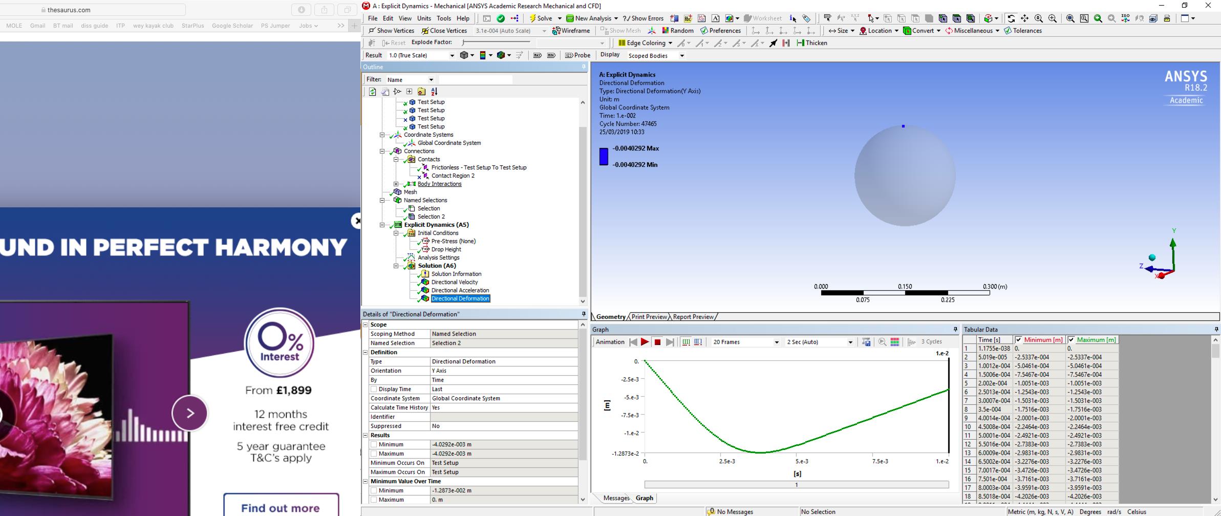

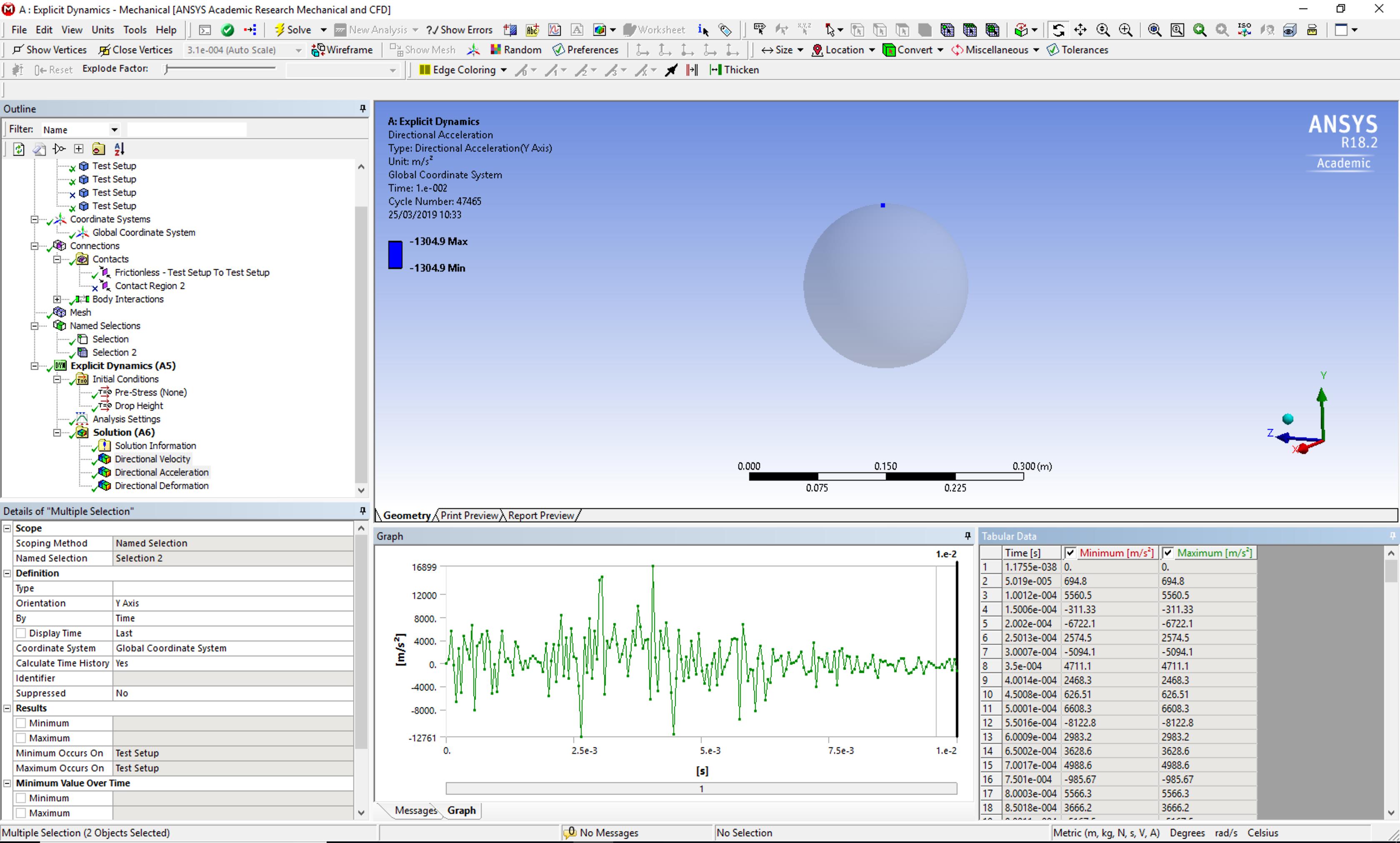

I am doing an impact test in explicit at a speed of 5 m/s but am getting very acceleration values from a placed probe. Can anyone point me in the right direction with were I am going wrong?
I have attached an image to show my issue.
Thanks in advanced,
JackÂ

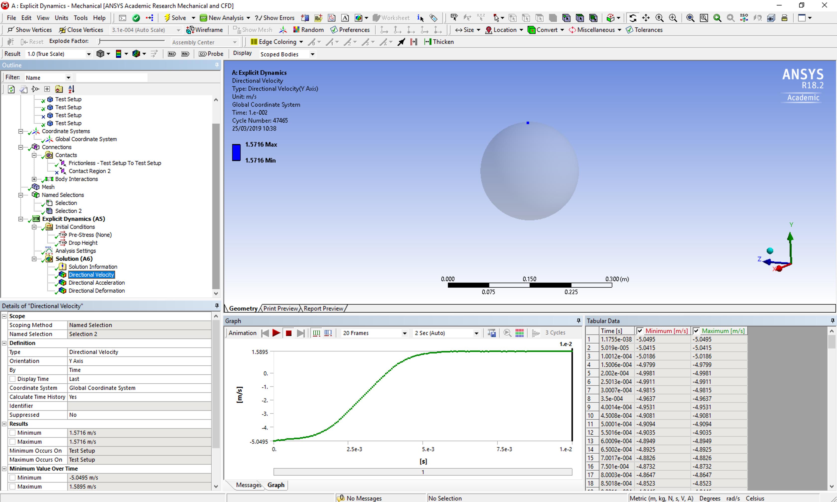

SubscriberHello Jack,
Plot a single node, for example, one near the top of the inner ball.
Plot the directional displacement of that node in the Y direction.
Plot the directional velocity of that node in the Y direction.
Plot the directional acceleration of that node in the Y direction.
I expect the displacement to begin at zero, go negative, then positive as the ball rebounds.
I expect the velocity to begin with a negative velocity, the impact velocity, and go toward zero then go positive as the ball rebounds.
If you see these things, then the simulation is doing what I expect and the directional acceleration plot would be accurate.
You should request a larger number of outputs than the default of 20, like 200 or more.

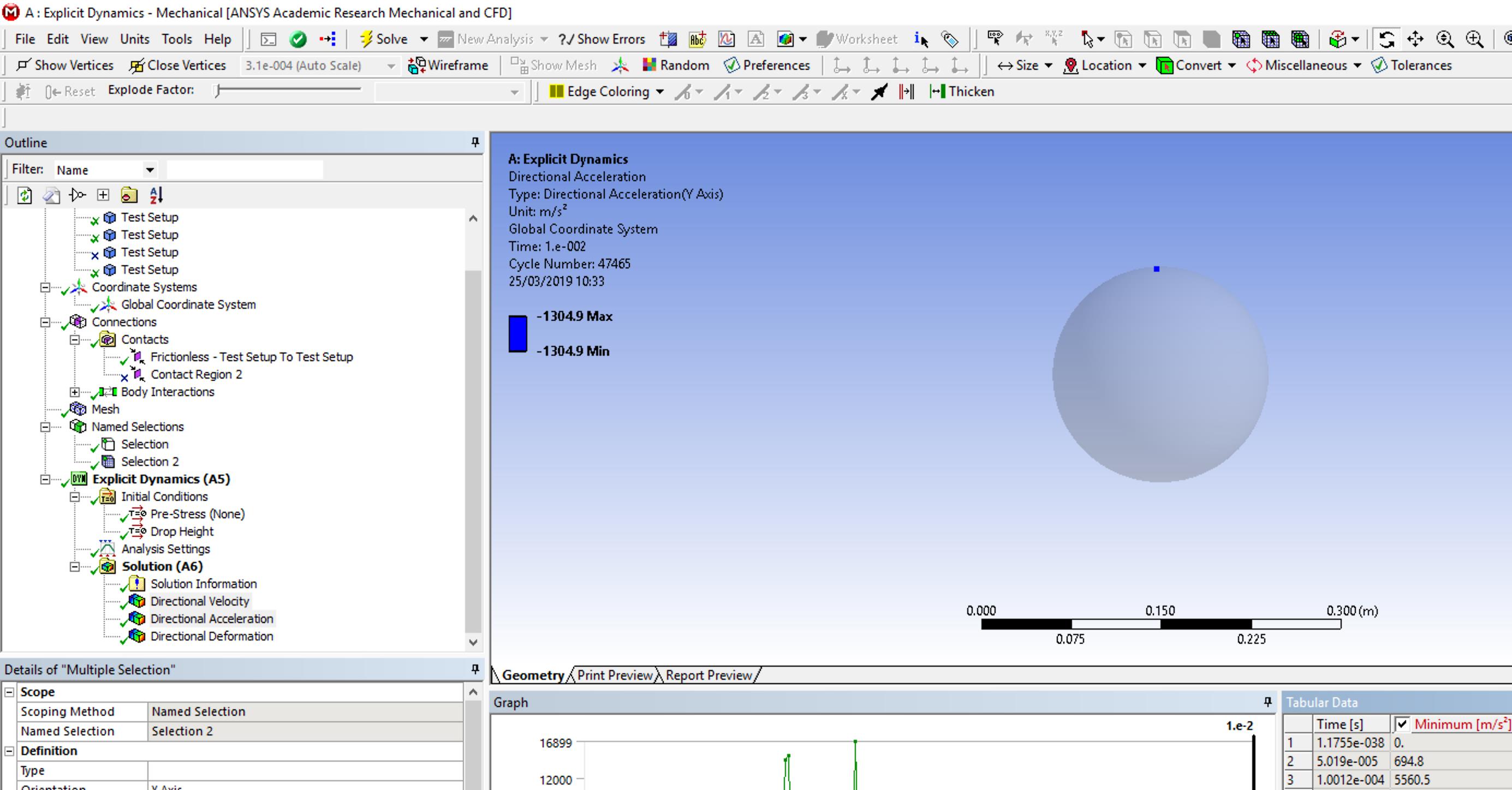

SubscriberExplicit Dynamics acceleration results are often noisy so you need to filter the data. One way to filter is to integrate, which is why the velocity and displacement data look smooth. If you smooth the velocity data and then differentiate it, you will get a smooth acceleration curve. I use matlab to do those operations. Do you have matlab? I can show you what it will look like if you want to attach the velocity data.
Click on the blank square at the top left corner of the Tabular Data for the Directional Velocity, all the data will highlight. Ctrl-C to copy to clipboard, then open Notepad and click Ctrl-V to paste the data into Notepad. Save the Notepad file as velocity.txt then use the Attach button on your post above to attach the file.

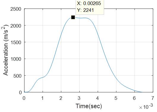

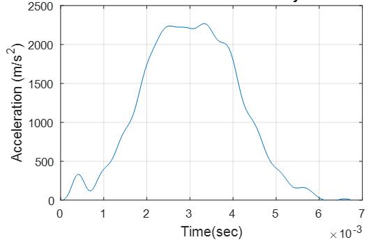

SubscriberAttached are the filtered velocity file that was differentiated to give the acceleration. I had to add 5 to the velocity so that the curve started at zero for the filter to work properly. I low pass filtered it at 1000 Hz. This caused an oscillation in the curve after 0.007s so that was discarded before the differentiation was done.
If you filter it at 2000 Hz, then more oscillation is represented.
If you filter at 5000 Hz, too much oscillation enters the result.
