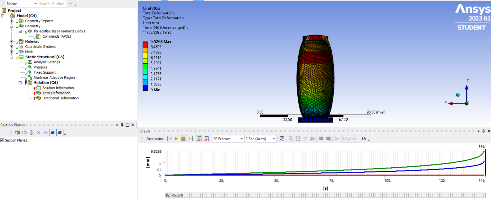

      Hi all,
      I am carrying out a hyperelastic simulation with Ecoflex-30 as a material (Yeoh 3rd degree model, with the following characteristics: C1 = 17 kPa, C2 =-0.2kPa , C3 = 2.3e-2 kPa).
      As shown in the following photo, I am carrying the simulation on a thick cylinder of internal radius ri = 8 mm and external radius rex = 10 mm. The total length of the cylinder is 58mm. One end of the cylinder is fixed while its interior is pressurized with air.
      The simulation is carried out with 100 steps (auto time stepping on. Initial, Minimum, and Maximum substeps all set to 100. Large deflections are activated. I set Keyopt(6) = 1 for the body as I have seen that it helps the solution to converge. The mesh is tetrahedral.
      No matter what I do the simulation always fails at the same point (at 58%). I tried increasing the number steps from 100 to 250, refining the mesh, activating/deactivating the nonlinear adaptive region, increasing the number of substeps, etc... but the solution always fails at the same point (58%).
      Before, the error stated that SOLID187 is experiencing high distortion but after some modifications the error only says that the solution can't converge at a substep of this step...
      Do you have any idea how can I fix this problem?
      Thanks in advance.
      Note: I have to use a yeoh model for the ecoflex-30

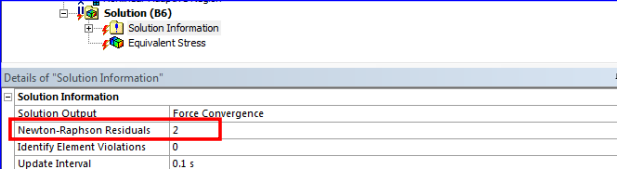

      Also, try to check the Newton-Raphson residuals and element distortion to check which location is having issues. After finding the problematic region, you can check for the issue and make changes accordingly.

      The key to understanding why this model consistently fails to converge at 58% of the pressure load is to observe the slope of the total deformation plot. Look at the last few converged points. The slope is getting steeper and steeper and is approaching a vertical asymptote.
      The solution logic applies increments of pressure and solves for the displacement (deformation) of the nodes that create static equilibrium between the internal stress and the applied load. In this model, looking at the slope of the total defromation plot, you should expect the next increment of pressure will require an infinite total deformation. In other words, the structure is approaching an instability where there is no static equilibrium solution for the next increment of pressure.  To resolve this problem, either turn on Stabilization under the Analysis settings or change the analysis to Transient Structural. In a transient solution, the structure is not required to be in static equilibrium at each time step, it can accelerate elements that are out of balance with the applied forces and internal stresses and find dynamic equilibrium at each time step.
      An example which is easy to understand is a hyperelastic dome. As the pressure is applied to the convex top side of the dome, it deforms downward, but at some point, it wants to snap through and the top side becomes concave. A Static Structural solution will fail to get the dome to the concave state without turning on Stablization or changing the analysis to Transient Structural.
