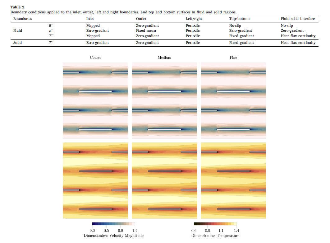

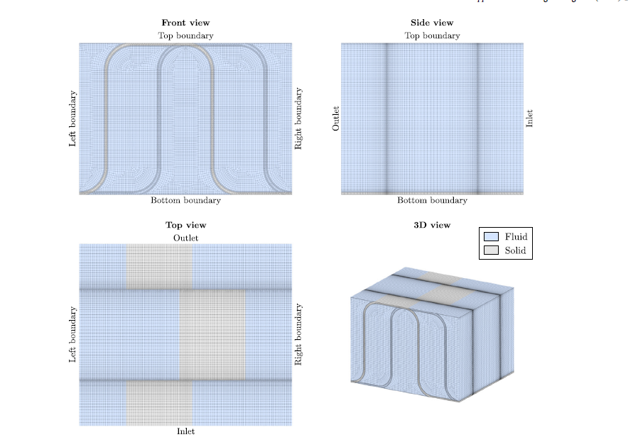

      The study I am working on, which I’ve referenced with the DOI number (https://doi.org/10.1016/j.applthermaleng.2024.124083), uses the exact same geometry as my own model.
      I have attached the visual representations of the geometry and the definitions of the boundary conditions as described in the paper. I would like to ask for your guidance on how to properly set up and build this model in Ansys.
      Thank you in advance for your help.

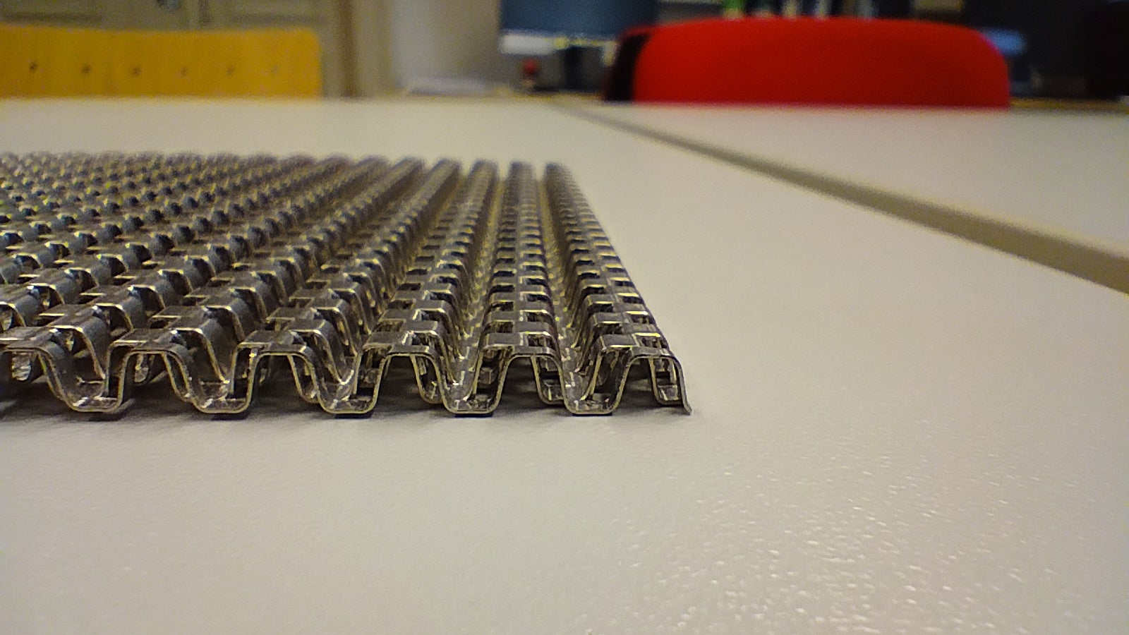

        Hey, I have something similar sitting here on my desk!!!
        I would recommend you look at: 16.4. Modeling Periodic Heat Transfer in the User's Guide. There used to be that cylindrical tube heat exchanger example in the customer portal, you may still be able to find it somewhere. But that was done before Workbench and I am not sure how that would change the setup process. I avoid Workbench when working with CFD models, prefering to run in standalone mode.

          I was glad to see the geometry I am working on in the photo you shared. I hope I can also figure out how to apply the boundary conditions I mentioned—specifically the 'mapped' boundary condition.
      Thanks Nick. We lost all of the bits and pieces we picked up from projects when we moved office. I suspect the strangest was a large lump of lawn mower: the grass doesn't finish up in the hopper by magic!
      Assuming the flow is aligned with one of the periodic repeats then you can use symmetry for the other repeat. You may just need to model more than one section, but it was always good practice to have 2-3 repeated sections in a model to check for edge effects.

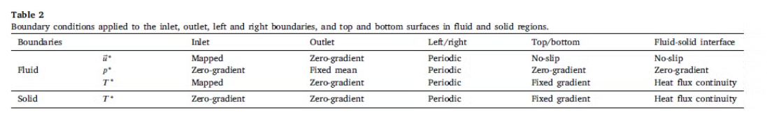

      For my master's thesis, I am working on an offset strip fin geometry. My goal is to increase the heat transfer surface area by adding a sinusoidal curve to the fins.
      Based on the reference article I am using (image attached), the left and right boundaries of the fluid domain are not geometrically symmetric. I am wondering: how accurate or physically correct is it to apply a "symmetry" boundary condition to surfaces that do not possess true symmetry?
      When I attempt to define an internal symmetry plane, I cannot achieve actual symmetry because the fin structures are staggered (shifted) at each step along the flow direction.
      In the attached article example, the author defined the left and right boundaries as "periodic" and the inlet and outlet as "mapped". However, I am not sure how to set up this specific boundary condition configuration in Ansys.
      Could anyone guide me on how to properly set this up? Any help or advice would be greatly appreciated. Thank you in advance!

        Do a google search for "Tutorial 2. Modeling Periodic Flow and Heat Transfer". It is an old 2D Fluent example, and you will have to create the mesh (not hard, it is 2D). It will help you understand the thought process of the problem.The mapped is the periodic front to back so the downstream velocity becomes the upstream.
        The 3D will be a little different in how you go about it, but the thought process is the same. Last night I was trying to remember back, and I think the best way I found for the second periodic boundary was using a Adjust UDF, but I cannot be certain. There was also a hack to get periodic in the second dimension, but I recall it being unreliable for extreme cases. The examples shown in the paper are steady laminar which will be easier to converge. Do you plan on moving onto unsteady laminar or even turbulent?
      That's the matched & non conformal perioidics mentioned above. It was never supposed to work but often did, so isn't recommended, and especially if any additional physics are used.
      As an aside, be careful to check the periodic section in both boundary conditions AND heat transfer sections of the User's Guide. I did write up a few Knowledge Materials for about 2020Rx but not sure if they're visible to Forum users.
