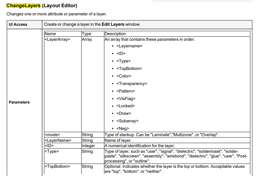

      Hi everybody.
      I'm currently tring to write a python script to change the properties of one (or more) layer in HFSS 3D layout.
      According to the documentation the function to use is ChangeLayer(). This function seems to work only if i give as a input the full stackup including the additional layers(symbols, posprocessing....and so on).
      For a 2 layer stackup means something like this:

      What i would like to do is set one properties of one layer. Something like this:

      However if i try this way the function gives a very general error.
      According to the documentation it should be possible to do this but i cannot succeed.
      What is the recommended way?

      Yes, the code pasted above is coming from a recorded script and it requires the full stackup as input, even if i just want to change properties of only one layer. According to the documentation seems possible (see picture below).
      Maybe i'm just misunderstanding the docs and the function only accept the fullstackup as input. In this case what would be the best way to use the ChangeLayers() function?

      Change layer function is not only to update the parameters of a single layer, but it can be used to update the properties of all the defined layers. It is equivalent to opening the Layer stackup. Hence, you need to add the details of the whole stackup for updating the single layer.
