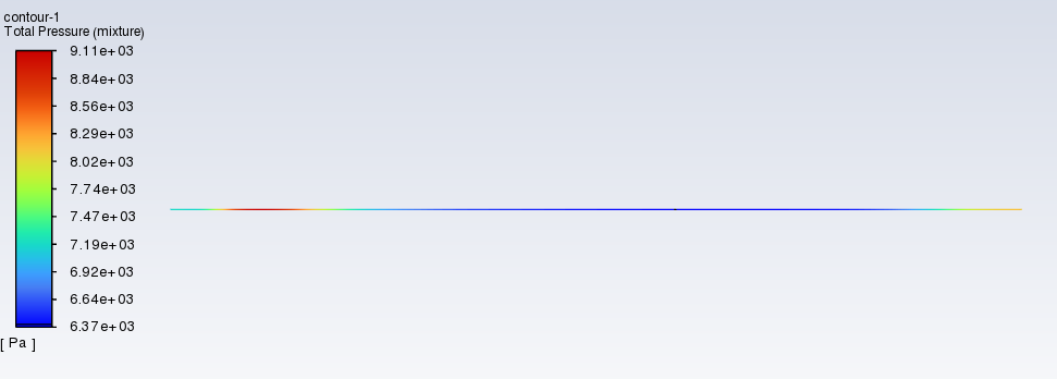

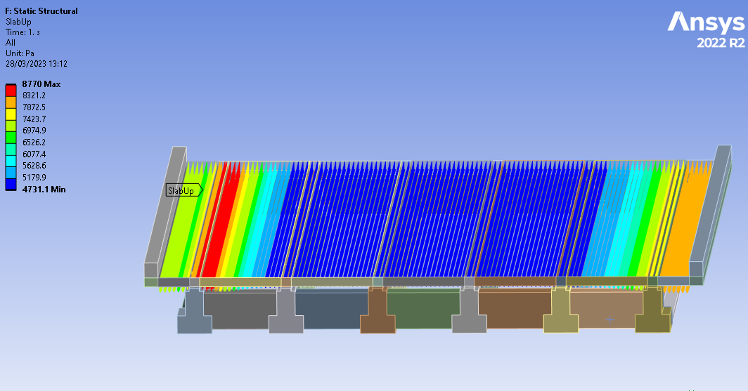

When I export CFD pressures from Fluent to Static Structural or Transient Structural only static pressures are imported (therefore no dynamic ones).
What can I do to import total pressures (dynamic and static).
In the first picture there's the imported pressures in Static Structural (which correspond to the static pressures obtained in fluent) whereas in the second, the total pressures obtained in CFD.

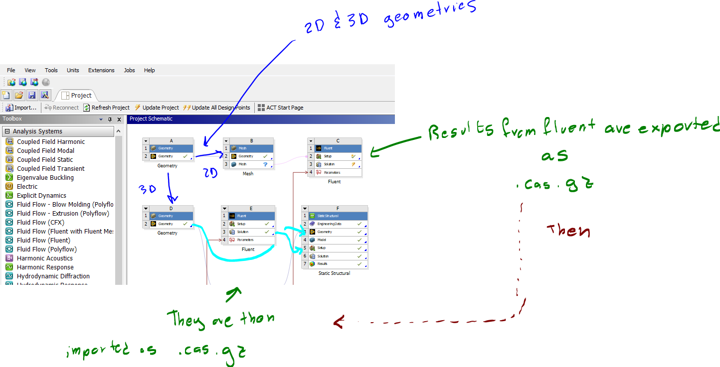

Could you please share the procedure of exporting the pressure from Fluent to Mechanical?
Is this a 1-way FSI problem?Â

SubscriberYes, it is a 1-way FSI problem.
The Fluent model is a 2D, 2-pressition, SSTKW, VOF (multiphase).
As pressures are not properly imported directly from Fluent to Static structural, first I have to save Fluent as .cas.gz and then import it in a different standalone. (See image).

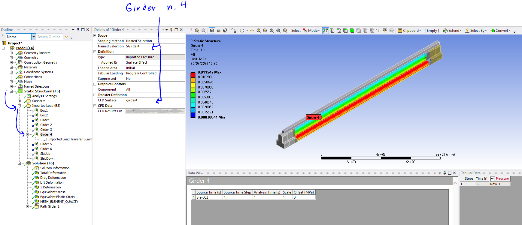

In Static Structural > Improted Load > Insert > Pressure I import the pressures from Fluent to Static structural. (In the image only pressures on the 4th girder of a bridge have been imported).
The problem is that only static pressures are imported, ignoring dynamic.Â

Yes, Only static pressure is imported and dynamic pressure is ignored. It is known issue.

SubscriberIf I use Mechanical base interpolation I get an error when importing presures whereas if I use CFD interpolation it works well.
Is there any way to import dynamic pressures too?
