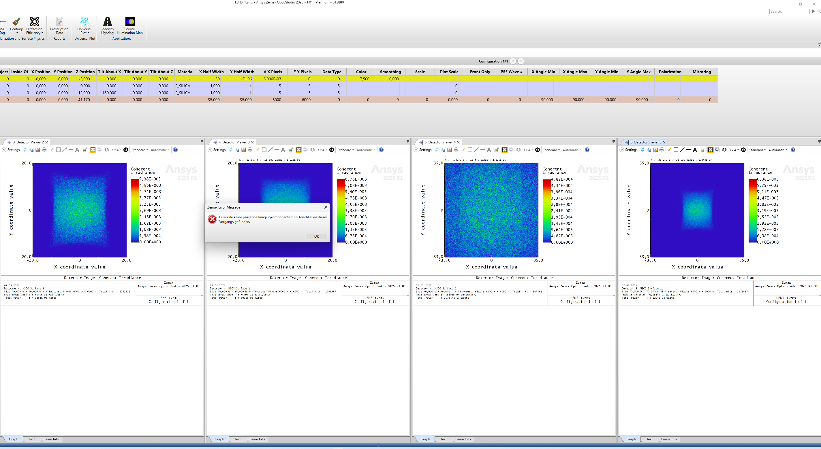

      Hello everybody,
      can anyone tell me what this error says and why it happen? I am trying to save my detector view then this error keeps popping up. thank you in advance for your help

      Dear arezoo.tahmasebi,
      thank you for contacting us. A bug report has been filed as this seems to affect 2025 r1 and r1 Sp1 (R1.01) on some systems.
      The issue has been resolved and the fix will be included in the next release.
      It affects saving to BMP, JPG and PNG from the following plots:
      • Huygens MTF Graph
      • Rays & Spot
      • PSF
      • MTF
      • Encircled Energy
      A workaround would be to enable the classic view and save it from there. As another workaround you can copy the plot to the clipboard and save into an image editing application, or revert to a 2024R2 or earlier release.
