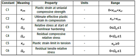

I have been trying to implement the Menetry-Wiilian material model with Exponential Softening behavior on Mechanical APDL. In order to implement this material model is necessary to define seven constants, that I am going to explicit here:

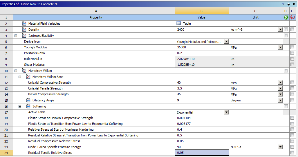

SubscribernI hope you are well. I am using the newer versions of ANSYS and I have found the options to input the values in engineering data. nThe following are the values I have inputted for Non-Linear Concrete. n

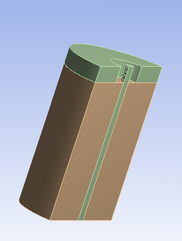

However, when I try to run the program, I keep getting error about how an element is failing. I am modelling the following pull-out test and using symmetry to only analyse half of it:

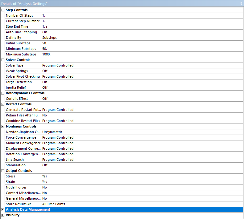

I have also used contact sizing and therefore the mesh for concrete near the rebar as well as the rebar has been set to 1mm (This is the smallest I could go for a 150mm diameter concrete cylinder with a height of 170mm on the Academic Version of Ansys). nI have applied the following analysis settings, boundary conditions and loading (force is corresponding to the yield strength of the bar i.e. 541MPa but only half of the load is applied due to symmetry): n
nI currently haven't defined a bilinear hardening model for steel as I was having errors running it when I defined it. But since I am only applying the load until yield strength, wouldn't specifying the yield strength be sufficient because it is still linear? nI am also giving link to the model if anyone is kind enough to look through any errors.https://unsw-my.sharepoint.com/:u:/g/personal/z5117866_ad_unsw_edu_au/EbxuvuDD7nBNl0403Sd8AtUBx4S1D9tSU63vP2W9WiJn3g?e=9vZgWDnThank you so much! n
