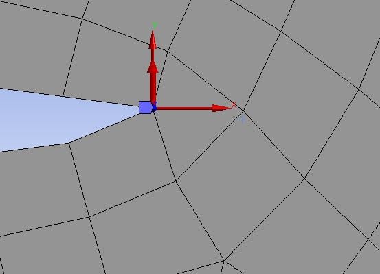

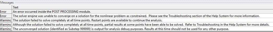

SubscribernOh. A misread, sorry. Now the element size is 0.07mm. I created a named selection on the node as shown in the figure. I add the pre-crack on the named selection. However, the solution seems to not converge and gives me the following errors: nWhat could be the reason, or how I could fix it?.
Figure 1. Node pre crackn

December 15, 2020 at 12:28 ampeteroznewman
SubscriberArraynLook at the posts in the Google search of this site for the term unable to converge. There are many standard methods to resolve this situation.nhttps://www.google.com/search?q=site%3Aforum.ansys.com+%22unable+to+converge%22nViewing 7 reply threads- The topic ‘Elastic Perfectly Plastic – Plastic Zone Size and Shape – 2D Modified Single Edge Notched Tension’ is closed to new replies.
