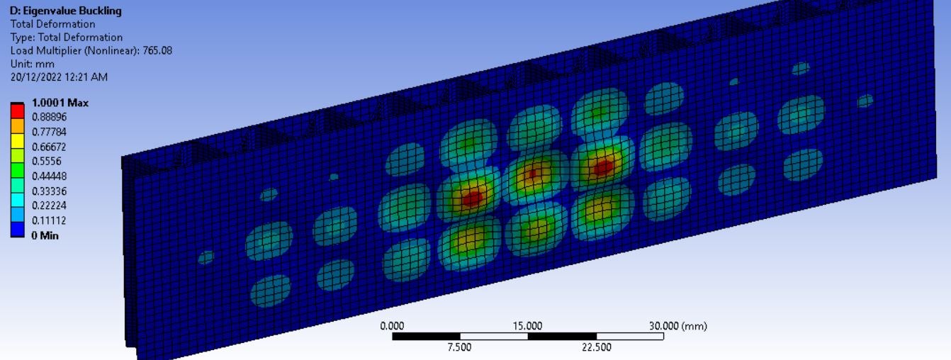

        My model is a 3-layered sandwich structure of orthotropic material. I have defined element orientation to address the orthotropic properties (using shell elements). I’m using 1% of the first buckling mode of perfect geometry as the initial imperfection for the post-buckling analysis (image below is the full scale imperfection).

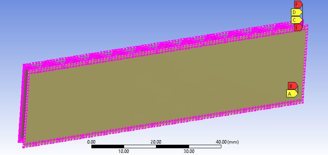

        Here is my BCs for post-buckling analysis:
        All BCs are direct FE conditions.
        Top: Displacement control push down. Rotation fixed.
        Bottom: Displacement and rotation fixed.
        Sides: Displacement fixed in 2 direction, free in vertical direction. Rotation fixed.

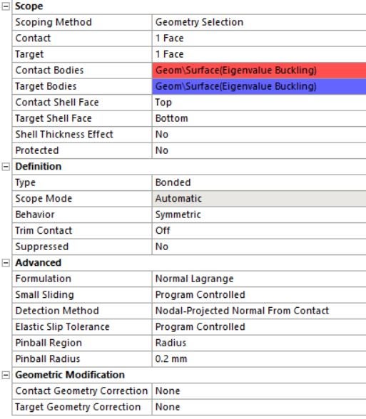

        I have two symmetric bonded contacts between layers:

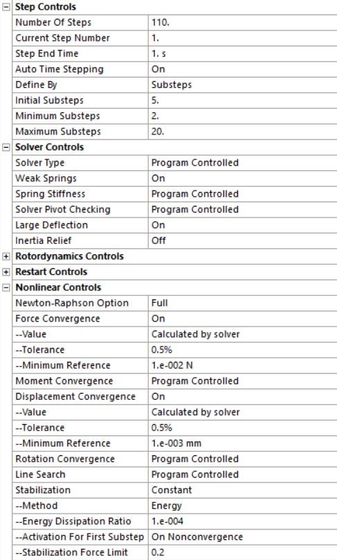

        Here is my current analysis settings:
        The idea is to kill elements with damage status of 1 and shed the load onto adjacent elements. I then have a visual failure criteria to define total structur failure. But I get the element distortion error, I think, at the buckling load (as the load vs displacement flattens out at the timestep I get the error). At this point I only have a few elements with damage status of 1.

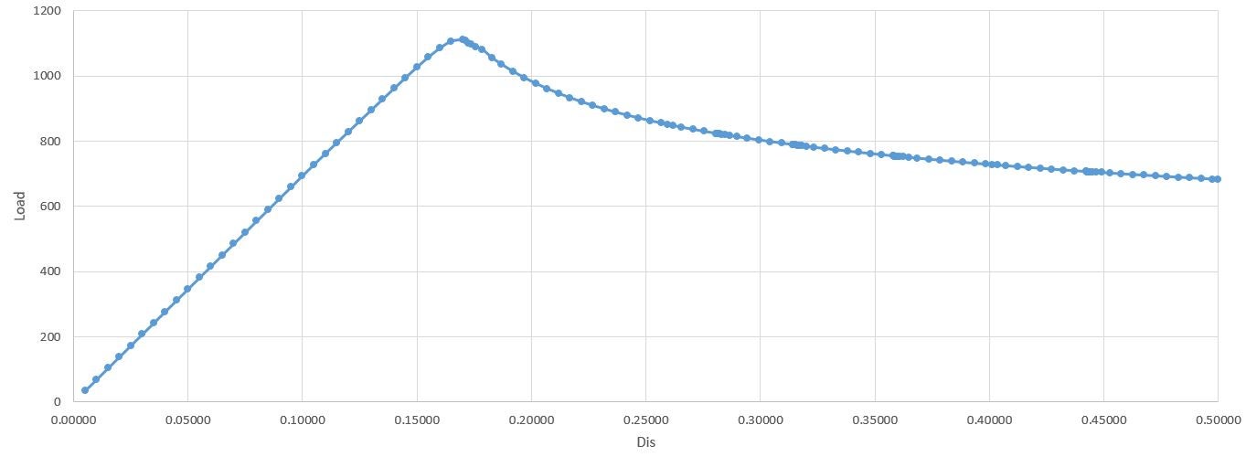

        I tried applying kinematic hardening. My material is ortothropic, but I know the failure direction. So I use the compressive stress limit in that direction as the yield strength with 0 tangant modulus for bilinear kinematic hardening (as my case is monotonic loading, documentation says both isotropic and kinematic modes are the same). My solution now goes post-buckling (without exessive distortion) and load-displacement curve looks like this after 0.5mm total displacement:

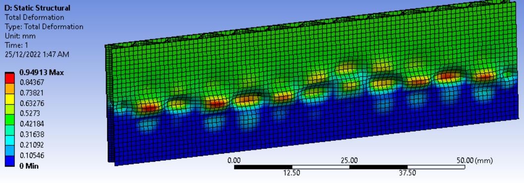

        Total deformation also looks as should:
        But, the failure that I defined (Hashin progressive model) has a value of zero all along, for both ‘damage status’ and ‘maximum failure criteria’. The elements should start failing at the onset of the maximum deformation in above figure. I think it does not even calculate the damage parameters.
        Do you know if damage contradicts hardening? If not, can you suggest why I don’t get any values for damage?
