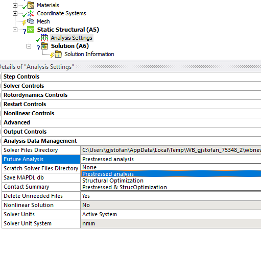

    • Gary_S
      I'm not sure if you are using Workbench Mechancial linked analysis.
      It seems the restart files for the subsequent analysis were not created.
      If so, a possible issue may be the Futuue Analysis field was not set initially.
