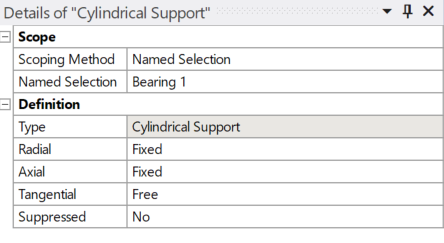

SubscriberI am doing a modal analysis of a motor rotor assembly where upon increasing my mesh size, the first mode (rotation along axial) is fluctuating and not converging. How to find a good mesh for this?

Ansys EmployeeIs axial rotation constrained? Sometimes a rigid body mode produces a non-zero contact due to penalty based contact. If mode 1 is actually a rigid body mode (no constraint of axial rotation) try switching to MPC based contact to reduce the artificial rotational constraint of penalty based contact.

SubscriberAxial rotation is kept free as I have used a Cylindrical support at bearing support face with tangential as free.
As you said Mode 1 might be rigid body mode. Could you give me some more idea on "switching to MPC based contact to reduce the artificial rotational constraint of penalty based contact"? Does MPC based contact completely remove the first mode with axial rotation ?
