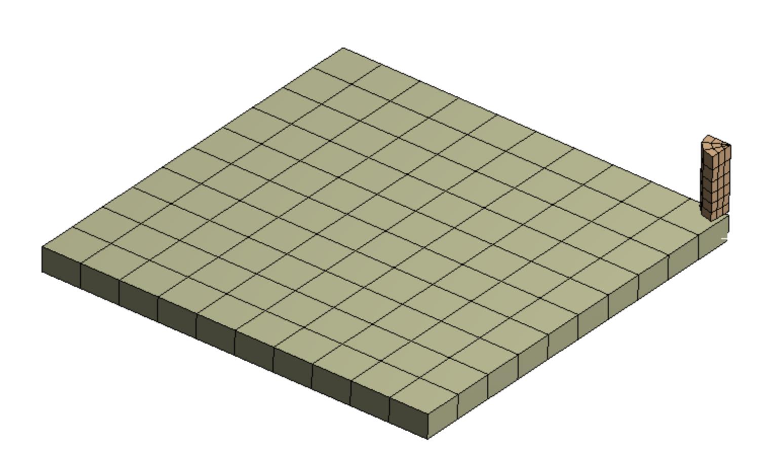

      I am doing an impact shock analysis on a plate using Explicit Dynamics. I want to generate SRS in MATLAB from the acceleration-time history of a node. My sampling rate is about 1e-6. I read in a different post (link) that "Explicit Dynamics acceleration results are often noisy so you need to filter the data". However, I'm not sure if the solution suggested is the correct one for my application.
      As you can see I'm using symmetry and I am using velocity initial condition on the impactor, which is placed close to the plate, but not touching. I am using remote displacement to constrain Ux, Uy, Uz of the corners of the plate. (The mesh is coarse for short solving time).
      I have the vibrationdata GUI by Tom Irvine. I have tried to use the Butterworth filter, and it does change the SRS slightly. I only have basic knowledge of filtering. How does my output acceleration data look? If some sort of data processing is necessary, what would you recommend?

      Vebjorn,
      To plot an acceleration from Explicit Dynamics, as was desired in the discussion you linked to, then you need to filter the data.
      Creating an SRS is a filter operation. You decide on the upper and lower frequency limits to plot the data. That is a filter too.
      I would not use results from this coarse mesh. The wait time in Explicit Dynamics is mostly driven by the smallest element in the model and less with the node count. With sufficient RAM, there is little incremental wait time by making the plate have elements that are closer in size to the elements in the impactor. You want at least 4 elements through the thickness of the plate and let them have an aspect ratio no more than 2 so if the thickness of the plate is t, then the element thickness is t/4 while the element side length is t/2. It is ideal if the elements are cubic with all sides equal.
      The mesh on the impactor has small elements on the axis.  Remesh the impactor to have one element on the axis that is similar in size to the elements around the circumference. This will reduce your wait time more than using fewer coarse elements on the plate.

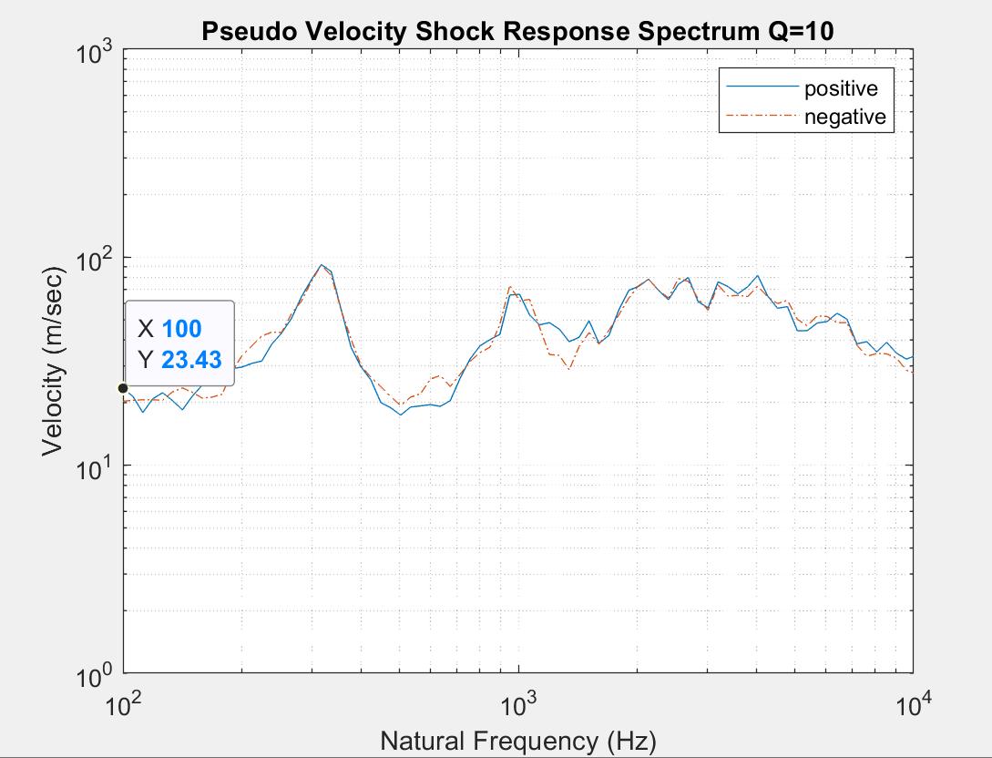

      I have been trying to look into this a bit, because I was not using 50 m/s as my initial velocity anymore. I reduced the velocity from my initial shock because I wanted to reduce the amount of energy in the shock. It was actually 27 m/s here. It would have been really cool if you observation was the case, but now it seems like it was a coincidence unfortunately.
      Does that mean there might be something in my model? The impactor is not initially in contact with the plate and the measurement location is away from the impact location. After spending some time thinking about it, I would have though the velocity away from the impact point should be different to the initial velocity of the impactor.
      Here is the pseudo velocity SRS measured at the central node (impact point):
      The maximum velocity is 92 m/s and the minimum is 17.4 m/s. I've highlighted the low order velocity, which is similar to the impact velocity. I'm not sure if there is a connection though?

      Hello Vebjorn,
      I am attaching a paper on plotting SRS on four coordinate paper.  If a shock has no rebound, then the impact velocity appears as the plateau of the Pseudo Velocity plot, but if there is rebound, then a higher value of PV occurs. Since you were having problems with multiple impacts, you must have a significant amount of rebound.
      The paper explains in some detail about the low frequency slope, the plateau and the high frequency slope. I hope you find it helpful.  Table 1 in the paper lists Severe velocities. 27 m/s is 1063 ips and that is larger than anything in Table 1. Maybe you should cut that in half again.
