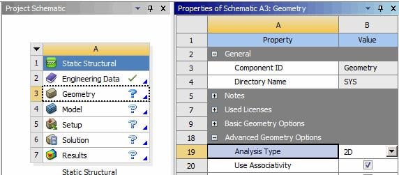

      In Workbench, drag out a Static Structural model. Click on the Geometry cell and in the Properties set the Analysis Type to 2D.

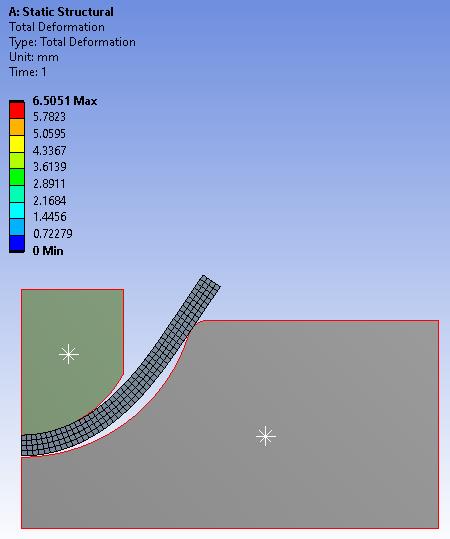

      Create two Frictional Contacts. Create a Displacement of Y=-6.5 on the top of the Punch and a Displacement of Y=0 on the bottom of the DIe.
      Set a Face Mesh Sizing on the workpiece of 0.25 mm element size, and set Edge Mesh sizing on the contacting edges to 0.25 mm.
      Under Analysis Settings, turn on Auto Time Stepping and set the Initial and Minimum Substeps to 100, the Maximum Substeps to 1000. Set Large Deflection to On. Solve.
      Note that this solution used Linear Elastic Materials, so if I add Step 2 and retract the punch to the original displacement, the workpiece would return to a straight flat piece.  The next phase of this analysis is to add Plasticity to the material model.  You can ask for help with that after you show that you have got this far.
