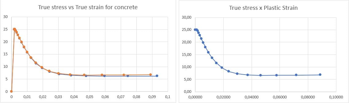

      Hello, members.

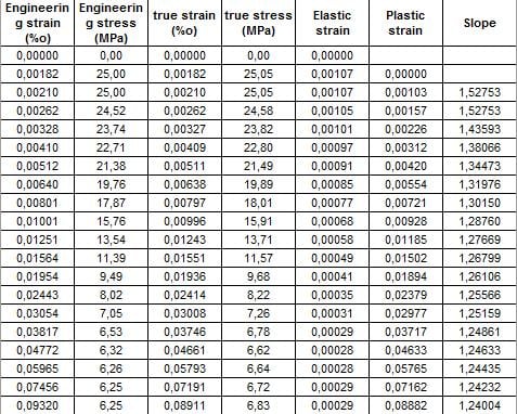

      I would like to use the constitutive model for concrete by Tao (2013), that have a descending part after the maximum stress on stressxstrain relationship. I am attaching one picture here. I would like  to formulate this relationship in order to represent the residual stress offer by the confinement effect.
      However, the software has been returning this error: "TB,MISO table for material 2 at temperature 0 has a tangent slope value less than zero". I am also attaching the textfile here.
      I wonder if any member may help me to solve this problem.
      Regards, Andrey

      My first point in the material on Ansys is the yield stress of concrete with corresponding plastic strain equal to zero.
      The descending curve represent the residual stress of concrete in confinement, by Tao (2013) "Finite element modelling of concrete-filled steel stub columns under axial compression". I am modeling a circular concrete filled steel tube.
      Regards, Andrey
